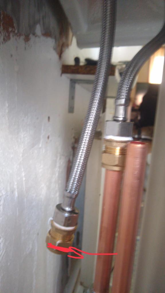

Switched off boiler + water. Somehow almost broke my bum trying to undo the old sink and drilled holes for the new one... I looked at the tap and I was like... ? I'm not used to this connection. Any ideas before I have a breakdown? Thanks :(
Your new tap has half inch connections you’re existing pipes finish in 3/8” swap them for two of these

wrong fittings on the bottom need couplings and not male irons
But I did what everyone said. On the first page told to buy 2 of those adapters... Now people are saying no???? I don't want to go without water again today cos Screwfix are now shut :(
