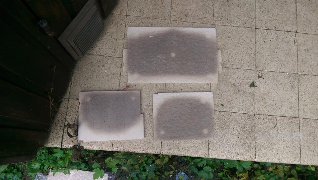

Yes that's perfectly normal madam.seen the same on baxi 105s when you swap the cracked insulation panels, only started recently so I suspect they have changed the makeup of the new panels, just leave them to cook a while and the analizer readings settle down,
Does seem the makeup has changed for whatever reason.seen the same on baxi 105s when you swap the cracked insulation panels, only started recently so I suspect they have changed the makeup of the new panels, just leave them to cook a while and the analizer readings settle down,
Or a fire. Not taking the ****. It just seems ironic that they get you there to fix/ service it and then you end up explaining away why it smells like it's burning.well if smoke is pouring out of the casing, wouldnt you suspect a fluing issue?
