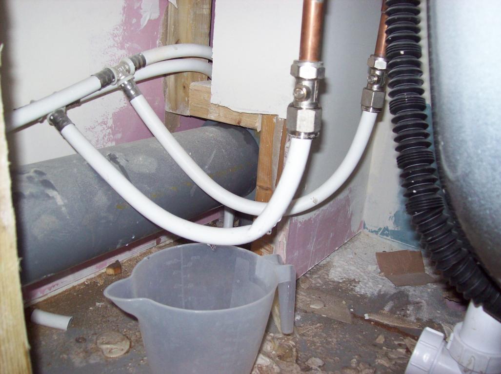

100_2534.jpgDrippy pipe.jpg100_2497.jpg100_2537.jpg100_2524.jpgHi I have a bit of a contd saga and I am very appreciative of the help I have been offered on this forum. I live in a new build 2 1/2 years old plumbing across the estate has been a disaster. Builder had to re-plumb the first house sold on the estate because there was a leak that his new plumber (old plumber left the job in the middle of the build because he hadn't been paid he cut radiators off walls etc), said he couldn't find therefore it was "cheaper and easier to re-plumb" !! As we all have the same plumbing / heating this is, to say the least, somewhat worrying especially when we have all had endless plumbing /heating problems. Anyway my question is, I have been told that the system was never pressure tested before it was hooked up to the supply and the ceilings and floors were already finished !! When the system (that is across the estate) was hooked up it leaked like a sieve. Having pushed the NHBC hard they have agreed to come in and pressure test the central heating (not the plumbing as a whole). They have told the builder to fix leaks in radiators and then get a 'specialist' in to pressure test the heating system. My questions are:

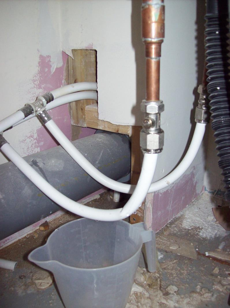

(Re picture of the dripping pipe under the bath. This was the 3rd leak we have had in this bathroom (leaks in others too), this pipe dripped 2 1/2 litres of water a day for weeks and then just stopped. Any ideas why that would have happened. Clearly plumbing not right but why would it leak for weeks and then stop? And another Q I was going to ask. Shortly after D&G engineer had been boiler started to leak water all over the kitchen side. Boiler leaked for about a week then presumably it was empty. (We have not had hot water or heating since January ). Could the boiler have been damaged / rusted just sitting there all this time? Thanks)
That sounds like it Defo needs a re plumb!

sounds like a right mess. and from the pics looks like a right mess!

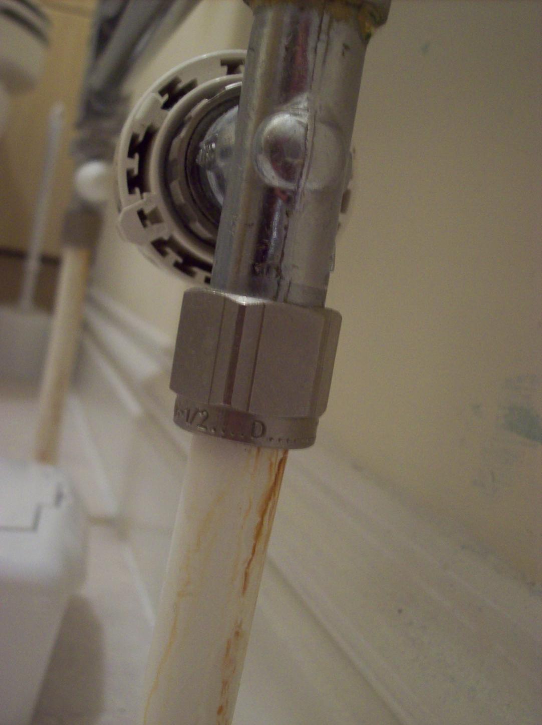

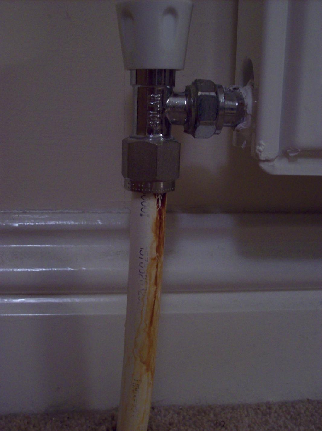

the swarf and sludge in your system indicates that the pipework carcass was not flushed after installation it will be pipe burrs and flux and quite possibly plaster if pipe ends were left open.
isolation valves on the radiator tails is not good, neither is the placcy pipe bent to the point where it is kinked.
as for the pipe it is not one i have even heard of. unfortunately you will need a re-plumb however the good news is that as one house has been done it kind of indicates liability on the part of the builders for crappy plumbing. added to the fact that any plumber who knows his stuff will be able to provide a testimonial to the problems being the result of bad practices, naff products and a fundamental flouting of manufacturers instructions regarding pipework flushing prior to boiler install and commissioning. your boiler warranty will be voided by this! but again you have grounds for a claim based on the fact that standard industry procedures weren't followed.

Drfinitely complete replumb. The quality of the work is absolutely appalling. Judging by the red stain there is serious corrosion to the system anyway.
That looks like Uponor pipe,but you say it's Ginde,I don't know that make. If that has been used for the pipework carcass with crimped fittings then it should be fine.It's a very reliable system,much better than push fit.The leaks you have are coming from the compression nut adaptors where the plastic changes to copper,the leaks under the bath are because the inserts are being pulled at an angle,if the pipe was installed straight then it wouldn't have leaked.
It's untidy,no doubt about that, and it needs doing properly. You could lift the floor below the radiators and crimp new fittings to enable the rads to be piped up neatly.I've used loads of Uponor and am a big fan. A pressure test is a good idea though,there's nothing specialist about it,any plumber should be able to do that.

looking at the pics id say the system was installed by a right donkey. Personally i would insist on a full repipe. When i worked on new build we would always pressure test and require the builder to witness the test and a signed certificate would be issued with the plumber and builders details much like a gas certificate.

Must have been a right numpty uponor is pretty much fail safe..im guessing its a joint not crimped/pushed in to the viewing window; as if in a tight spot the rubber can still hold a decent pressure.
That rad nut must be finger tight to be leaking haha. Deff replumb. I cant believe buildings can be signed off in this state. :/

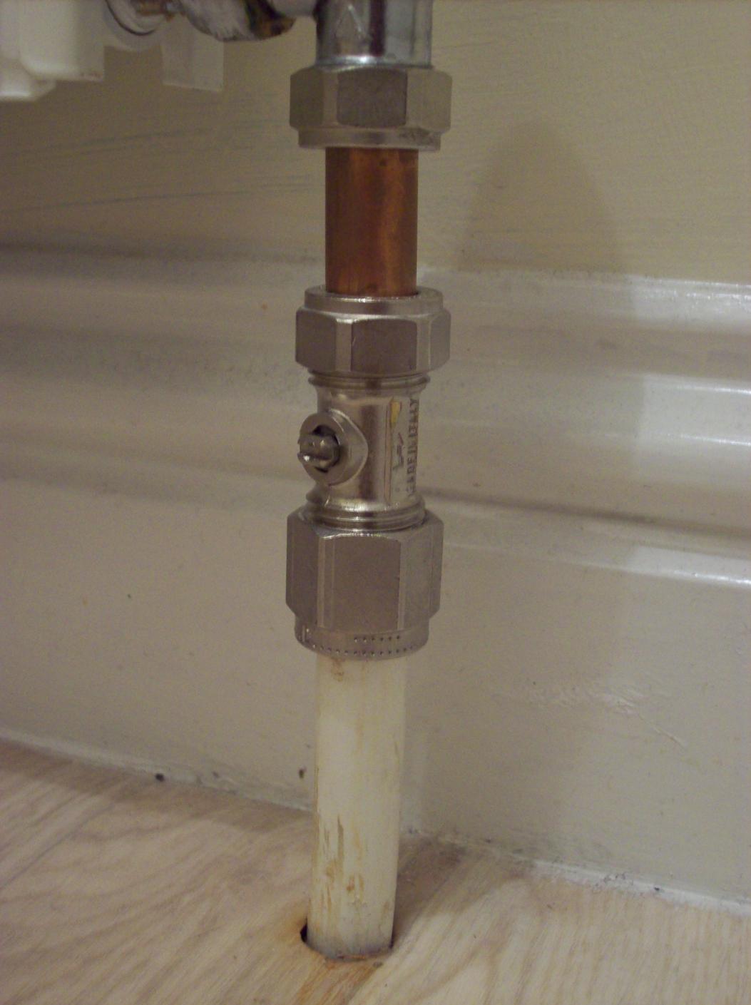

I am going to try to attach photos of the pipework and ask if there is another way?
Coming up from the floor is the Ginde pert-al-pert and then as you can see a bit of copper etc has been fitted to try to stop leaking. I can't get my plumbing / heating insured because it clearly never met Regulations...but if I don't accept what the NHBC are offering what can I do because a court of law would want me to show that I have tried to mitigate losses...once I accept what the NHBC have offered I would not have a case as I accepted the NHBC's resolution. Catch 22

if thats a standard isolation valve it is not designed to be fitted on central heating because its not designed to take the temp. Its designed for hot and cold at 65*c.
either way its not correct and i would not except having a iso valve on evey rad pipe.
That's it standard as the pipework looks like multilayered pipe is not standard size
Does this pipe work go back to a manifold the pipe looks 16mm pipe I think as the nuts on iso different?
The MPC pipe as Gray said is 16mm and the copper is 15mm. The big nut is part of a 15-16mm adaptor which has to be used to connect to a 15mm compression fitting.
The iso valves are not really suitable for heating and they will probably leak sometime in the future.
You don't have a lot of options on how to join the pipe to the rad neatly without lifting floors and hiding the joint. If that can't be easily done you can either get the iso valves swapped for compression unions and paint it or use a crimped fitting and a bit MLC and the compression adaptor on the valve.
Either way ain't going to look too great but if that is what it takes you may have little option other than to accept it.
