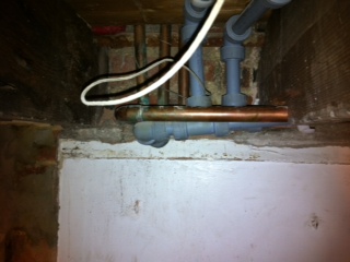

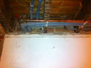

Hi forum
I had a new boiler put in and some pipes were put into the kitchen ceiling. I'm now in disagreement with the plumber as to whether the elbows of the plastic pipes are hanging too low. We are to plaster the ceiling but 3 separate plasterers have said its a poor job and they'll have to lower the ceiling.
Is there anyone there that can give me an objective opinion on these elbows?

crap work and no way will a ceiling go flat against that,cant that plumber solder?plastic pipe and fittings disaster waiting to happen
Thanks for the replies. There was a ceiling when they he did the work. Laths and plaster. After the work was done I took the rest of the ceiling down. He says that the elbows were left so they'd fit if the ceiling was overboarded and that now "all" I need done is for the ceiling to be lowered.
get him back to correct it to your satisfaction i.e done in copper

The checks are on the limit for the joist size. Strap the ceiling down with 2 x 1" sheet it and forget it.

A plasterer just needs to screw a few battens to the bottom of the joists and board over, don't be notching joists on the bottom.
is it my eyes or have they notched the bottom of the joists ?if they have board it over quick before anyone sees it a good ds will have all the joists changed
I don't understand how the plumber has notched the joists, clipped the pipes from underneath and even screwed a wrap over to the underside of the floorboards while the kitchen ceiling was still up. Something not right about this thread.

But as said it is to low for ceiling to be reinstated your installer should of drilled joints and fed it through so yes they should fix it or it will cost you a lot more to lower ceiling

The plumber removeda small portion of the ceiling to get the pipes in. I've had some plasterers in to quote for redoing the ceiling plus other work. While in they all commented on the elbows. As did the builders who were in to bring the kitchen wall down.
I was looking to this forum to help me make a decision as to whether to stop complaining and just accept what it is whilst paying a bit more for the ceiling to be lowered before plastering or to push back and insist the elbow is either moved up (something he has said will cost me half a days labour) or replace entirely with copper.

Unless you had a conversion with your plumber as to what was going to happen to the ceiling i.e. was going to be pulled down & redone complete, then he could reasonable have carried out his work under the apprehension that the ceiling was going to be repaired by over-boarding it which is a common technique, so as long as the elbows would have been hidden by this then IMHO it is down to you.
Over boarding still would not of covered them elbows imho

From the pictures, why will it be massively expensive to run battens across the joists with 2x 1 ?

When the original ceiling was there I'd say there was nothing wrong with this job. It's plastic but plastic is used every day without problems. I prefer copper and a lot of plumbers do, but plastic does the job and sometimes it can be the least disruptive material to use, especially where access is tight as it seems to have been here.
