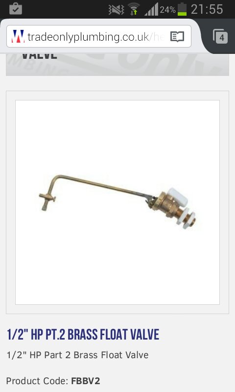

went to a well brand new school (2 years old approx) everything ok heating and meter wise etc, the last thing we have to check is toilets, undo the the concealed panels takes the lid off the cistern, water board guy takes a look for wasting water etc (jobs-worth ) and see a brass ball valve (part 1) extended arm (which i love brass ball valves because theres less wear and easy to change parts but thats going off point ) and hes says thats illegal so i take a look and theres a dcv on the incoming main just after the iso and hes still said its illegal as water can still back flow.
now before i challenge him i want to make sure im right and dont want to charge the local a shed load to change every valve in the school if i am
summary can you use a part 1 with a dcv and be water regs ok etc
if no what ball valve can i fit needs to have an extended arm (float arm) and would like it brass if pos, because he also said you cant use one of these with the plastic silence tube on as that one can back flow (part 3)
