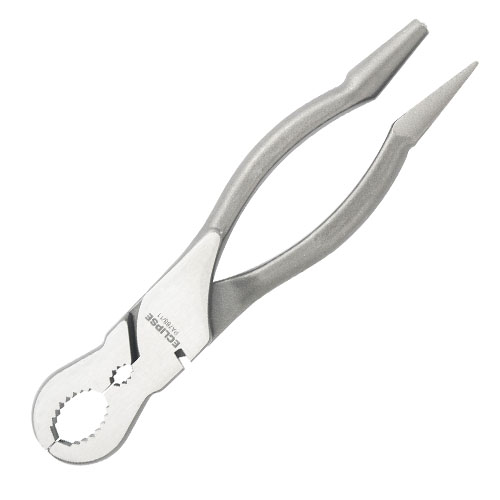

I've always used gas pliers to strip the paint off. And powerflux is the daddy of fluxes.
