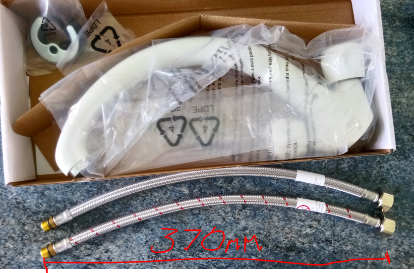

We have a white mixer tap (20yrs old now) it needs replacing and I bought a very similar one yesterday.. it came with the flexible hoses as you'd expect but most don't seem to like.. anyway looking at it I couldn't see how it was piped in the first place. .all soldered up but 'in place' and screwed in and tightened up.

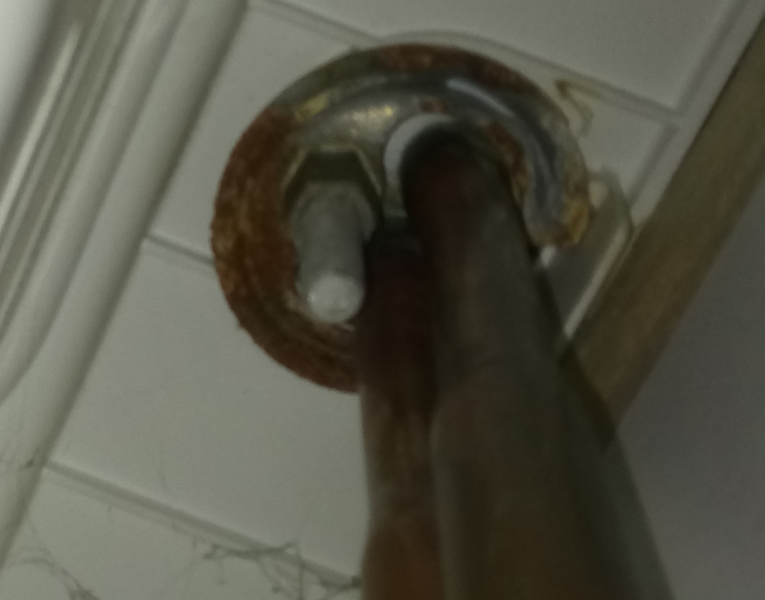

the two copper pipes on left go right up to the threaded monobloc
I could not see how to detach this as even cutting the pipes, you would have a job unscrewing the pipes out of the tap block underneath!!!! Then I also thought I can't even fit compression joints (my preference) as the pipes are too close together anyway.... Hence I thought of coming here and asking how the magician did it. (these are the problems newbies face.. no experience)
Anyway.. laying awake most of the night thinking about this.. Am I right in thinking that it was measured up, then the pipes fitted into the monobloc unit then put through the sink top and slid into the two soldered joints (halfway up the photo) in the first photo and then the retaining bolt fitted and then soldered up?
Same way to get it out? undo the bolt and heat the joints and pull it up?

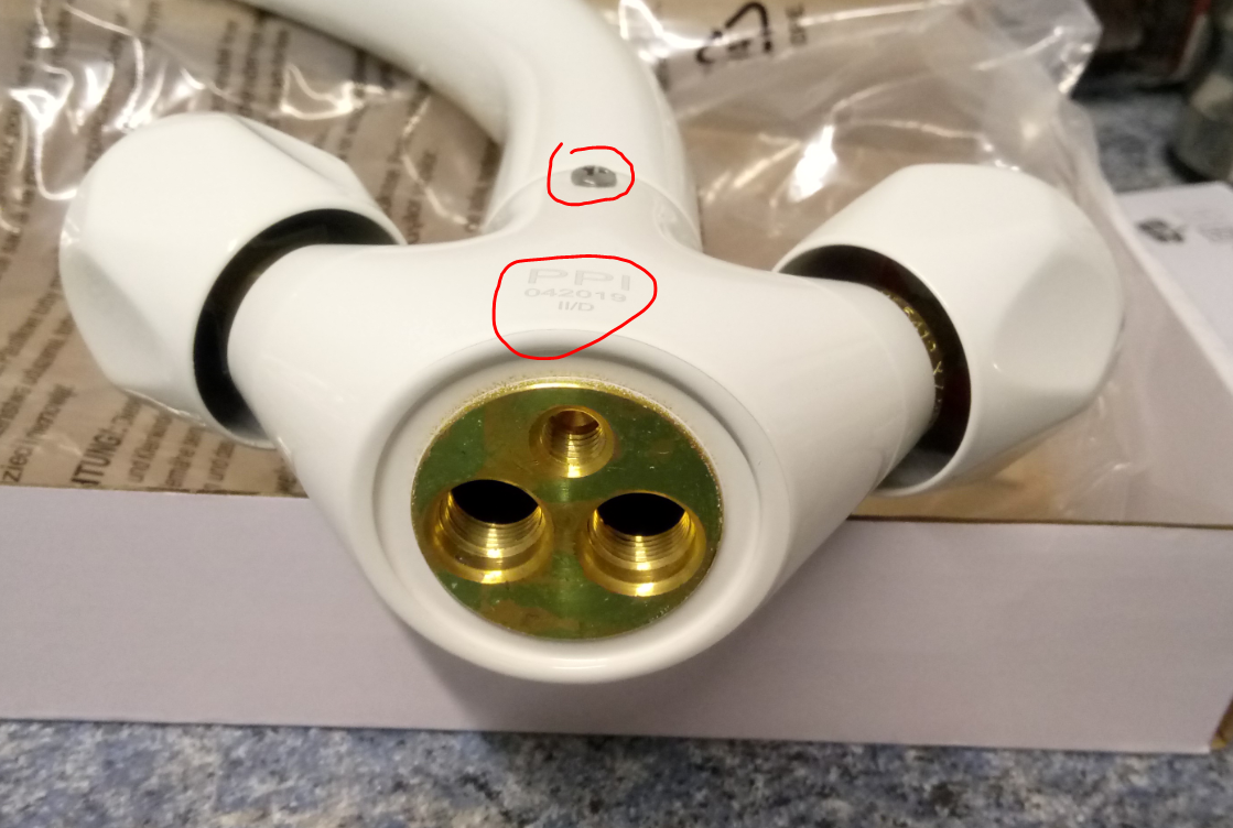

The other question.. bear with me please.. is the new fitting. If I fit it the same way with the bolt away from the wall I am actually using it backwards with the screw and label showing..
I can change the tap tops around so the hot and cold colours correct. What do you think.. if I put it the other way with the bolt at the back wall I'm guessing the pipes are going to be 5-7 mm off centre from where they fall right now (bolt currently at the front).. is there enough tolerance/movement over the pipe length to force it slightly forward.. or a bad idea?

Cut pipe tails with junior hacksaw or whatever and remove mixer by first taking small nut off bolt underneath tap.
You might find the pipes have some movement to enable you to use pipe slice now.
Then cut the pipes below the soldered connectors, leaving the left hand one approx 50mm longer. You can then use a brass connector on left pipe and a brass compression elbow on right hand pipe to work from. (You can then fit pipe using a soldered elbow to put pipe vertical again up to new mixer flexi)

No need to. Just cut the pipe tails to the tap, remove tap, cut pipes below sink to suitable heights and/or cut a piece out of horizontal pipes to get vertical pipes further apart.
Use compression valves or fittings onto pipes that are within cupboard. (You can bench solder any pipes to be added if you wish).
Nothing wrong with compression joints below sink if easier to use.
The person that installed the tap using soldered connectors directly to the copper tails has actually done a worse job than compression would have been

The old copper tails are scrap copper, so cut them above the soldered connectors and remove the tap.
Then you can think of unsoldering each connector individually if you really want to, but I have no idea why you feel you need to do that.
Just cut pipes finally below the soldered connectors.
To try to unsolder the 2 fittings and pull the old tap up at same time is not a wise idea trust me.
