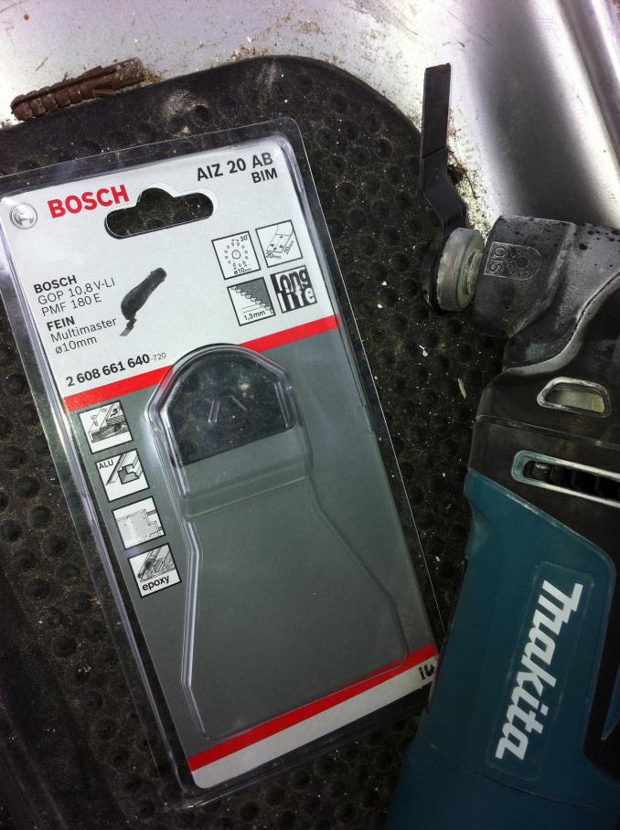

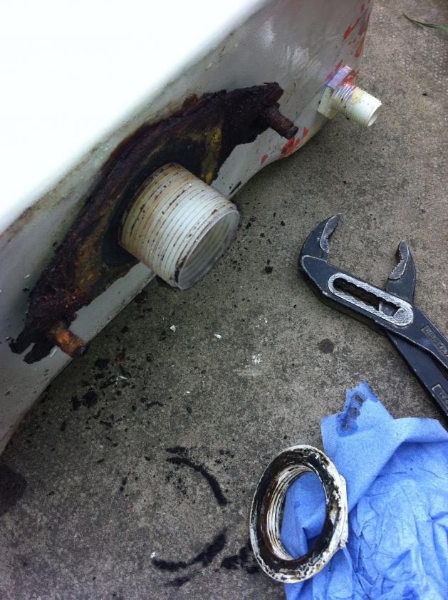

Last job of the day and it was the dreaded syphon change with very rusty cistern bolts. Tiny downstairs bathroom and no room whatsoever. One of my worst jobs to take on normally. But i thought id try out the new Makita Multi tool for the first time. New Bosch Metal blade and woosh. Each bolt took less than 20 seconds to cut through. Definitely beats using a hacksaw blade any day of the week. Just make sure you wear ear protection. Any other ways people have removed cisterns with rusty bolts?
I use the same technique with my milwaukee multi tool.
Canna believe i used to use a hack saw!
Fein multi tool cost of blade goes on bill, only good for a couple of cuts, they either pay for the blade or an hour of my time and lots of swearing cutting them off with a hack saw.
Is your makita cordless ?
I usually force off a wing nut and lift cistern to the side praying the fishplate is slotted ha ha.
Al.
I'm running a Shark blade in my Multimaster and its been good for numerous cistern bolts and copper pipe and still sharp with no teeth missing and its only a cheapo blade.
Had one this morning at 8:00am and was in a rush so used brute force and snapped them clean off with grips, very satisfying.
yea if your lucky a good snap with grips can do it, i have cracked the back of the pan before doing that though. My Makita isnt cordless its 240v. The blade seems ok. I used it to then cut off the screws at the back of the cistern which held it back to the wall. Yep agree with Squirrel, Its either a £6 blade or an hour of pure frustration, cut fingers and swearing.
Where are you getting genuine Bosch blades for £6 a piece?
