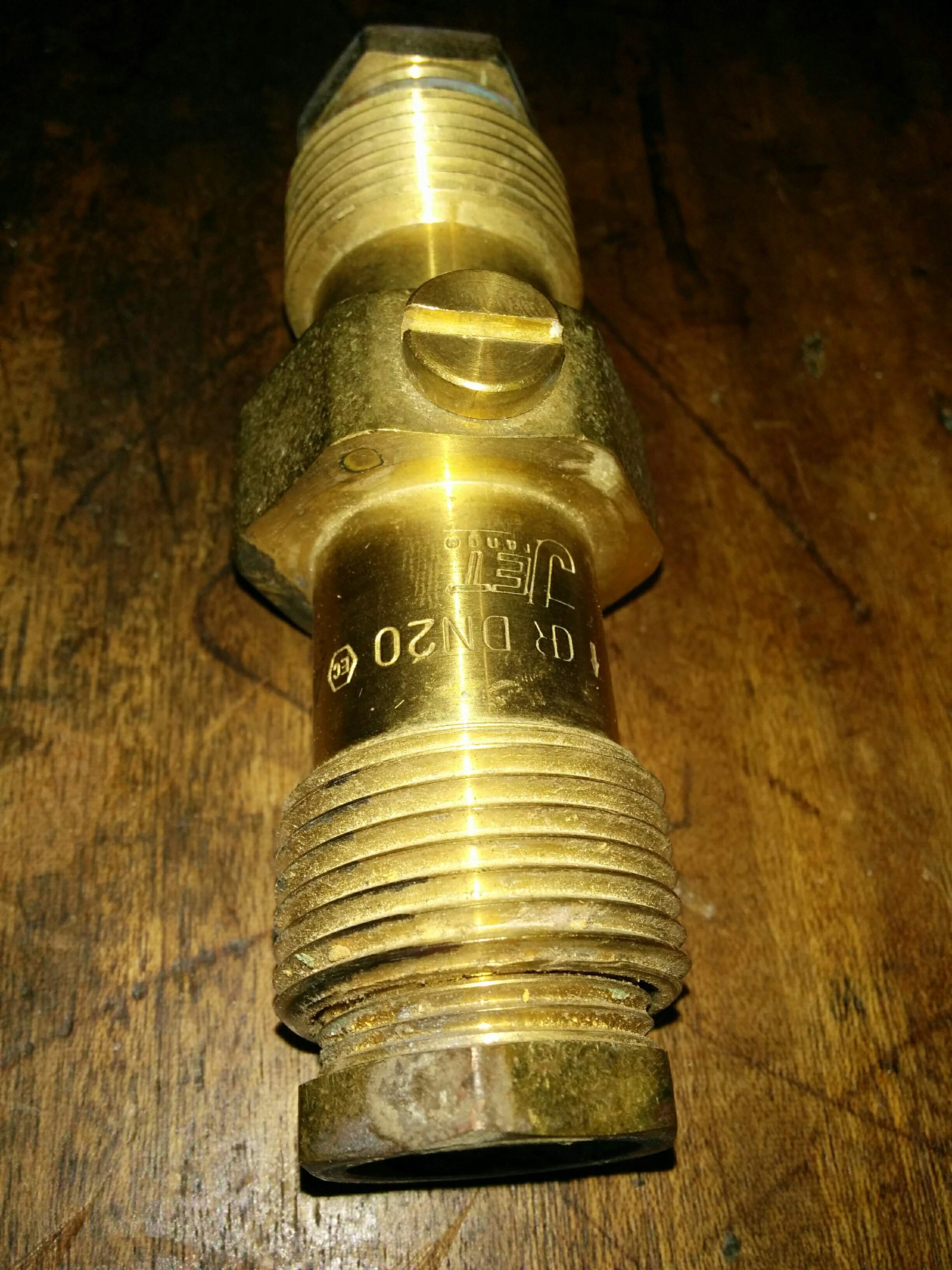

any pics of the valve ?
This is the valve in question.
thats not a valve its a non return or check valve eg
Pegler Yorkshire -
and it would fail if its not installed correctly eg not tight enough
yea normally a brass olive in the bottom
So, would it suggest that the installation of this valve was not fully tightened?
yes or mis installed eg not fully in or missing an olive etc or not installing a liner inside the alk pipe
doesnt let go for no reason if its the fittings fault i would expect to see the collar to pop / threads to fail etc

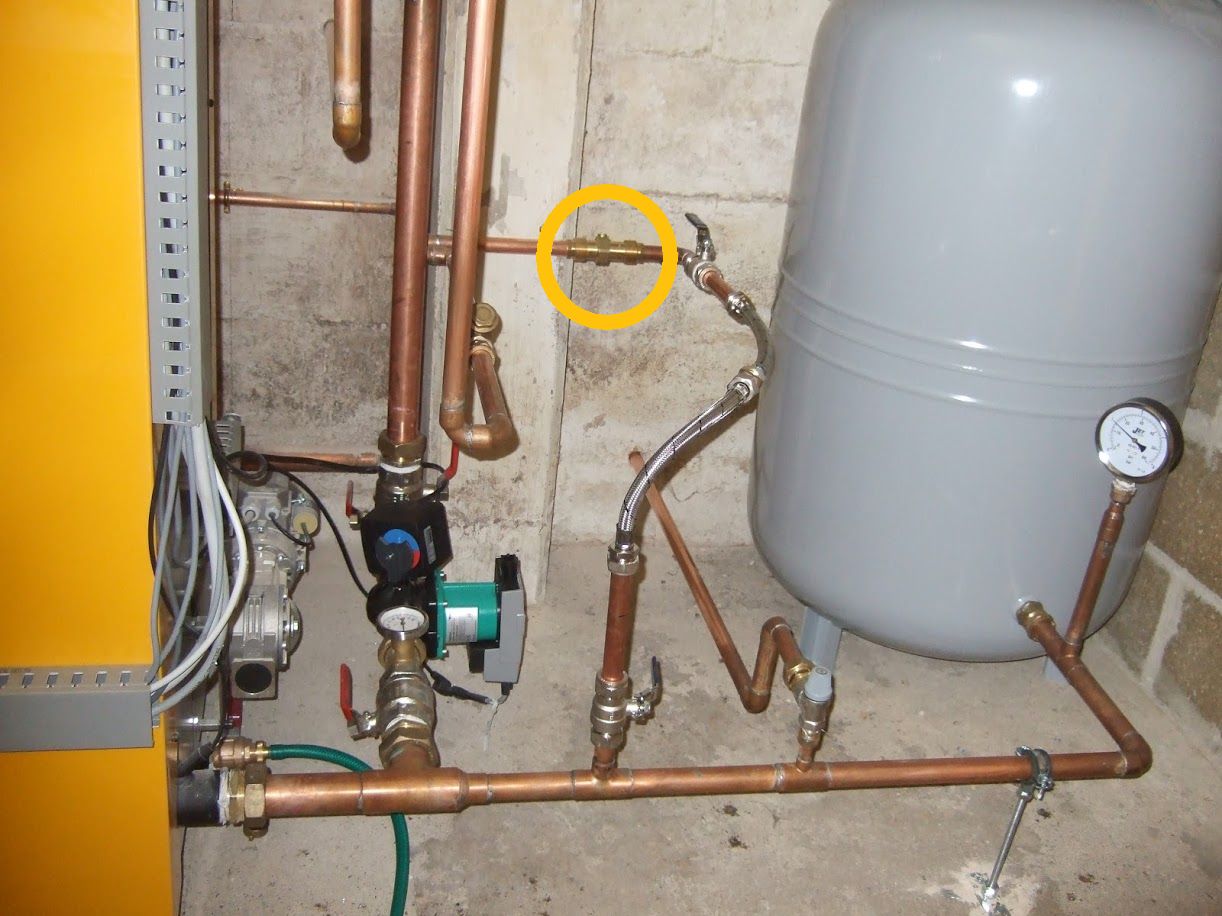

Would need a pic
Where it was installed
That’s 22mm pipe so I would say not the parts fault the installers at fault
With it being 20mm it’s for alk eg watermains etc
What’s with the two flexis ?
So, are you saying that the installer is at fault for using a valve designed for use with 20mm alkathene on a 22mm copper installation?
I am guessing that the two flexibles pipes were used as an easy method of connecting the copper sections together? Looks rather Heath-Robinson to me.
Correct it won’t fit as you’ve measured the hole is 20mm so must of been rammed in or something
Them flexis arnt rated for heating so best get them replaced

DN20 is an ISO sized fitting for 3/4 inch pipe (26.66mm). It is not intended to be used with 22mm pipe. With respect to copper pipe it is intended for 3/4 inch outside diameter.
Normally if metric and imperial fittings are mixed up with 15mm and 1/2inch diameter pipe they generally work (not always). However the size difference between 22mm and 3/4inch is too great for success to be a possibility.
This would account for the pipe “popping” out - but I would be surprised that the pipe remained in place and leak free since the original installation - unless it had been “mumified” with ptfe tape!!
The Jet valve in question is a non return valve, the screw is for testing, it is not intended for isolation, there should be a proper (ball) isolation valve at the point of entry into the boiler house - the installer will have fitted one - he/she won’t have driven 1/2 mile to isolate the supply.
The flexibles look to be a makeshift filling loop. They should be replaced with the correct WRAS compliant ones.
If I were in your shoes, I would check out the system on a line by line basis, both for the design ( heat balance and flow calculations) and the specification of pipework and fittings / quality of installation work.

All sorts at fault here.
Wrong size valve fitted to 22mm copper. ( but would probably seal)
Wrong flexi pipes used as a filling loop. .
Fitter that had the problem thinking the non return was a service valve. Which he then unscrewed the Center. This would then have popped out, causing the main flood.
Looks like the OP is looking for blame, it it’s just a case of bad installation and a mistake by the guy investigating.
Remedy.
Pay the last guy to fit an approved filling loop.

There's nothing wrong with that NRV.
It's suitable for both bsp 3/4, (DN20) using the external thread and 22mm with olive internally.
I've used hundreds of Jet fittings of that type.
The 22mm pipe wasn't pushed in far enough and or not tightened correctly.
If the 22mm pipe was available for inspection it would show the mark where the olive gripped, or failed to grip.
And there should be a mains cold isolation valve nearby, whether the boiler has quenching or not, for exactly the situation that happened.
The quenching is to stop fire if it's burning back into the fuel feed tube or fuel store, not to extinguish the fire withing the combustion chamber.
The flexis are on the filling loop so should be O.K as it's normally isolated.
