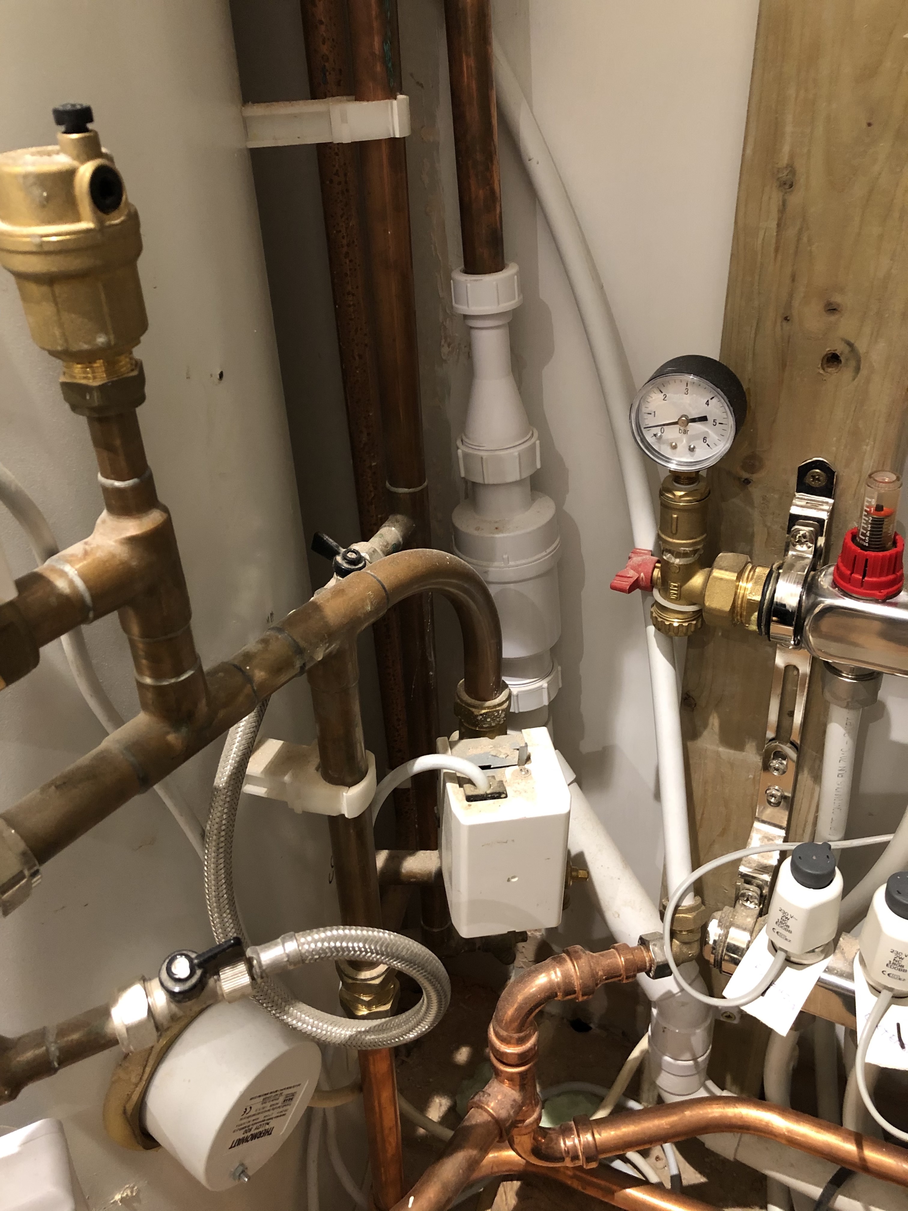

I think I have the same problem as you and wonder if you can help. we have just moved into a flat with the same boiler and I can't find a filling loop. Pressure has dropped to 0.4 although can't find any leaks. But the missing filling loop is driving me insane. I can't access your photos. I am attaching mine. Can anyone help??
Hi. Do you also have a tank? If so - try there (it’s where I found mine). Else, as someone advised me, you might well find it in a “nearby cupboard”. The clue should be the metal flexible ridged piping with a pressure meter nearby.
All the best, Steve.
Like this? Is this the filling loop do you think? (found by the cylinder).
Thanks.
Thankyou so much for getting back to me Steve. And so quickly! I found it!! Miles away in a cupboard where there used to be a tank. Phew.
