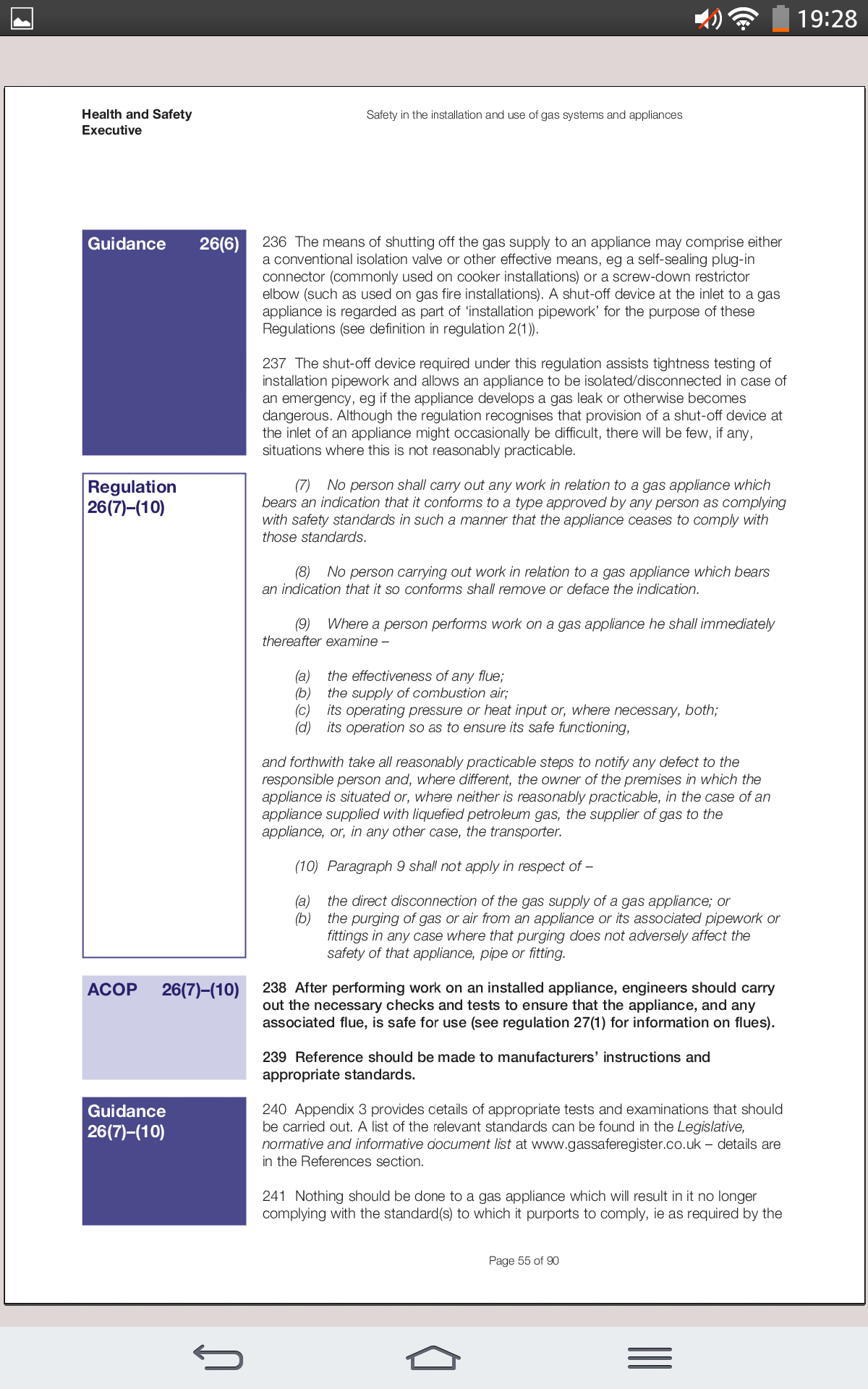

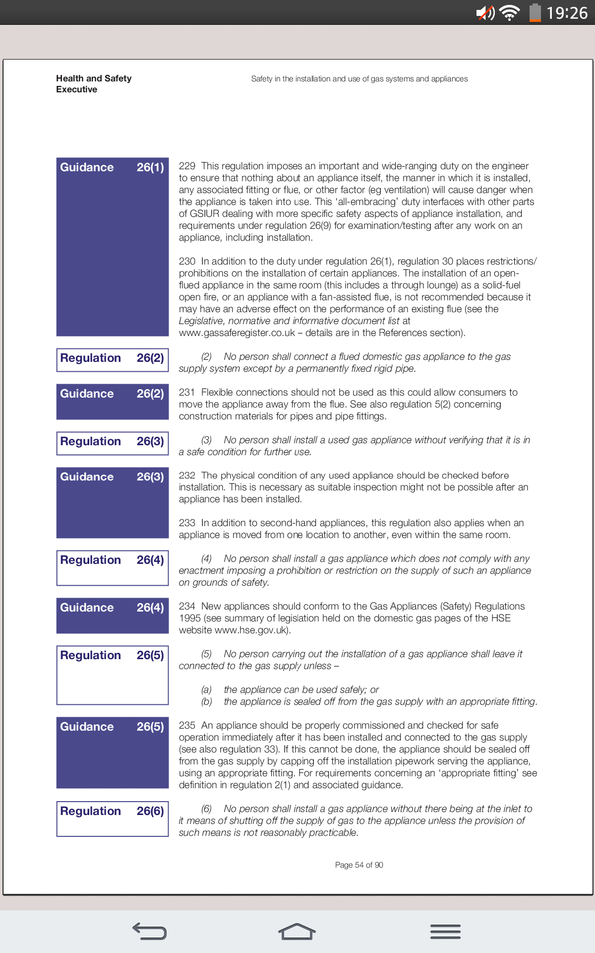

If any gas work's been done, there should be paperwork that supercedes yours. Also, did the boiler have a gas valve built in or did the M.I. say to fit one as an extra? (Never fitted an Intergas meself so don't know)
Don't have my book to hand, but I am pretty sure missing iso valve is not AR.
Can't see how it's AR. Also no isolation valve on the appliance?
If you fitted one and it's been removed then it's not down to you. Obviously you can charge them to fit another one though.
Bet they listed it at modifying a manufacturers part :D
The ones i have fitted all had a isolation valve and it is part of the Gas regs 26(6) . kop
