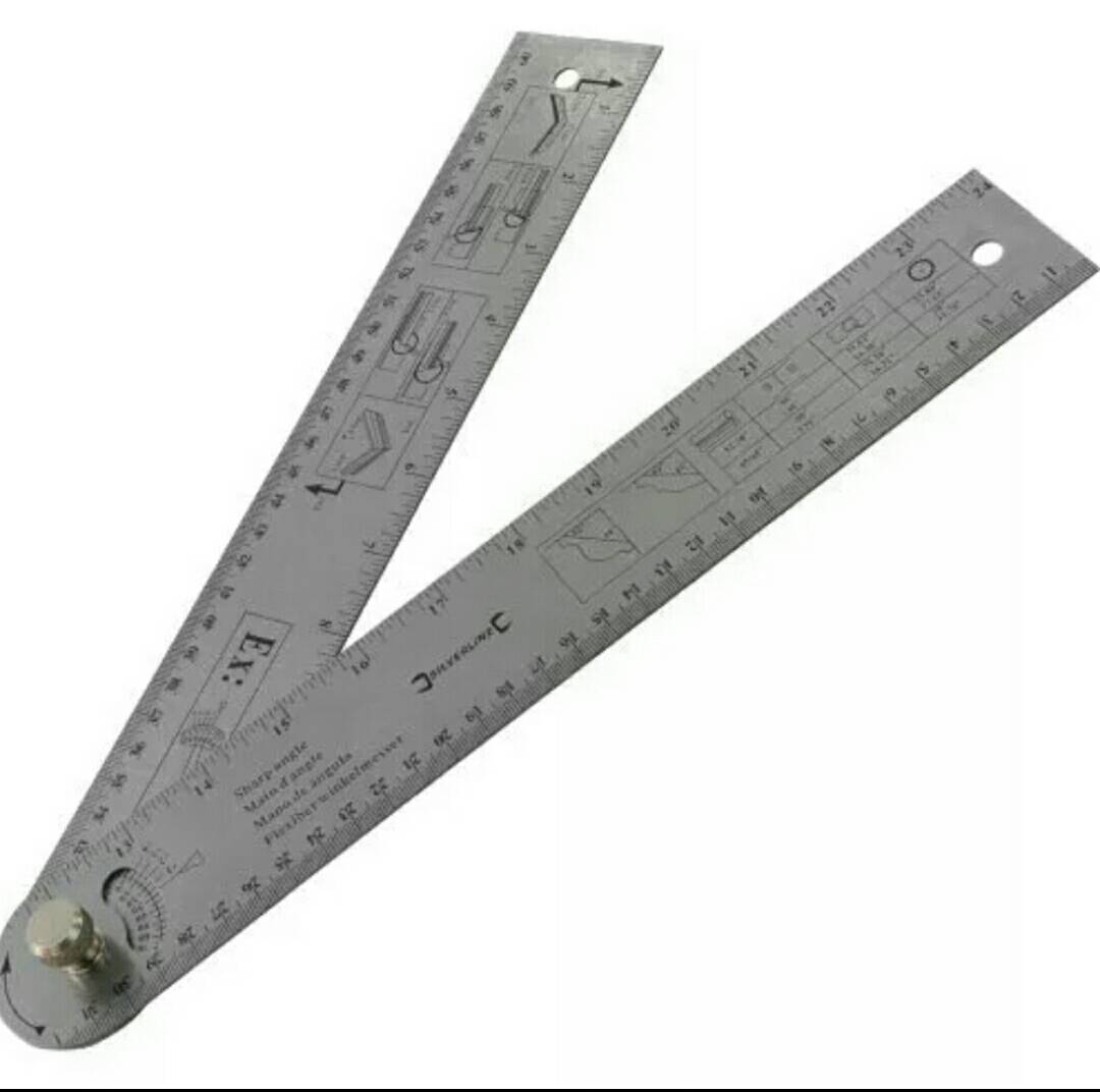

Always handy to carry a small angle rule in your pocket
Do it by eye or just get the angle with the rule you need - handy for underfloor angles etc
Lay the rule on the floor and pull to that angle looking down the bender.
3 quid
