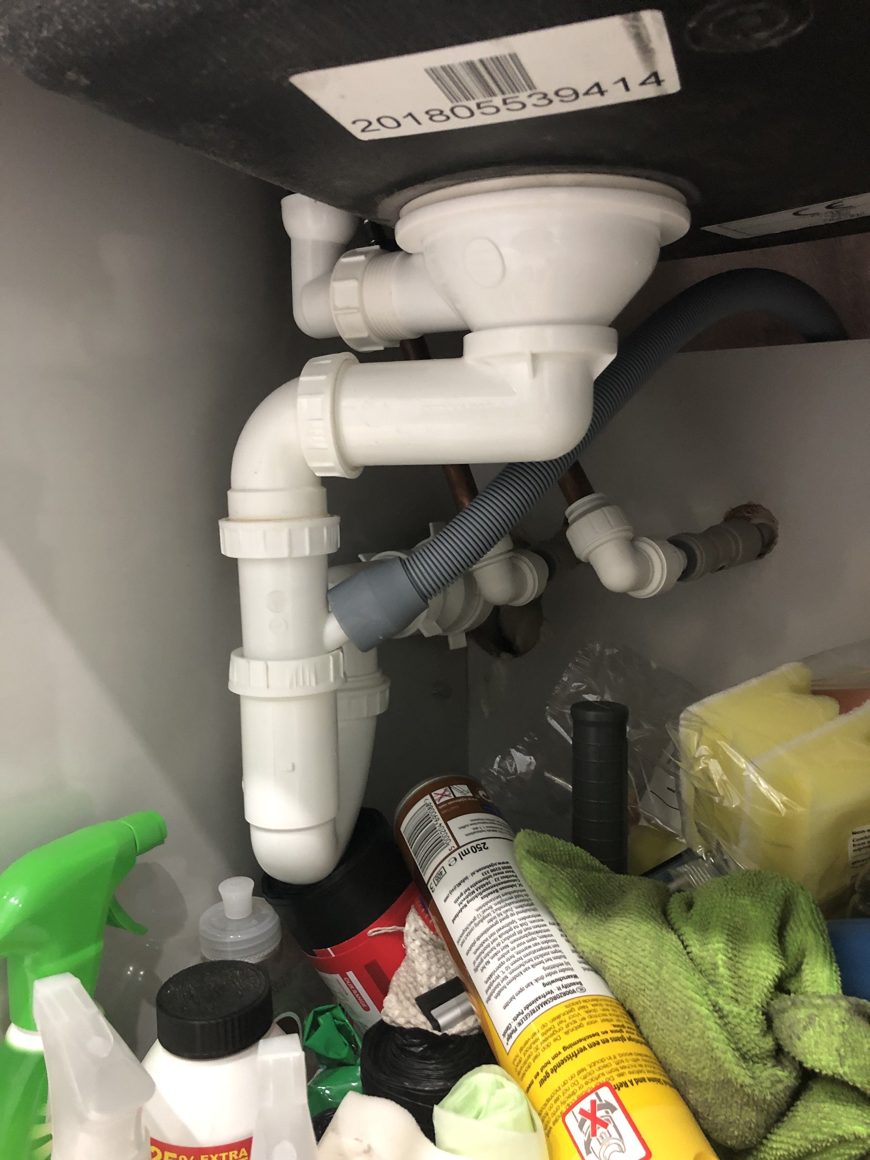

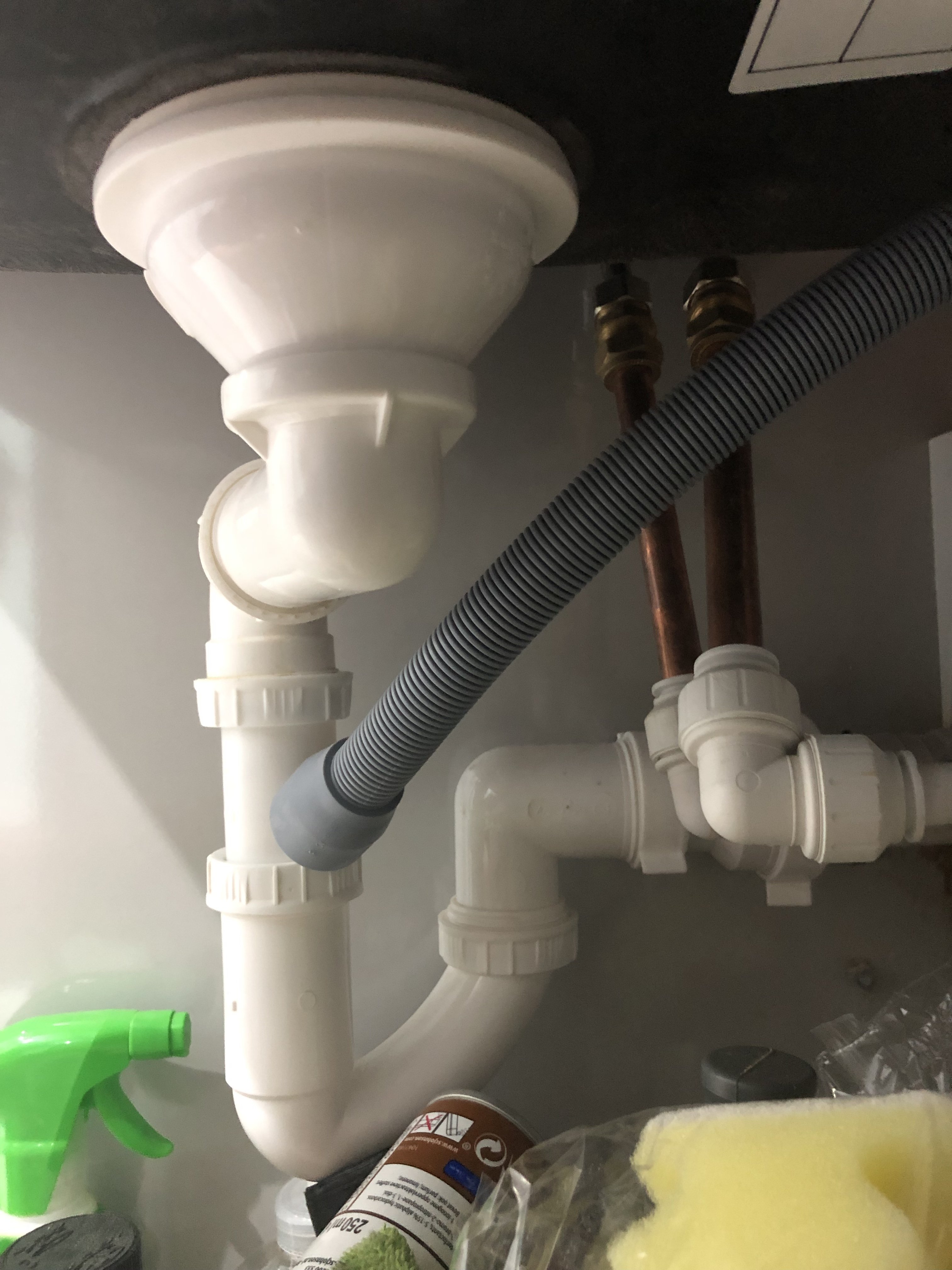

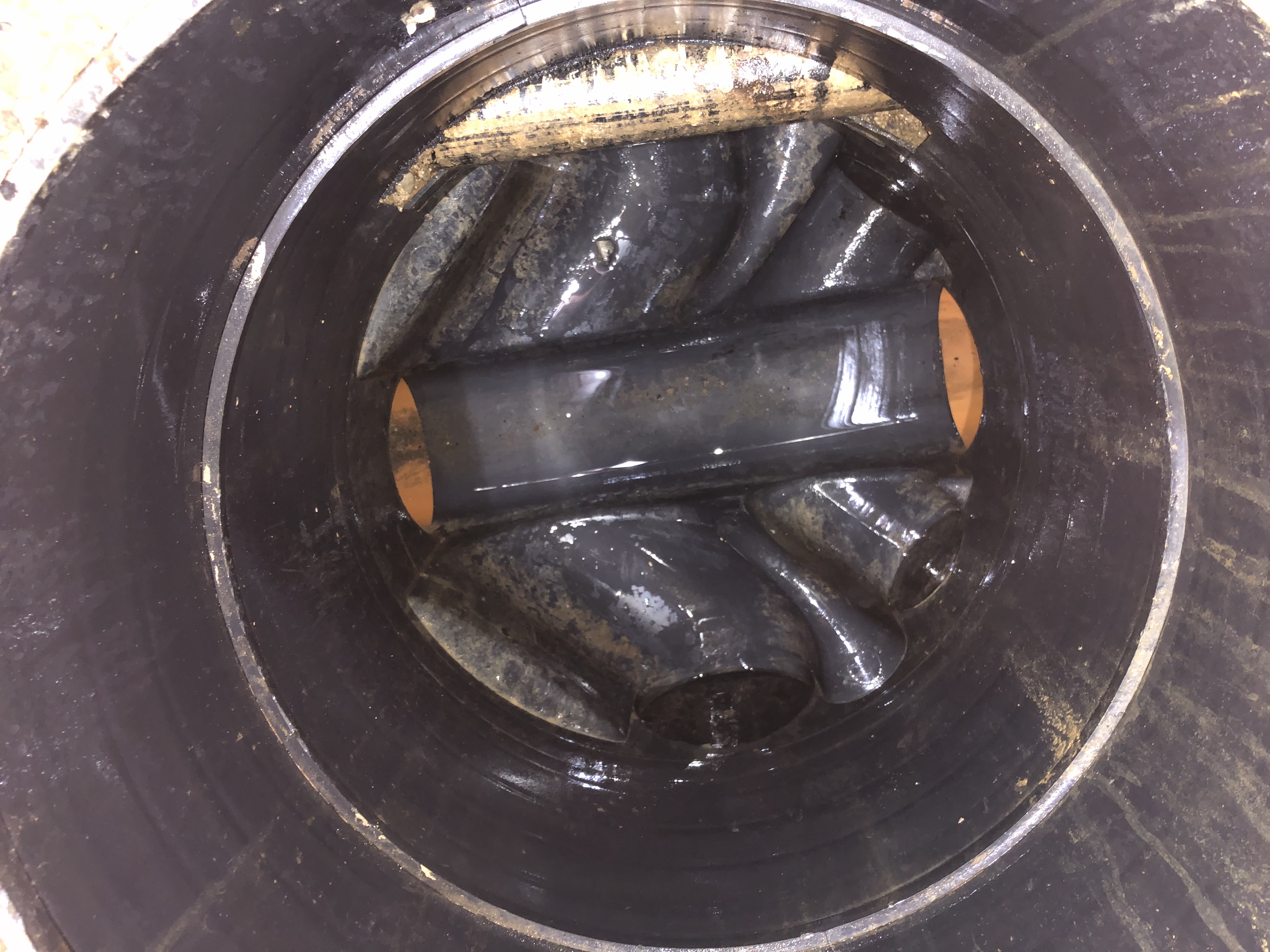

Right so I’ve cut the aav off as it was welded on and I’ll replace that with a bend and extend it up past the gutter as it was before. The pipes are as shown in the pics. I’ve lifted the manhole and it doesn’t appear blocked but I could be wrong. (The debris you can see fell in when I lifted the lid)
It's not really a question of how fast the flow should be. The fall on the pipe should not allow any standing or sluggish water. There's a blockage somewhere. Clear out that debris. If you've had your dinner and you're up for it, lift the next lid on the run. Watch out for Mr Rat. Enjoy :)
So I’ve been and bought some rods today and cleared the manhole. Got some old peices of the cast iron soil pipe out the the builder obviously dropped when he was fitting the plastic pipe. Plus a few other odds n hens. Literally. Lol. Now I’ll suppose it’s how long I have to wait before the smell disperses from behind the sink.

My worry, and I'm always a pessimist when it comes to drains, would be that the root cause of the smell is a leaky drain and the blockage forced sewage out through the leak into the surrounding ground. If this is the case it will take as long as it takes for the ground to dry out.
If I owned this problem and the smell hung around for more than a week or so, I'd be considering having a CCTV inspection and a leak test. As I said, I am a bit of a pessimist, but a builder that left the drains in the condition you found them in is IME likely to have cut other corners. In these days of 'polluter pays', you really don't want to have a foul drain leaking into the ground for years.
U nfortunately there's definitely a bit of a problem there . It's just not possible to cut into an insepction chamber in that way. Debris will always be falling in and blocking the pipe (aided by rats), sewage will then be leaking out into the ground causing a potential health hazard.:oops: It will need sorting.
If that's soil that is visible between the white pipe and the black plastic you might want to think about sealing it to avoid any soil getting into the drains and causing another blockage
Also just another thought you want to make sure that whatever you sell it with rats can't get through (could get some wire mesh I'm there) as they're drawn to sewers and could cause even more problems.
As the integrity of the I/C has been breached significantly and the gas pipe has been exposed... I'm out... Good luck

No it won't be that even with the manhole cover removed it shouldn't create any smells in your kitchen. When you say the smell is behind the sink, do you mean at kitchen counter top level, or in the cuboards underneath?
