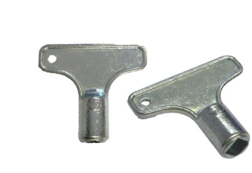

I have a very old radiator for which we cannot find a key for. It desperately needs bleeding, any ideas on how I can do it or is it time for a new radiator?
Try a Brass one like this, the end is a smaller diameter;
The typical soft alloy ones are too big;
Some brass have larger ends and would be too big as well;
Looks like a removable complete air vent anyhow, (I copied and magnified image) so should be possible to just replace the lot if it screws out with a socket of correct size.
Alladin Easy bleed, where you drill a new hole and it cuts it`s own thread? Hasten to add that I`ve never used one myself.

As Member rpm suggested - If You want to try and avoid damaging the existing air vent / having to replace the Radiator try one of these self drilling Easibleed radiator air vents:
As you have a single panel radiator which these are designed for you just screw it into the top front of a radiator using a cordless drill and a 10mm socket / socket bar.
THIS IS NOT IN THE FITTING INSTRUCTIONS - JUST MY SUGGESTION - BUT PLEASE DECIDE ON THIS YOURSELF:
Although these are self drilling [as in self tappers]
and as Member rpm mentioned - I would be tempted to pre drill a very small hole [much smaller than the tip of the air vent] just to locate the tip of the vent when drilling it into the front of the Radiator.
The bleed valve / air vent will not get 100% of the air out from the top of the radiator but it should enable it to get hot enough to not be a problem.
