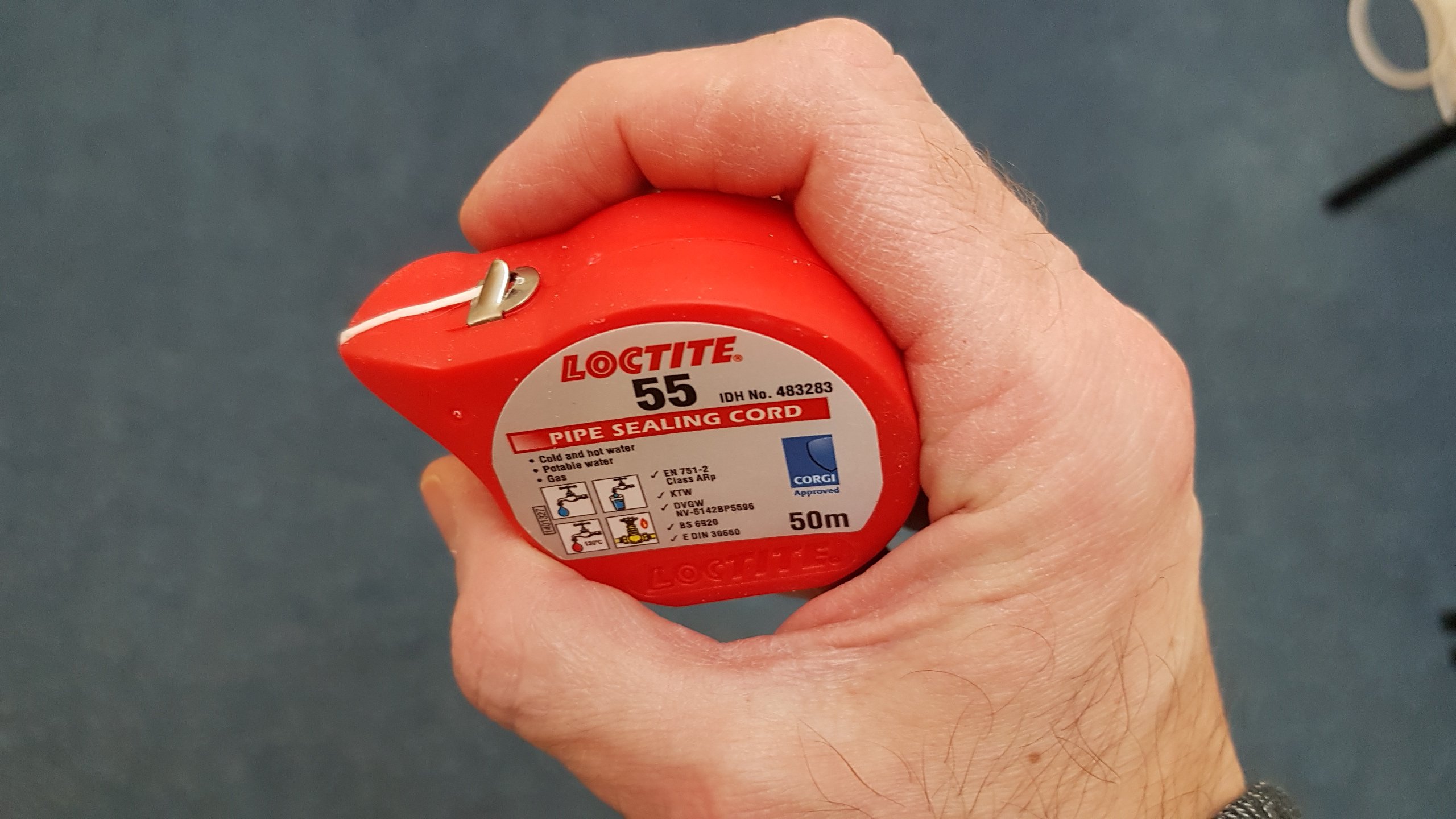

I ended up on the loctite 55 after having failures with the use of ptfe. Especially when I used ptfe on short adds on (photo below) or parts with short thread.
I noticed that loctite 55 offers a better solution .
