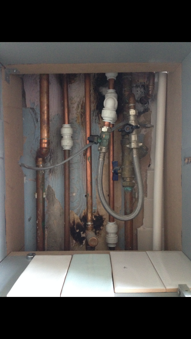

I got called out to inspect some plumbing works.
Boiler: brand new vaillant, no filter, no reducer, no carbon monoxide alarm, prv pipe facing 2 sockets
Location: bathroom

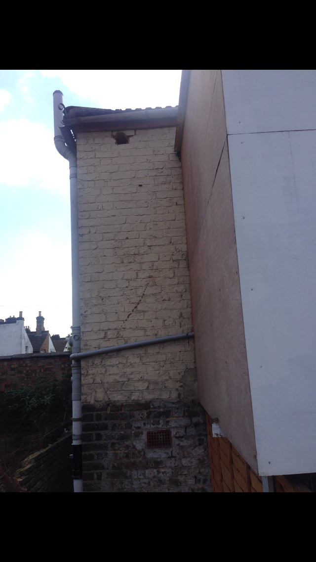

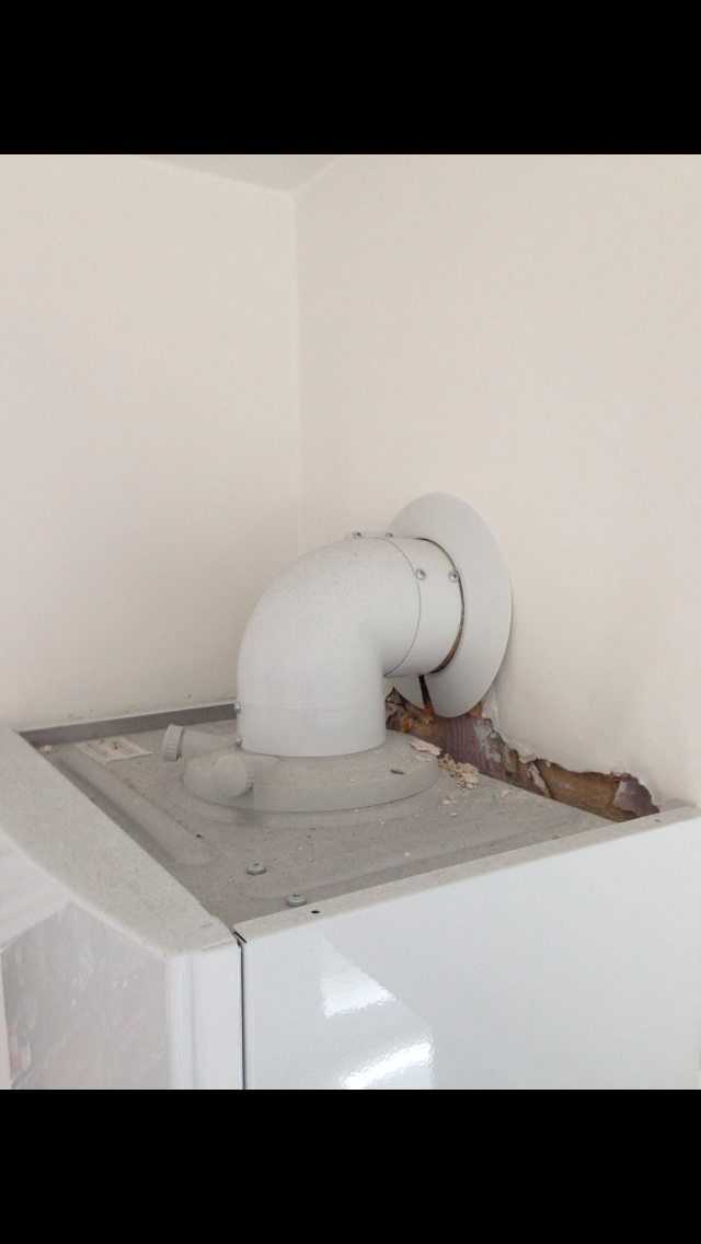

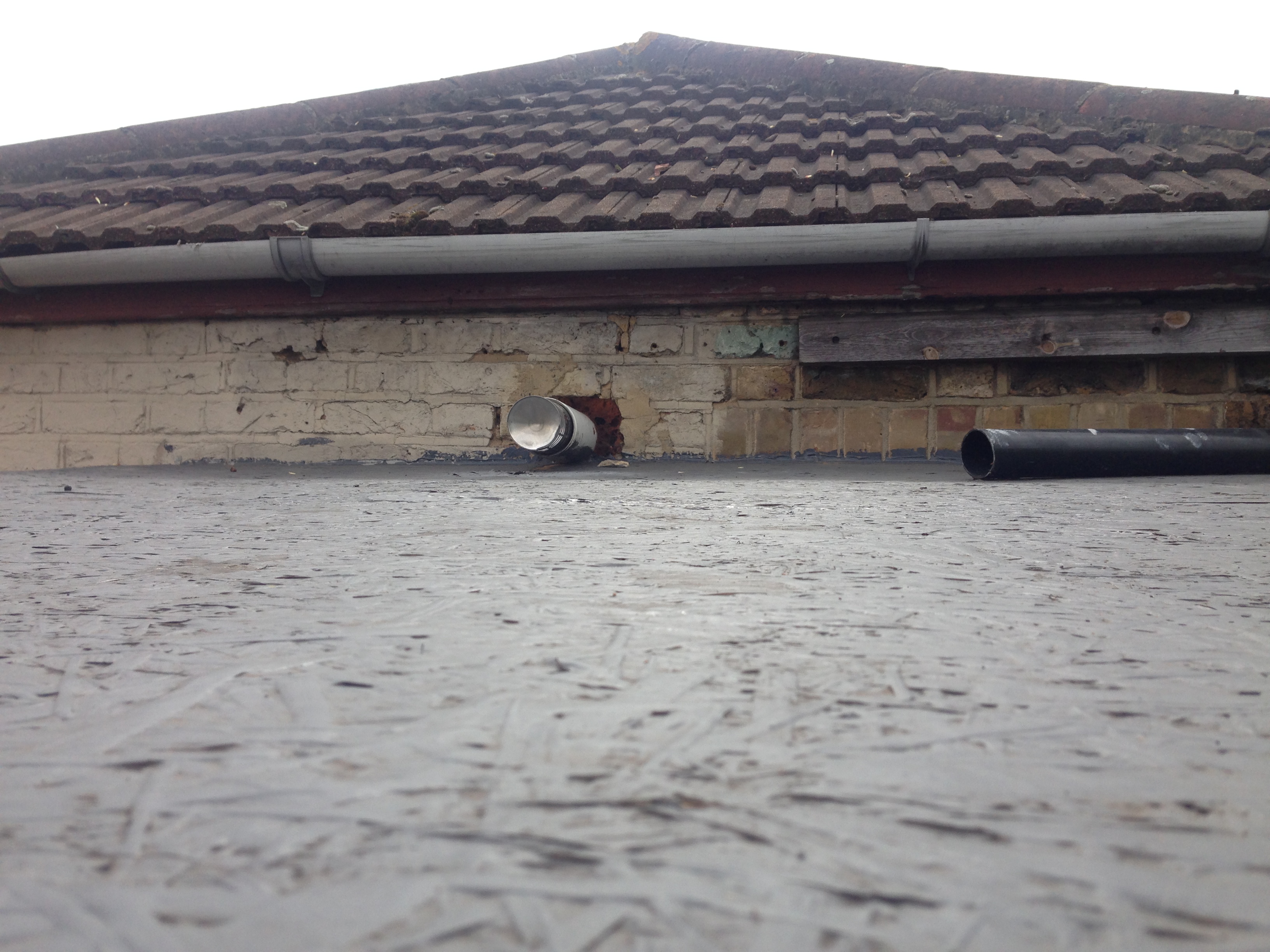

Flue: no access to the flue at all, it looks pretty much they used an old existening flue
The prv pipe goes straight out into a little extension / bended down and right underneath is a 240v socket. It's not leading to outside.
System hasn't been flushed.
Company walked away without commissioning the boiler without registering the boiler.
What has to be done to make this to current regs and most of all safe ?
I am about to give the job to my gas safe mate. Just wondering what you think about this job and what would you roughly charge to register the boiler with gas safe? I think the flue, access and a filter should Ben installed, am I wrong ?
Would love to get an advise kind regards.
