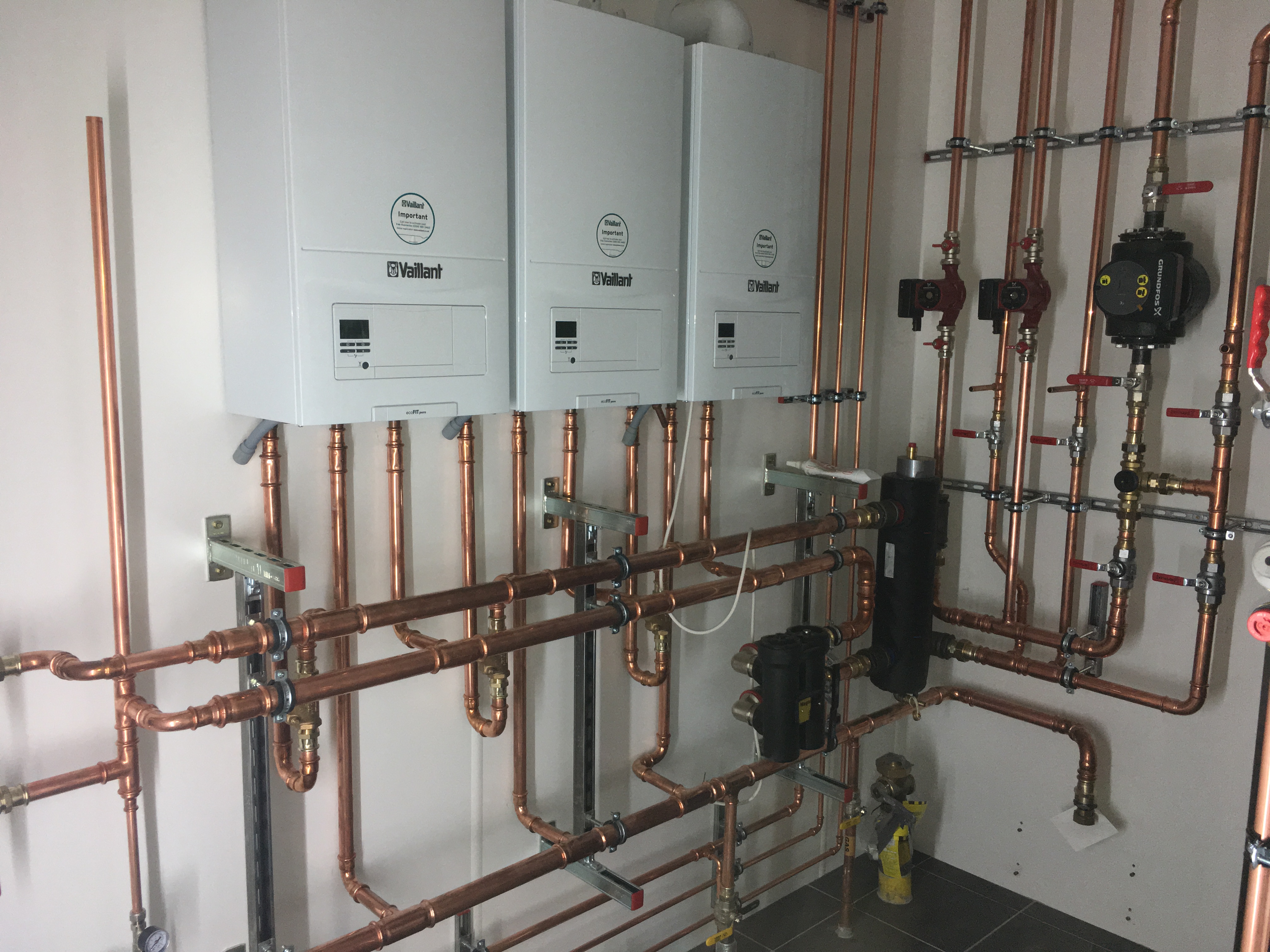

As Bacon said, we already do that. Have done for decades.
On with one right now.
I sure like those purty plated butterfly/ball valves on those grundfos circulators, who sells'em?

Williams trade only sells them
View attachment 31499 On with one right now.
Looks very good, first class. Did you design and specify the installation ?, is it fully automatic pre programmed to switch between boilers say every other week ?, or to be done manual. I think this is the way we move on.

The combined load for the property is the total output of the boilers combined. Hot water, space heating and swimming pool.
In fact tthis set up is 20kw shy of the building load. Because, when the pool is up to temperature, it only takes 20% of the output to heat it from cold. Same with the underfloor heating (1000m2 of the stuff!) .
This system has a cascade controller to bring on one, two or three boilers depending on load. It also cycles the lead boiler, so they all share the load.
Reasons for using multiple boilers.
1. Built in redundancy. If one breaks down, the other two will at a push, run th whole system.
2. Cost it's cheaper to get three smaller boilers, than one, or two larger ones.
3. Servicing. All parts are stocked at merchants and any local gas safe service guy can do them.
4. Fluing. Large commercial boilers have large flues. Smaller boilers are less obtrusive.
Back to the original post.
Generally it's not financial sense to have a spare. You can't see the whole plant room in the pic . But there is over £20,0000 worth of equipment in there. Never mind fitting it and having a room to get it all in.
