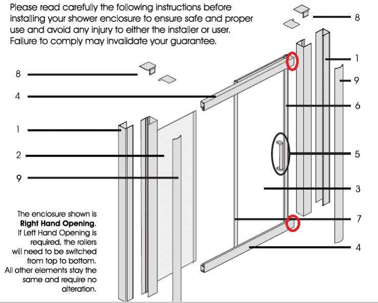

May be too late now but on most sliders you can reduce the length of the top and bottom rails using a fine toothed hacksaw, normally needs to be done on the door closing side, see drawing below where I have highlighted the cuts in red. Check before you do this that doing so will not cause a problem elsewhere, will it still screw together etc....
The door opening width on this enclosure is 465mm so you could easily cut off 20mm and still be ok. You will of course invalidate the warranty on the door but who would notice?

Thanks a lot for this. I do believe it will work. We've already ordered the new enclosure from Williams but to be honest there is a good chance I can use a 1200 sliding door that's boxed up in the future whereas there is no chance of me being able to sell this again. We have a chopsaw that will cut this rather nicely with a fine metal blade too.

Quick update. Cut the top and bottom rails down by 15mm today on our chop saw and it all fitted together no probs. Shower engineer you sir are a legend, would never have thought of doing that.
Yes, apart from the reversible rollers on the door. Went to unscrew them last night thinking we are done now. One of the bolt heads that screws in to secure the door rollers was malformed and we couldn't undo it. Tried drilling it out and everything. End result, still not done and waiting on a spare part from Twyfords. Much better than a new door though.
