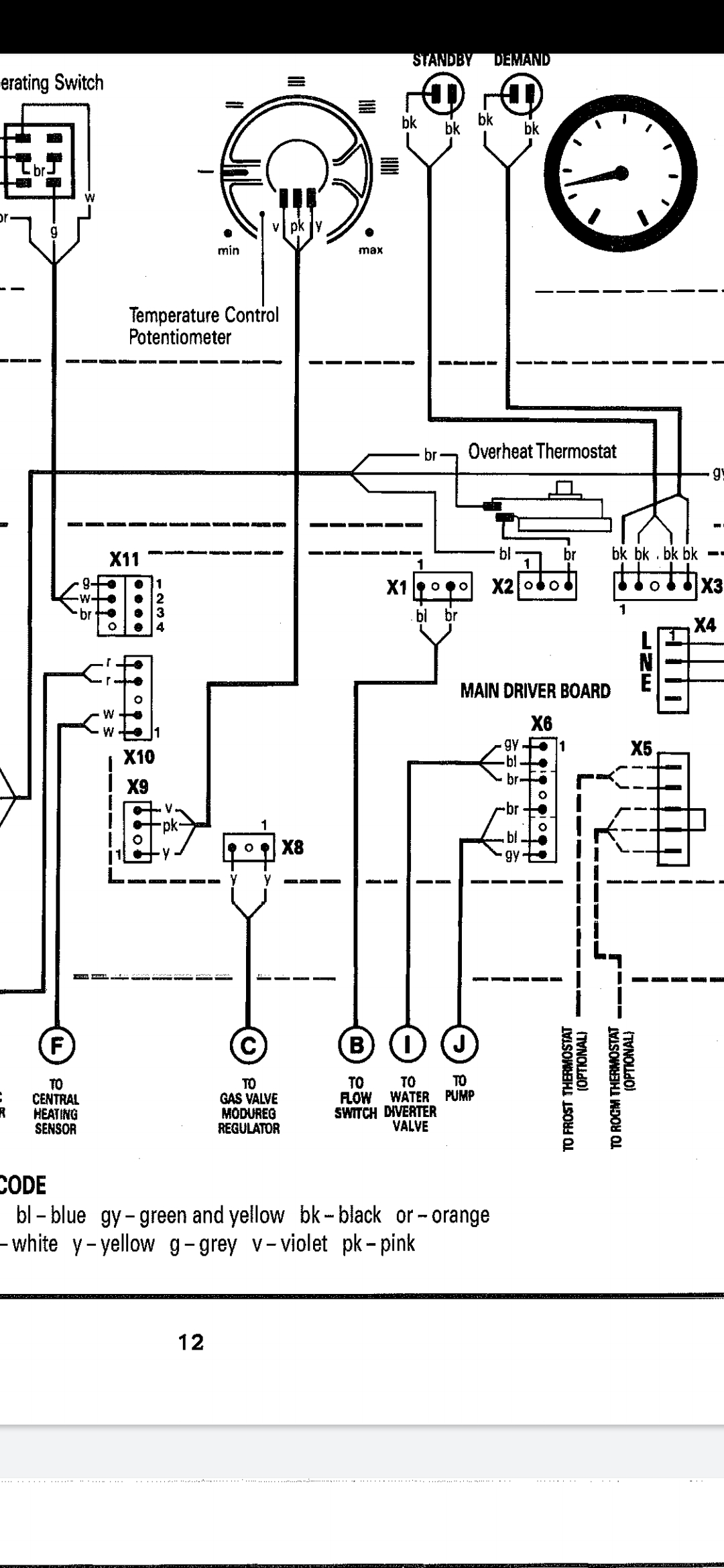

Worcester 280 rsf. Heating works fine, hot water fires up but is only like warm. Now with heating demand I'm getting 240v at 3 port. With heating off and tap running it's only.luke warm. If I manually move motorized valve to left it gets upto temperature. Iam only getting about 4v on board with hot water demand the lever does move abit in hot water demand...Am I right in thinking it should be 240v and the board is nackered or could it be the valve itself?? Sorry lockdowns took its toll on my brain haha.
