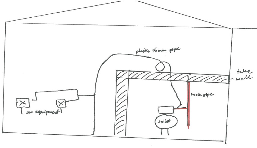

I have no plumbing experience and a small problem - I have been hoping you could share your thoughts and let me know what you think is the best solution.
I have a garage/shed/whatever you want to call it, which has equipment inside, which relies on steady pressure of water to work properly (it dilutes chemicals and any sudden jumps/decreases in pressure affect the mix). Inside this small building, there is a toilet built from a fake/cardboard wall, where there is a water pipe.
I have connected the equipment with the main pipe using a plastic 15mm pipe, as shown on the attached diagram. Unfortunately, the pressure is not really steady (it varies a lot) and it is far from being strong.
I was wondering - what should I do?
(a) Is there some small automatic water pipe which I could install between the plastic 15mm pipes to increase and stabilise the pressure?
(b) maybe if I drilled a hole in the wall and re-route the plastic pipe (to go directly from the toilet to the equipment) this would make a big difference to the pressure and its steadiness?
(c) ... or maybe there is something else?
Thank you very much for your kind help and time. I really appreciate it.
Best regards,
Dante

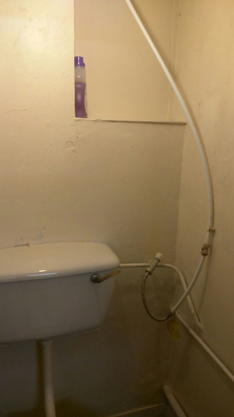

I am attaching some more pictures to give you an idea about the connection
When you turn on the diluters (and keep them on), the output should be steady. Instead, it is a bit... well, unsteady. It is not the same as e.g. water under the shower losing pressure when you turn on a tap in the kitchen. It is more like being slightly "noisy", as if the pressure varied continuously a bit. I am not sure if I am explaining this correctly...
It is possible that there is some other appliance on the same pipe which is being used, but it is difficult to track (there are jet washes used continuously etc.).
Is there any quick fix/piece of equipment to stabilise the flow? A shower pump or something? Would changing the pipe connection change anything? (to make it more horizontal, rather than going up and then down?)
Thank you for help!
You really need to install a break tank because you are contravening the water regulations. Get a plumber as they should know the regulations.
Hmmm but why "wtf"?
Regarding the break tank - thanks for the tips, I will get a plumber to look into it. As a side note - could you please explain why the current set-up is not permitted? There is no risk of backflow (the equipment runs separate pipes for chemicals and water, they are mixed only in the bucket - a bit like old cold and hot water systems).
it contravenes because there is a risk. You might always mix everything in the buckets but there is a possibility of back flow so it needs to be changed.
I vote for a break tank
Hmmm but why "wtf"?
How do you know that there is no risk of back flow? It is your responsibility to ensure that you do not pollute the water system and you WILL be fined if they have found out that you haven't taken adequate steps. You may also poison people which isn't nice either.
You can start here: https://www.wras.co.uk/
We have to pass water regulations exams, that how we know this crap.
The people who installed the equipment were quite happy with the solution, but I understand that there still is a risk. I will get a certified plumber to look into it!
