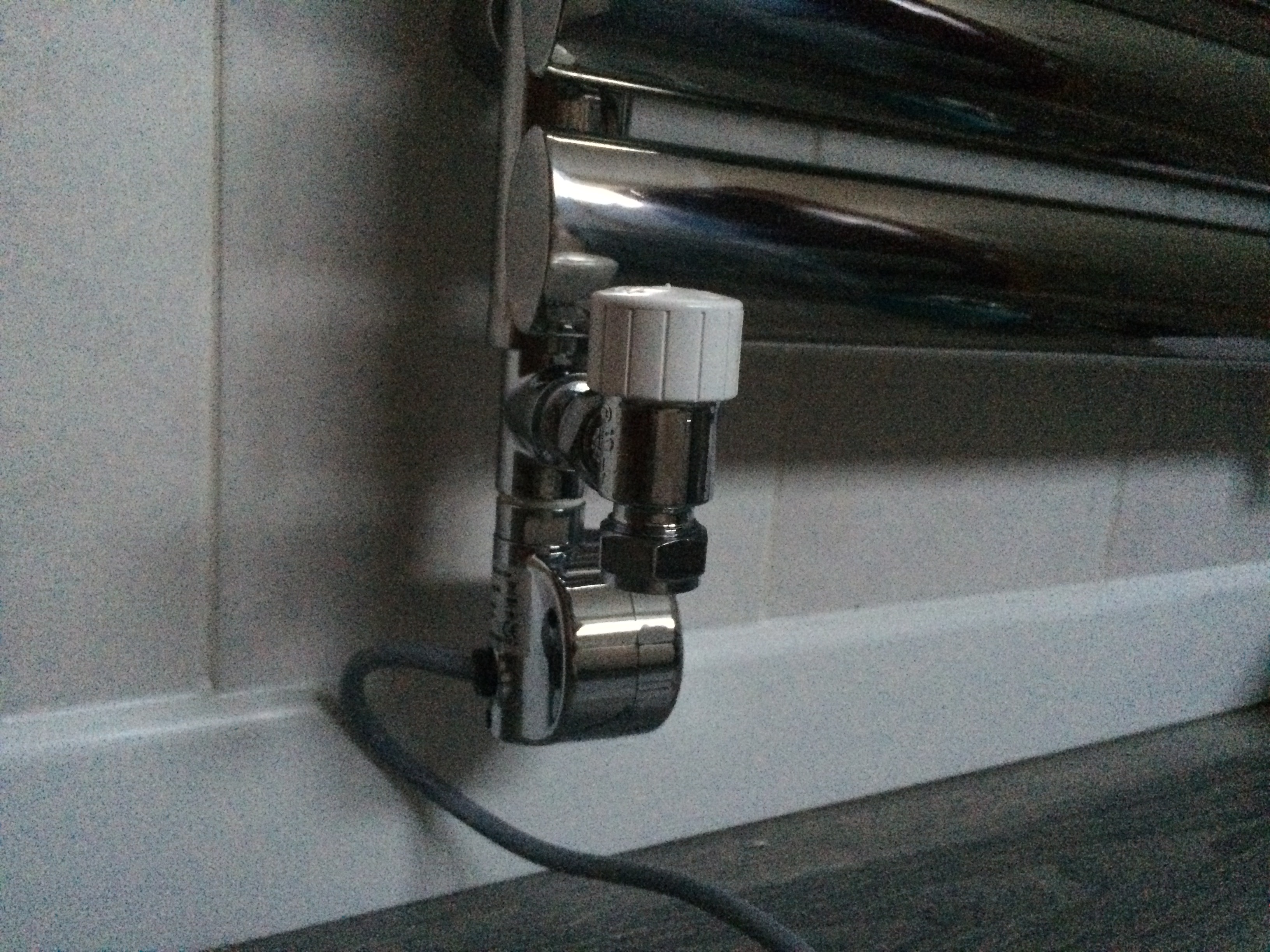

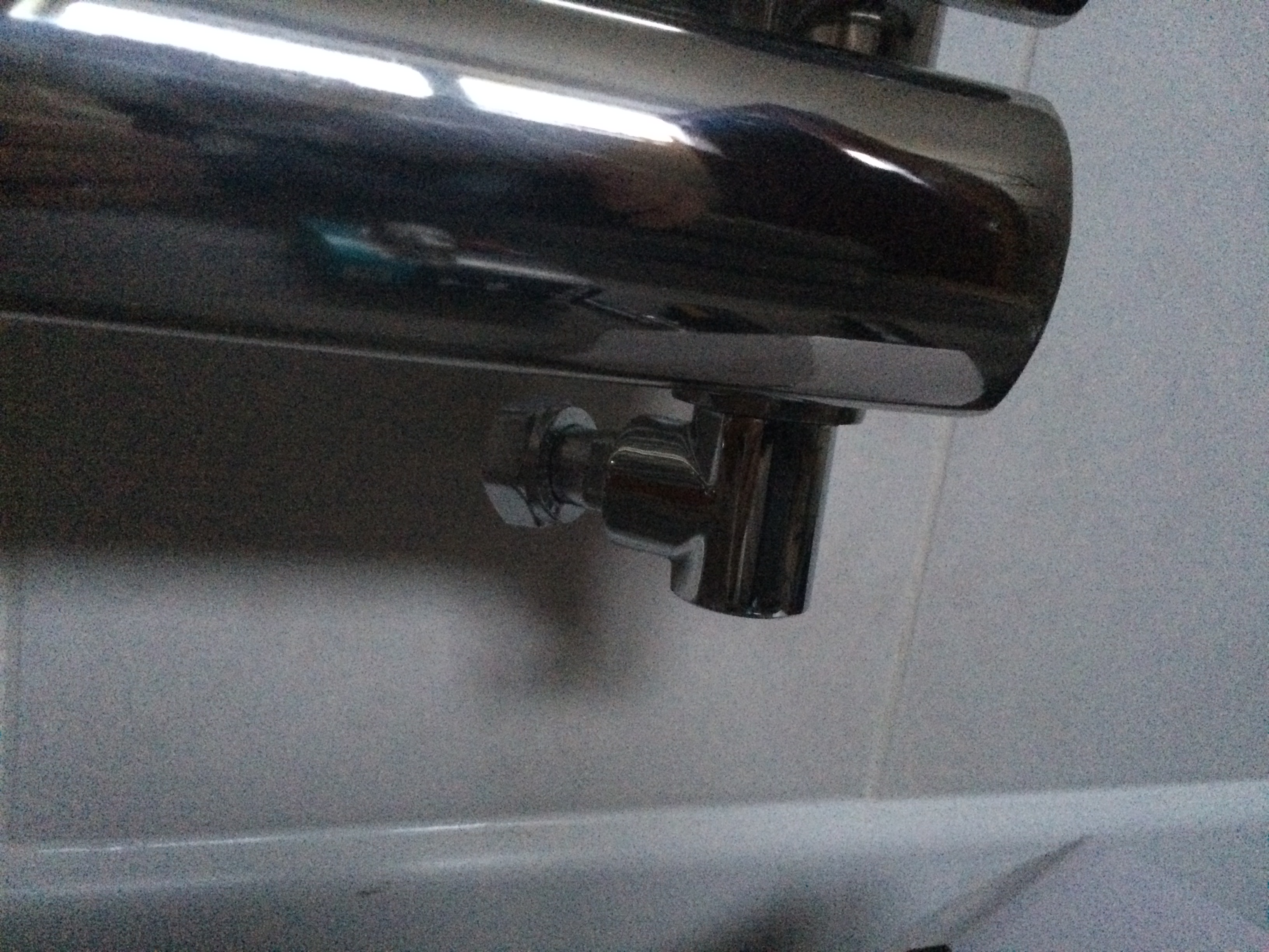

Trying to fit a couple of adapter bosses like this....
ae235
Into the bottom of a heated towel rail.... problem I have is that it only seals when fully tightened, but the side spigot then doesn't line up with the pipework. I have tried (10 turns) of PTFE tape, but the boss still can be easily rotated on the thread. I have jet blue, but aren't confident that it would work with a "loose" fitting. How is one supposed to tighten the fitting so that the side spigot aligns with pipework, but water doesn't leak out of the radiator, without bottoming on to the o ring? Fit several o rings, washers, or what?
Can you send some pictures as would be easier to see how far off the alignment is and what set up you have?
I can see the problem, I have never used it but have a look at loctite 577 , pretty sure thats the product , I have seen a video somewhere , try youtube.
