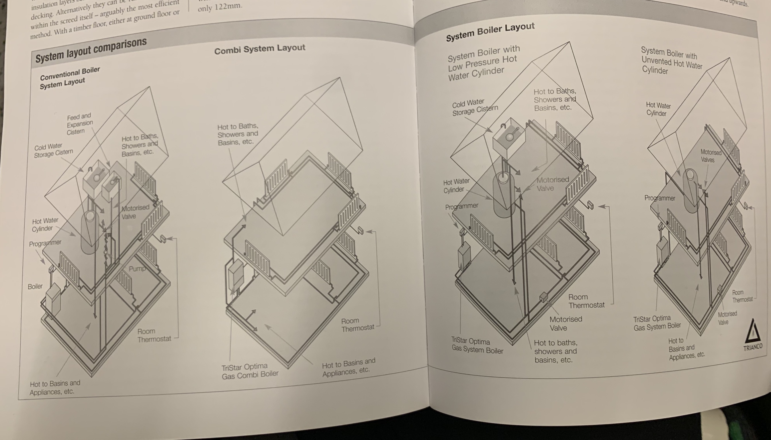

the confusion comes from when reading a book ‘Bible for self Builders’ where the conventional and system have literally same components. I know devil is in details ...

First bit of advice I’d give you is stop talking to builders about plumbing. Very very few understand how a heating system works correctly.builders build, plumbers plumb. I am probably being very thick but what are you actually asking ?????? Old boilers are very very problematic when moved be warned. From reading what I’m reading the answer is yes a new boiler can be fitted, but I don’t really understand what specifics you need. Please clarify and we’ll be happy to help, however the absolute best answer I can give is get a few engineers out to advise and quote for the works. You are neither qualified to fit a boiler or a pressurised cylinder (megaflow) so I would put down the “bible” and get some bodies on site to size a correct system for you. The fact that you can’t see the differences between the pics In your book would suggest you need some pro advice.

Nope. At first glance in the picture it says on both hot watter tank, motorised valve, expansion vessels. Indeed the guy states in the boom to get corgi or G3 to install but the more i understand the better i can spend my time selecting adequate people to hire and in case they mess around we cut it short.
