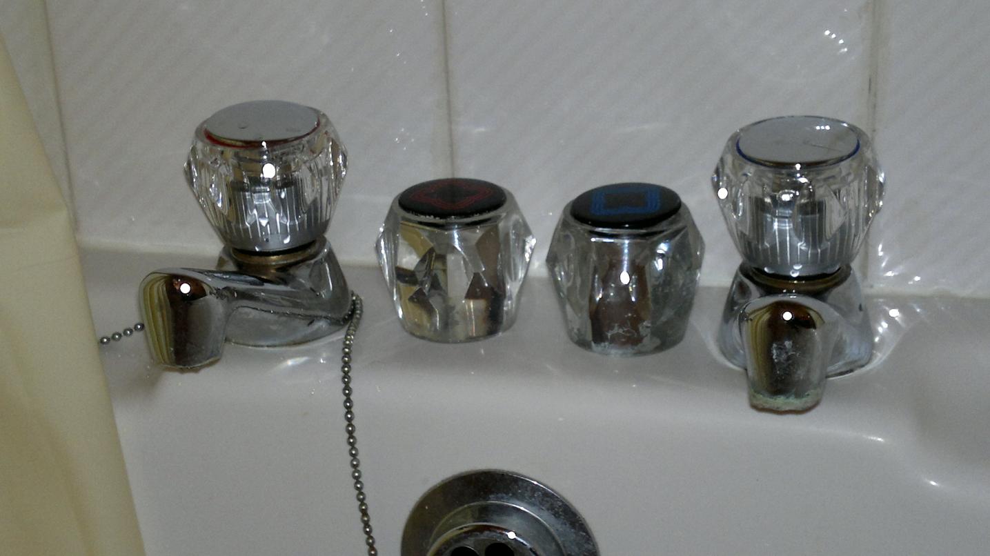

Hi everyone,
This a plea for a solution to avoid work (and expense).
The problems are the acrylic bath taps on a lovely(?) avocado 1970s bath. They have broken. The taps are both fine - it's just the acrylic tap knobs that are broken. [Photo attached]
My preferred solutions would be (in order of preference):
a) Replace acrylic tap (tops)
b) Fit a pair of tap "revivers"
c) Use modern splined tap top and convert (drill & file) the circular spline to a square fit
d) Don't know yet
e) Replace taps (meaning remove bath panel, bath, cut supply pipes, fit new taps, replace bath, replace tiles, reseal bath........)
f) Pay someone else to fix it.
g) Persuade the wife to use a wrench/socket set to turn the bath water on and off
h) Completely redo the bathroom (£££)
The acrylic tap tops fit the square shaft of the tap assembly. The tap shafts are approx 5/16" square and have no vertical grub screw. (I realise the whole world of taps has gone to some form of circular splines)
It seems that modern bath taps are 3/4" fitting.
The tap bodies have a screwthread fitting which is just under 40mm across (ie 1 1/2").
I cannot find anyone who has a pair of these tap tops with 5/16" square socket.
I cannot find anyone who has a tap reviver kit that has such a large thread.
I am very reluctant to opt for option e and f above. Don't even consider options G or H!
The easiest access to the pipework (without removing the bath) would be to make an access hole in the external wall!
This seems to be a headache for what should be the replacement of £1 worth of plastic.
Does anyone know where I can get a pair of these old tap knobs from? I've tried the local "civic amenity facilities" and they insist that even if I found scrap taps, taking them from the dump would amount to theft. (In the old days, you could just slip the guys a few bob and they would keep an eye out for you).
Help/suggestions?
Yours Desperately.
PS the wife has now banned me from stopping at skips! ;-)

The snag is the age of the bath taps ie the tap head (valves) are 1 1/2"/38mm threads (not the same size as modern 3/4" bath revivers). I have not been able to find a reviver with valves this large. So I'm still looking for the magic 10 minute solution.
I am now a bit more hopeful. I've found a product called "swop a top" from Oracstar (Owned by Robimatic; in turn owned by polypipe). These are just tap tops (no valve). They have a hexagonal collar that screws to the tap shaft (and can probably be drilled and filed to suit large square tap shaft). The hex collar fits into a matching recess in the new tap top. These are quite hard to find since a) they are relatively expensive and b) Are only of real use on really old taps (since modern taps take the cheap as chips revivers). I finally tracked down a web-based supplier. Today they have inadvertently sent me the acrylic version rather than the chrome version that I ordered.

Hello Garythegolfer. I just joined the forum specifically to tell you about tap heads, so I hope I am not too late. I had the same nightmare, I sent away for some from Notjusttaps.co.uk and their advertising was very misleading, needlesstosay, I had to send them back because their so called larger size was basin size, and it ended up costing me nearly as much in postage as the tap caps themselves, so dont bother to check there. I had the same with a local plumbcentre, said he had them on the phone and when I went around, it was a conversion set he was trying to sell.
I actually got some today, Oracstar Swop a top, acrylic, (I actually wanted chrome to match the basin taps) but gave up on that. Got them in my local Wilkinsons store for £8.50. They looked ideal for my 1980's bath taps. However, it wasnt as simple as I first thought. They give you an adaptor which goes on top of the existing spindle and that is held on by three grub screws. However, my spindle was too fat to go in the hole (about 1/2" depth) and I didnt want to try and shave down the spindle in case it all went pear-shaped. So I have spent all afternoon, with a drill and some metal bits, trying to enlarge this hole and with much perseverence and swearing, I did get there in the end. They are not a perfect fit in that they are a fraction shorter in depth so you can see a little of the base. I think I could have drilled a little more out but I got fed up walking up and down the stairs checking. I have taken a photo so you can see what I mean with the old taps in the middle, when you look down on them, this gap hardly notices.
I didnt think the image would appear so small.
So if you are prepared to try and drill out the hole, probably better than I could, (I am a female, afterall, and getting on in years, lol) asssuming your spindles are too big, I think these are the only ones you can use. There are no other bath size tap handles now, I am told that basin and bath taps these days should both be the same size.
There is a site I saw but they dont give any details but they are a lot more expensive, and for £8.50 I was prepared to give the oracstar ones a go (Oracstar are a good make, not a wilkos brand). These people also sell the oracstar and have the chrome I want but they are twice the price plus postage.

Firstly thanks for making the effort of joining the forum and relating your similar tale. I also owe you an apology for not replying sooner to your pm but being retired means I am fully occupied....
I have now solved my problem....very much along the lines you described. I bought the chrome version of the "Swap a Top" from Choiceful.com. I paid the premium for the chrome version. When it came it the acrylic version (and was clearly marked as such on the packaging). I returned this for a refund as they no longer had stock of the chrome version. I am still waiting for this refund.
I tried to find an online source of the chrome version but failed. In the end I bought the acrylic version from an old style hardware shop in Clacton......you know the kind where you can buy 7 2" nails if that is what you need.
I already knew the (metal) adapter didn't fit directly so I drilled it out and then patiently filed the hole to a square to fit the tap shaft. I then fitted the adapter and secured it with the grub screws.
The (hexagonal) adapter fits inside the replacement tap top. The height of the adapter is about 1/2" but only about 1/8" of it seats into the tap top. The intention is that a securing screw is screwed vertically into the top of the tap shaft. My tap shafts dont have screws so my choice is to drill and tap a thread, glue the tap tops in place, or leave them free. I chose the latter option (at the moment).
The taps now work perfectly again (but you can pull the tap tops off....if you really want to).
