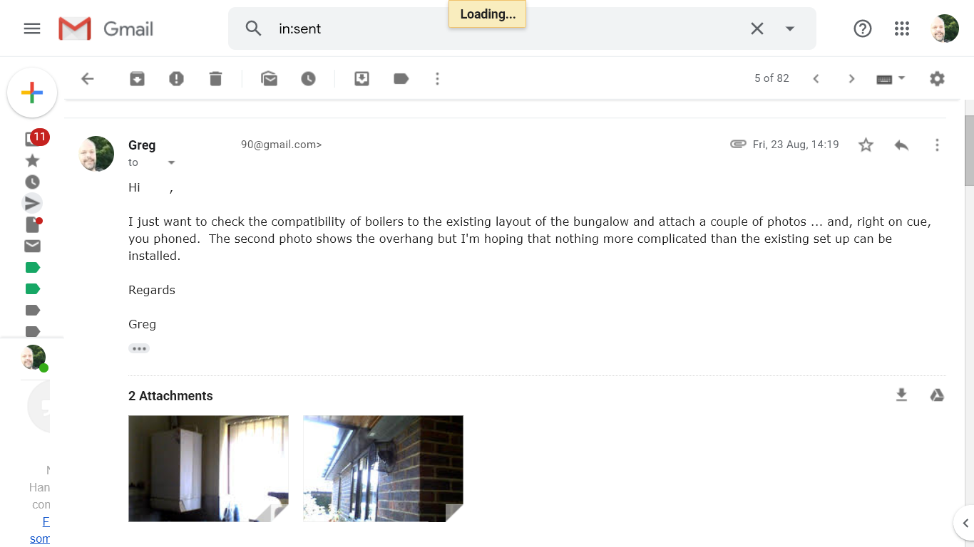

I got in contact with an, I think, large boiler replacement company requesting a quote for boiler replacement which they based on my description of the house and them viewing the google image of the property. I looked up the proposed boiler according to the description and front view picture that I found of the boiler showing the flue going directly up. All boilers that I've previously had including my previous boiler here have had the flue pipe going directly out the back. While getting ready to write an email one of the sales guys phoned to politely phone. I said that I was concerned that the boiler proposed had a verticle flue which was unsuitable and I wanted a flue that could go straight out of the back.
Following our conversation, I then felt comfortable to send this shorter than planned email in which I stated that I wanted to check "the compatibility of boilers to the existing layout of the bungalow" and I attached internal and external photos as shown.
I then got a phone call to, among other things, notify me of a plan to put a gas pipe on the (nine-meter horizontal length) of the front and entrance sides of our bungalow. I said that what I had agreed to was a replacement of the boiler and hadn't agreed to this and, in any case, there was a loft space immediately above ready for use and I was told that this was fine.

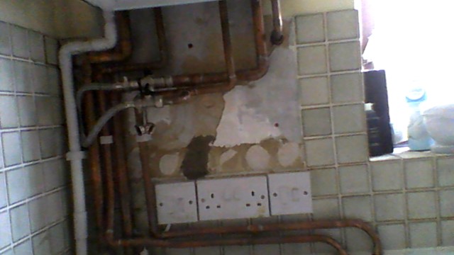

The following picture shows the current state of the installation and gives an idea of what went on previously.
Four rows of the mosaic tiles had been pulled from the wall which broke several of them, the boiler had been placed in a lower position so that its base was just above the electrical fittings, the sockets (which we use for things like the fridge) had been replaced with a blank plate, a network of pipes had been placed in front and down to the level of the countertop inhibiting cleaning and access to the electrical tittings and an additional hole had been drilled through the external wall for an unwanted external run of the gas supply.

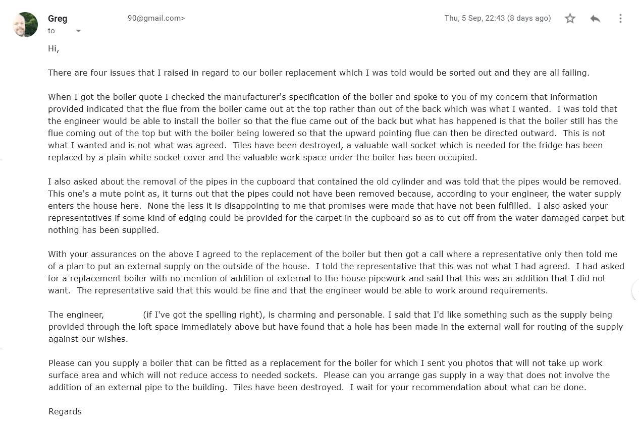

After the first day of installation I emailed the company specifying problems as mentioned
and I also phoned leaving a message, knowing that the engineer might better be able to work elsewhere rather than come down with inappropriate parts supplied, in hope that the message might be passed through in time.

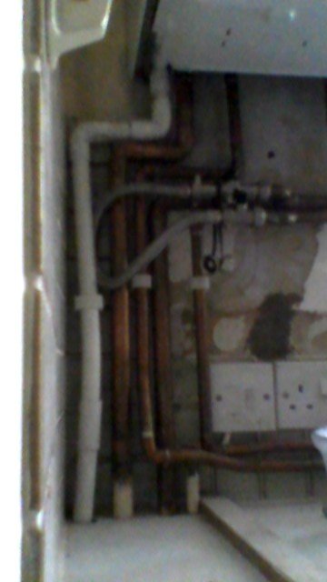

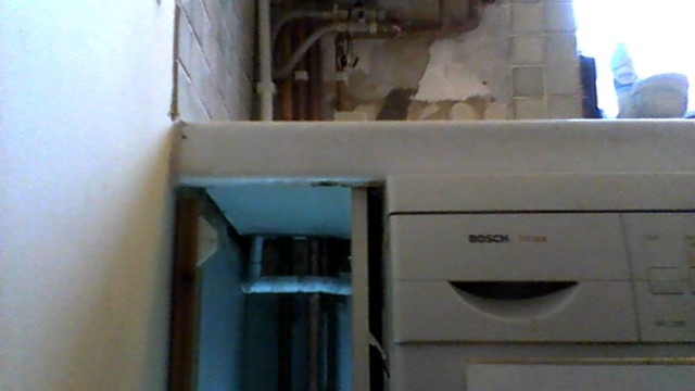

As per the below the boiler picture, pipes have been directed up through the countertop, not even in line with the boiler but to the right of it and these pipes. I asked for these pipes to be repositioned into the kitchen cupboard space that seems to have been allocated for pipe runs and plumbing. I was told along the lines of that there had already been enough difficulty installing the boiler system's magnetic water cleaner (dirty snowstorm device as I call it, slightly out of the following picture and installed at a diagonal) and that the pipes wouldn't be redirected as requested.
On review of the work, I'm also unhappy with the slanted installation of the plastic pipe and its unneccesary vertical joint and that the flexible metal mesh pipe system hadn't been installed below the countertop.
Ideally, all the pipework would be boxed in or at least in a condition from which boxing in could be practicable.
