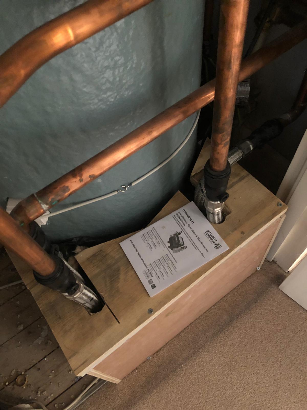

Stick some pics of the pump and pipework. If it's noisy and coming on when the toilets flushed then it sounds like a poor install.

the pump is boxed up to provide some acoustic insulation
Therein lies part of your problem TBH...

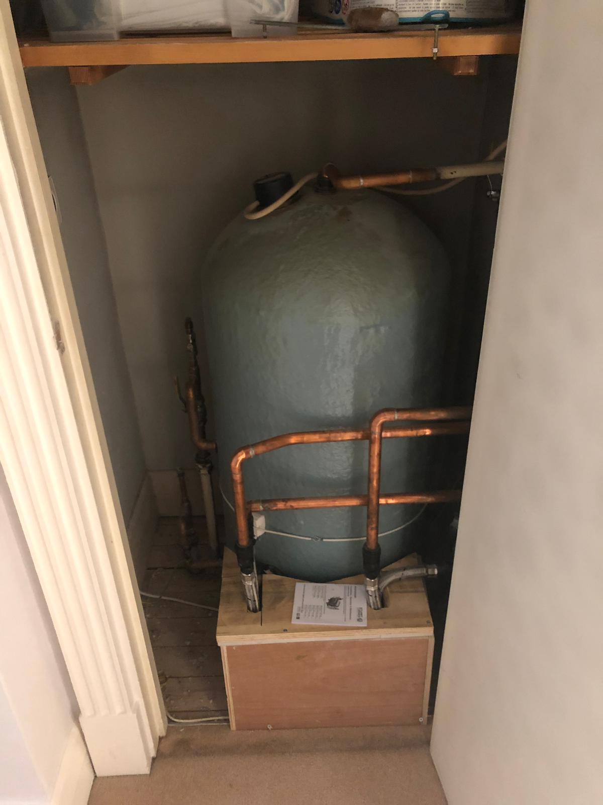

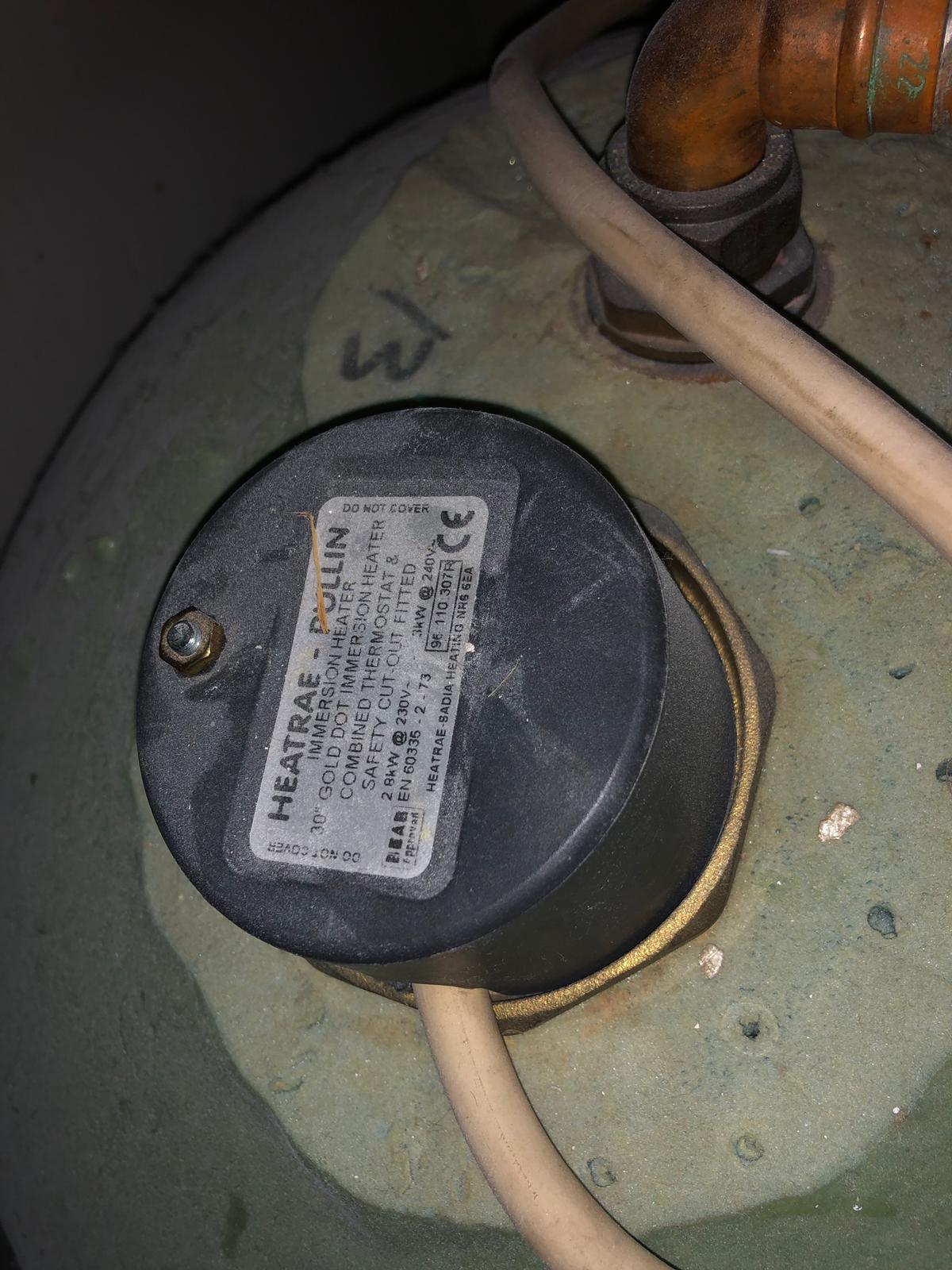

Managed to get some pictures of the existing set-up. Apologies for quality and order.

Yes, noted. When we do our extension/ renovation porject, the house will be re-plumbed throughout and the cylinder, new boiler etc will all be positioned in garage.
Using the existing airing cupboard space is a temporary measure and at the moment the cylinder thankfully only has to serve two bathrooms.
