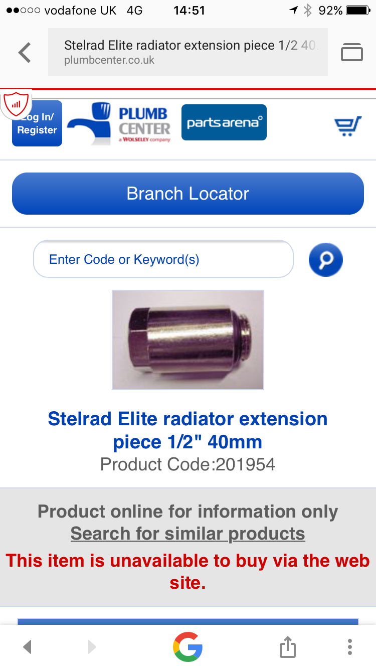

The thread on the adaptor SHOULD be a tapered thread. The adaptor should screw in, but not up to the point where there is no thread showing. If it goes that far, then there will be a leak as it won't be tight in the radiator.
Negative....these extensions have straight threads.
I did think that might cause a slight issue when buying.
I'll try tapering my ptfe ad mentioned in an earlier post.
Might try gas ptfe as thats supposed to be thicker.
