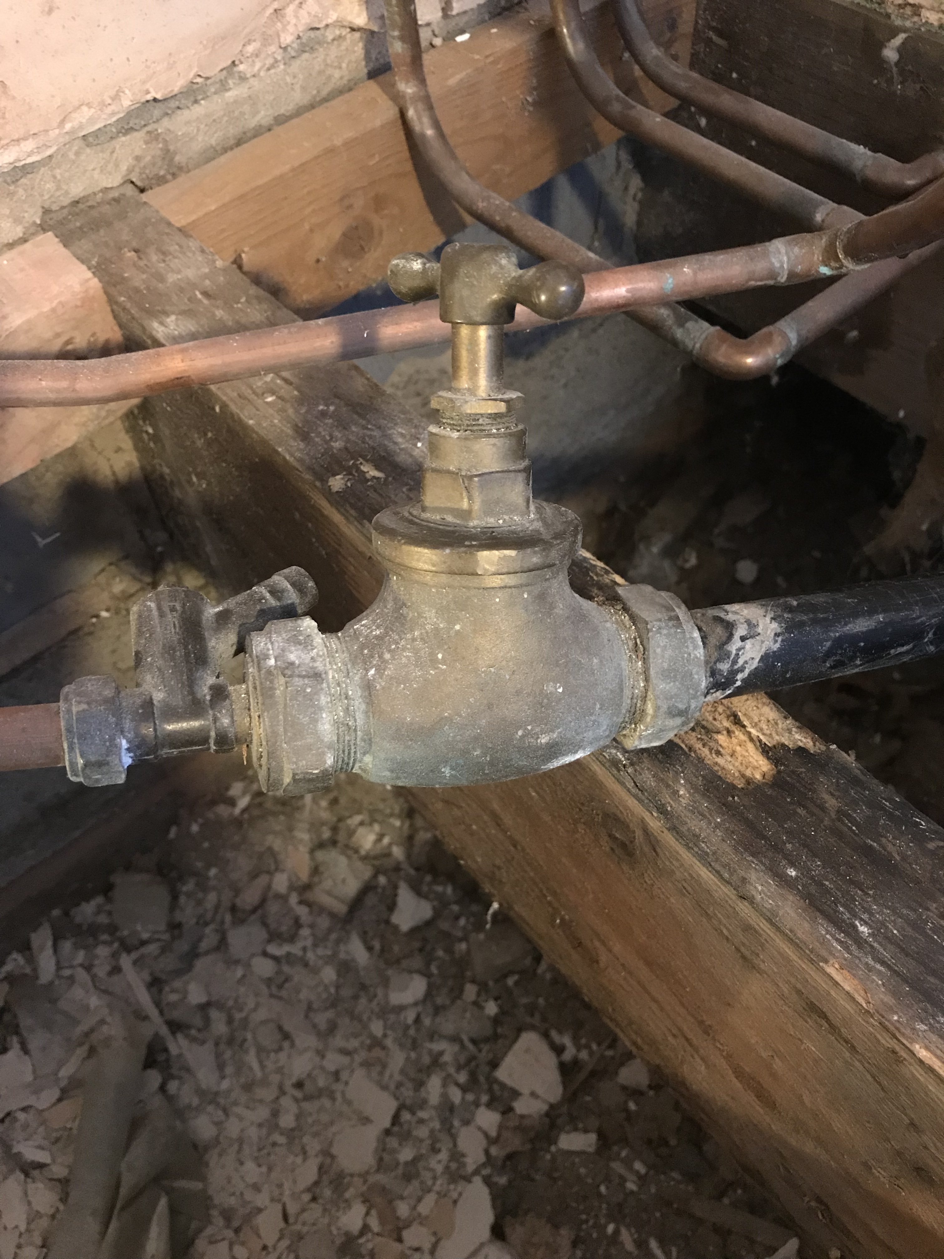

    Have a mid 1980’s house with the mains water coming in from underground via a black plastic pipe, of which the external diameter is 27mm. There does not appear to be any markings on it, but maybe some faint green.
    This goes into a 15mm copper pipe via a stop tap with compression connections. There is a slight leak and due to a new room layout I need to take apart and reconnect the black plastic pipe straight to 15mm copper pipe without the need for the tap.
    Is there a straight connector out there for connecting this 27mm black plastic pipe straight to 15mm copper pipe please?

    Imperial polly best get a transition fitting to copper
    Plasson/ philmac etc

    Philmac utc

    Thank you, will look into philmac. Is this polly stuff brittle? Should I be being very careful with it? and how’s best to cut the end off for the best joint?

    Shouldn't be brittle but be gentle with it anyway
    Don't forget an insert

    An "insert" goes inside the black pipe to strengthen the side wall to prevent it being crushed or collapsing if stretched.

    • Like Like x 2

    Ah yes I’m with you now! I guess until I take it apart I won’t know the diameter of the insert required? Although 22mm is most likely do you think?

    Yeah ShaunCorbs is correct you don't need an insert.

    Looking at Philmac now, but sooooo many fitting types I can’t work it out. The poly pipe is 27mm external diameter onto a 15mm copper pipe. Any idea which connector??

    Maybe this one, code 1143
    Products | Philmac
    What I generally do is cut a bit of the pipe off and take it with me to the wholesalers.

    15-21 x 21-27
    copper x plastic
