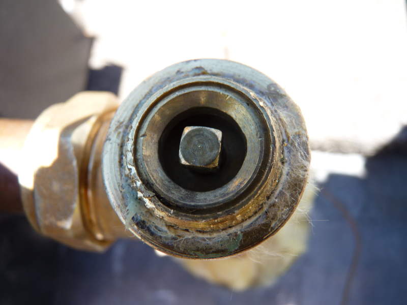

Photos of the 6918 fitted.
There's no sign of any flats, just the faintest sign of four corners (around 3/8" sq) having been started. Guess then it must be a machining error.
Even with pin out there's no sign of any square recess. Will try BES.
