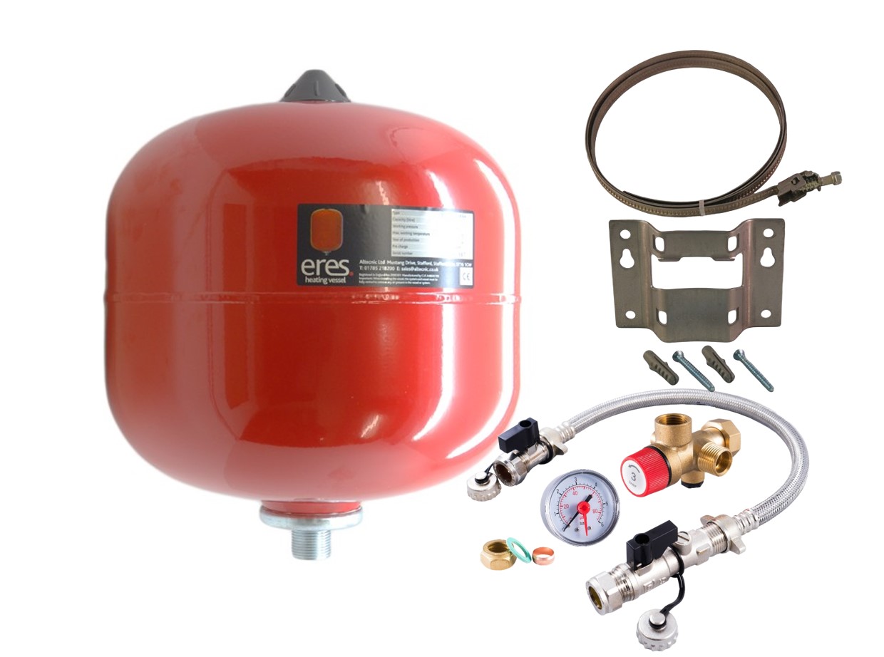

have ordered a 12litre EV and install kit to err on the safe side - plan to install it in the AC above the HW tank - directly into the lines that currently go up the wall into the loft to the expansion tank.
was very reasonable - here -
do i need anything else ?
anything i should watch out for ?
yep - the F/E pipes
i see the instructions say preferably on the return side - but doesn't say MUST - so i m hoping that is not essential
as i understand it as long as the system volume is able to expand unhindered into the vessel - then it will work correctly - and since no air can get sucked in via the vessel - that should solve the air issue
no?
It’s best for it to go onto the return but your fine if you put it on the old tank supply pipe etc
