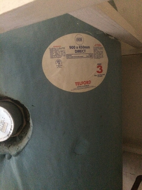

Any chance of a few pics please of the cylinder and the pipe in question
Definitely some pictures required as a vented hot water cylinders will not be mains fed
it sounds as though your unsure of what is required. Personally I think you should get a proffesional in. If something is identified incorrectly would you have the skills to rectify? Also if it is mains fed that would make it an unvented cylinder so you would need a G3 registered plumber to carry out the work by law.

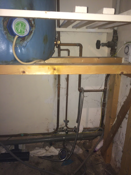

sorry for the delay in pics. Busy weekend!
White pipe is the mains coming in.
It's not 100% clear from your photo but the white mains pipe doesn't attach to the cylinder does it ? I would suggest that this pipe goes all the way up to the loft fills a cwsc and subsequently another pipe comes back down to feed to cylinder. Does this sound reasonable ??!
White pipe comes down, to stopcock, then tees off across and up to the cylinder and carrys on from the tee to the basin/bath and kitchen sink.
you have a vented cylinder there. the white pipe does come from a cistern in the loft. the "stopcock" on it is a gate valve not a stopcock. there must be a cold water cistern in the loft because it looks like there is a vent off the top of the hot feed coming from the top of the cylinder.
is your bath to the left of the cylinder? kitchen to the right?
It's an odd set up. This is a basement flat, with no access to the loft!
And yup the bath is to the left and kitchen to the right.
The white pipe doesn't come straight down either, it comes along the ceiling in the kitchen, and into the airing cupboard.
There may be a tank else where but that cylinder is not fed off the mains
