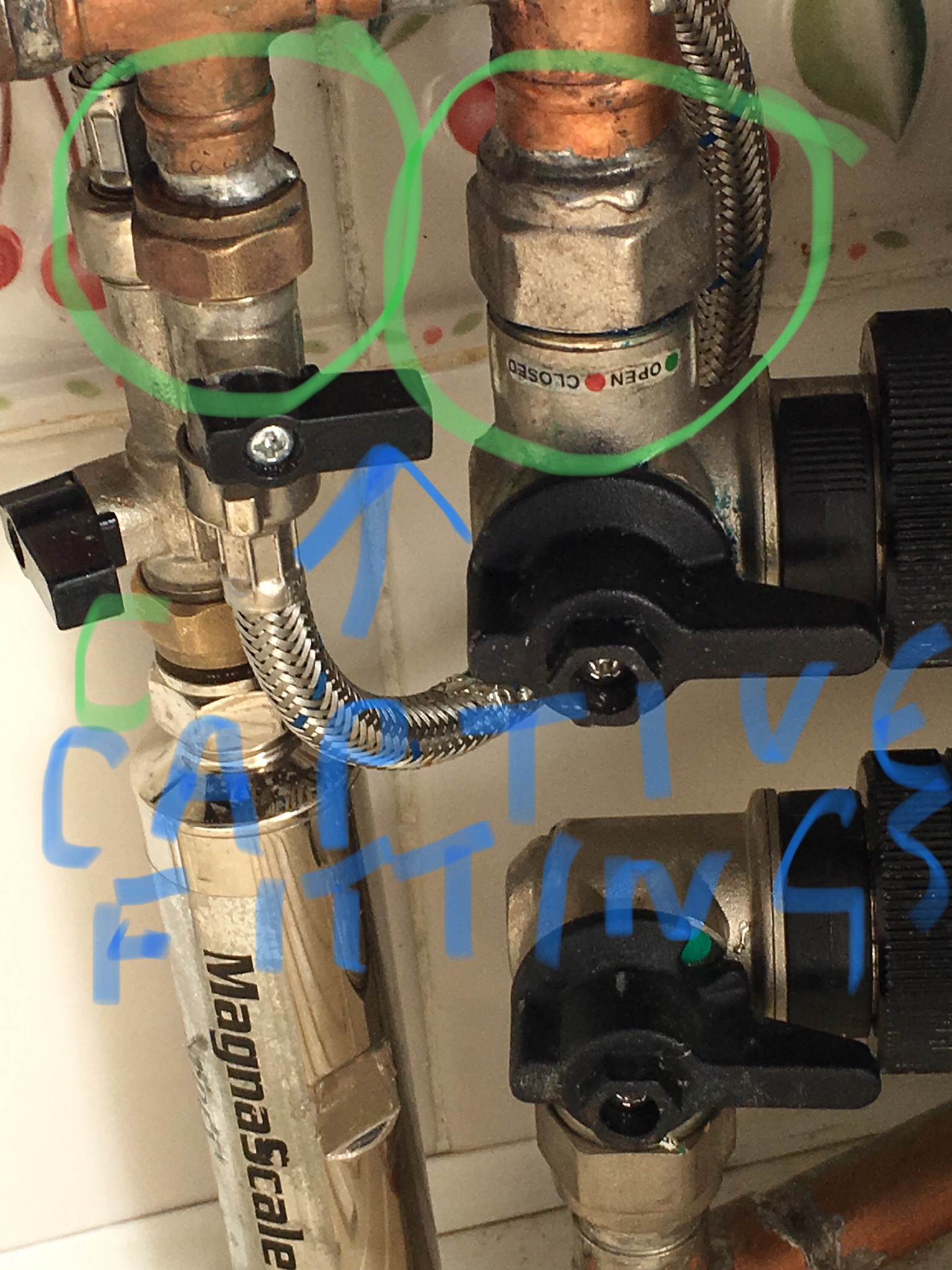

Had a replacement boiler fitted 3 days ago. National supplier who subcontracted out to a regional Plumbing Company who sub-contracted it again to a smaller firm. Fitter was Gas Safe registered but the quality of his workmanship was poor. He worked flat out but by 8.30pm he was rushing to finish. He had to adjust his own pipework again to make the magnetic and scale filters accessible. For some reason he filled the back of the upper compression fittings (one 22mm and one 15mm) with solder. Boiler was commissioned and work and he left. I didn’t notice the ‘captive’ compression fittings till the next day. Owing to the tightness against the wall it will now be impossible to replace a 15mm isolating valve that isolates the filling loop or the upper 90 degree isolator-bend that joins the magnetic filter. I have not paid the contracted firm in full yet and I have the tricky job of getting two levels of sub-contractors back through the main contractor to rectify. If at some point in future maintenance is needed on those fittings then a whole lot of costly re-Plumbing will be needed. Please send views and tell me if you think I am making too much of this. Thank you

It wouldn't be too difficult to replace the valves as they are if required, but shouldn't have been left like that.
Someone was in a rush doing that.

Yes. It is the National Supplier who my contract is with and I have made a £300 retention. Agree that 15mm valve is removable but the 22mm bend/valveI has no available turn radius to twist out of the ‘Captive’ compression joint so pipework imo would need adjusting. Never seen anything like this before.

But from a professional point of view a) Do you see this often? b) What did he achieve that nipping up wouldn’t achieve?
I don't think it's intentionally backfilled, it's just run out from the fitting above when he fed extra solder in.
The compression nut is too close to the Yorks fitting.
Ahh. Good explanation. I’ve never known an uncleaned unfluxed area to take solder like that though - it usually cracks or flakes off. But it is an explanation and it’s difficult to imagine another one. Thanks

...and why pre-soldered fittings when he has used end-feed everywhere else?
People who produce work like that often use lots of acid flux and get it everywhere. Quite possible (likely?) that flux has also run down into the compression fitting and is eating away at the olive right now. :eek:

Thanks. I knew that excess flux can rot through copper pipes but never thought of copper olives! I’m covered for faulty parts and labour by long term boiler manufacturer’s guarantee on boiler itself but these fittings won’t be covered. Do you agree that these dodgy joints need replacing properly in order to save me paying a gas-fitter in a couple of years time to do them at my own cost?
Would any plumber on this forum accept those captive compression fittings? Need to know if I am making a fuss over nothing please?
It's untidy and poor workmanship, but you likely won't need to get the nut off the magna clean anyway. So long as the valve closes, the filter is serviceable. The isolation valve to the filling loop is removable also so not really an issue. What boiler has he fitted? Hard to tell from the photos but looks like the magnetic scale reducer is just before the filling loop to the heating, if your on a combi then this is in the wrong place and if your not on a combi, it's pointless having one.

Thanks for this Craig. He was down to do a Power Magnetic flush but just did a water power flush of each rad (18! - I opened each flow in turn for him). No magnets or chemicals but I’m satisfied that all pipework and rads clear. Not a combi, a system boiler WB 30i - scale filter included in quote but agree unnecessary (as was system magnetic power-flush). He tried to avoid system flush at start by saying system water was as clean as. But I said part of spec so he was 2.5 hrs doing that (with my help) before he realised that he’d been given a combi not a system boiler (another 2 hrs gone)
Ok. Can see now I’m probs making too much of it but eg the magna-filter is tight to the wall and you can’t fit the large plastic lid removal tool on without stressing the 22mm return pipework. Also don’t those isolators occasionally fail and need replacing. Small point but as it IS a compression fitting it shouldn’t be captive with solder as someone may have to sort that out ,at my expense, in future. Thanks
