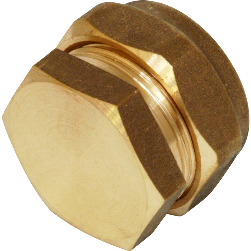

Hello, as per title I need to cap off the hot/cold feeds to the bath before I rip it out.
Its 22mm copper feeding into flexible pipe to the tap. I've just checked and my pipe cutter only does 15mm.
Given the picture below, is there a capping with a male end I could screw replace the Flexi hose with? If so...can you advise what I need to search on Screwfix to find it please 😂
Failing that I'll have to stop being cheap and get a 22mm pipe cutter. If that route, are pushfit cap ends on copper good enough for a few months?
Thanks in advance
With picture this time!
Only for temporaryuse, not for permanent use, just until you (presume fit a new bath?). If you’re capping off permanently then you need to go back as far as twice the pipe diameter, or change that tee if it feeds elsewhere in the property.
p.s. the stop ends are acceptable as permanent use in the correct manner).
If you don't mind keeping the hoses then just unscrew from taps and fit some male BSP plugs (which will act as dummy tap). Otherwise cutters are cheap and you can just fit some push fit caps after cutting. Turn the supply on gently and hold the caps on for first time you put the supply back on (easier with a friend).
Good luck, and take care.
Cheers,
Roy
Only for temporaryuse, not for permanent use, just until you (presume fit a new bath?). If you’re capping off permanently then you needto go back as far as twice the pipe diameter, or change that tee if it feeds elsewhere in the property.
Perfect thank you and yes only until I rip out rest of bathroom and put it all back together, few months tops.
Cheers,
Roy
Great, looks like I've got a few options now, many thanks!
