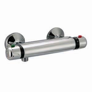

I'm really hoping that you'll be able to help me fix what I think is a really simple and minor issue that nonetheless is really bugging my family and me.
The problem is stemming from the shower. It's a mixer type that comes from the wall - almost identical to this one below Thermostatic-Shower-Mixer-LH2205-.jpg

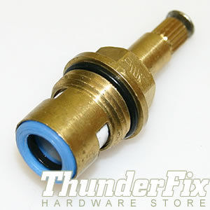

So, recently when we turn on taps around the house (and sometimes the toilet and sometimes just out of the blue) a horrible screeching/banging noise which is pretty loud comes from the left hand bit, together with water dripping from the shower head. If I press or wiggle the bit that turns to turn the shower on/off it stops it. I had a go taking it apart and finally came to something that looked like this:
I replaced the o-ring, thinking that maybe it was faulty and also put a new hose and shower head on. I made sure that everything was REALLY tight when I secured it all on, but it's worse than ever?

Alternatively, just changing the shower valve (around £50 or so from Screwfix) is more likely to cure the problem!

So the shower valve - is that the thing that I've posted a picture of? If so I'll get onto Screwfix now!
You could try changing the shower valve. I talk as a plumber and the hassle it is to try and change a part that is not economical hence talking about changing the whole bar.
As a plumber you visit to see the problem and see what might be needed. Then spend a while looking for the correct cartridge. Return for the second visit to fit the cartridge. Find it doesn't work so talk about changing the bar. Spend another while looking for a valve for a reasonable bar. Then another visit (third!) to change the bar. Three visits, one part, one bar and how much can you charge to cover all your costs? Not enough as the customer will complain that he might have been able to change everything himself for much less! Customer won't be too happy paying for the cartridge because it was found not to work so who pays?
If you're tackling the job on your own, then try looking for that cartridge and change it. Or save a whole load of time and change the bar.

B&Q are selling a thermostatic bar mixer for £60 as part of their Easter sale. Comes complete with new shower head and hose too. New shower would be cheaper than a repair. At that price you can afford to get someone in to fit it too!
wopw thanks to you all so much for the advice - think I'll buy a new shower bar itself - there's a local cheap corner shop that'll prob do them but they're about £50odd online/
tool station do a complete thermostatic bar and rail set up for £38..:deal:
