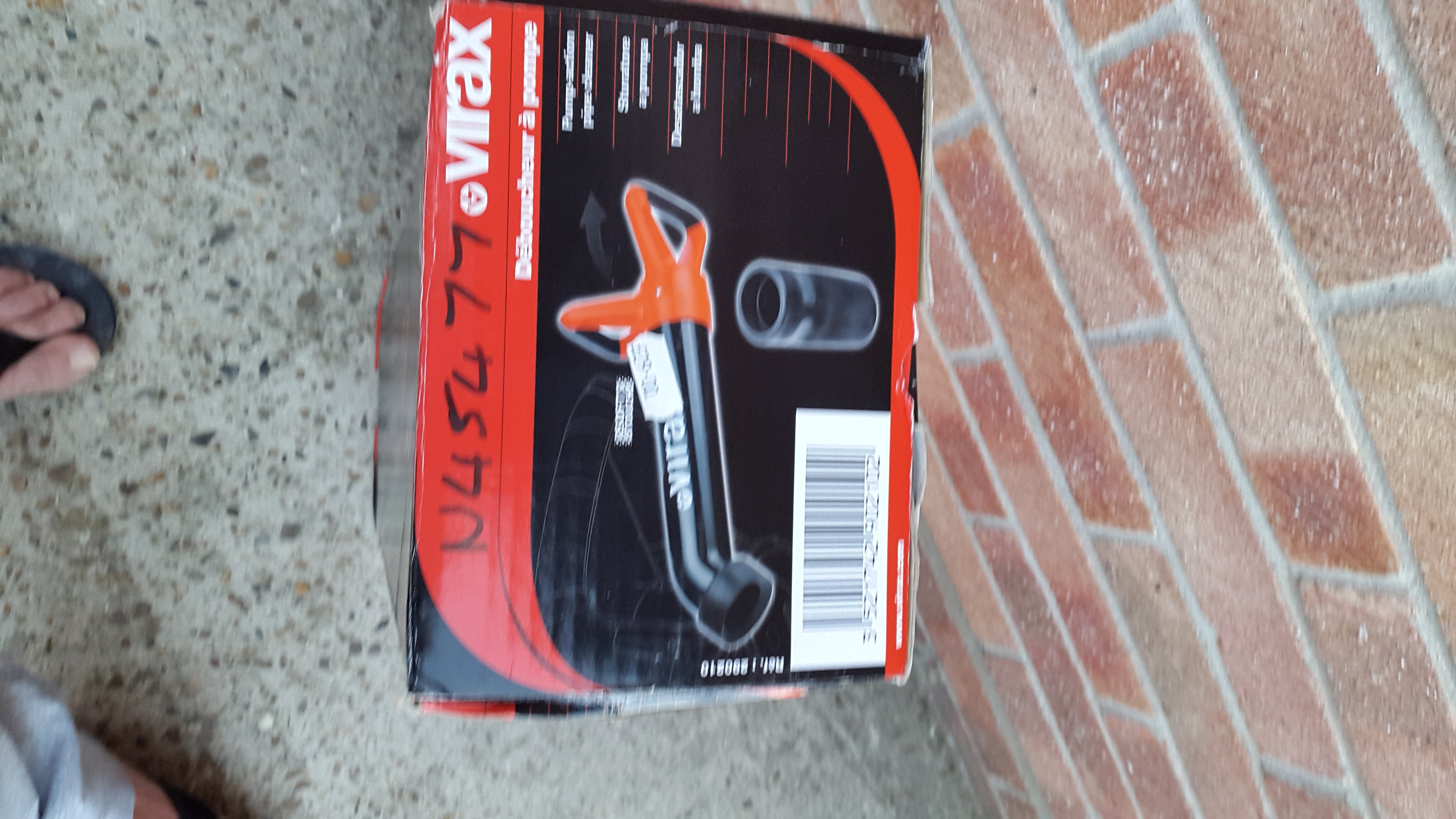

This what you need town got em on offer at plumbcentre £29 + vat add to the job cheers kop
