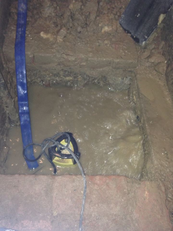

I then rigged the compressor up with the meter end blanked off and high pressure tested it. The patio outside started bubbling when I threw the lever valve. So tomorrow I'll have the apprentice dig it up and go from there. Cheers for the replies everyone.
So the lad dug it out today, and as fast as he could dig the hole filled up with water!
Got the pump and cleared it out. Found the problem. Leaking joint. I'm amazed it hasn't become a problem sooner. I'll be cutting the leaking joint out tomorrow.

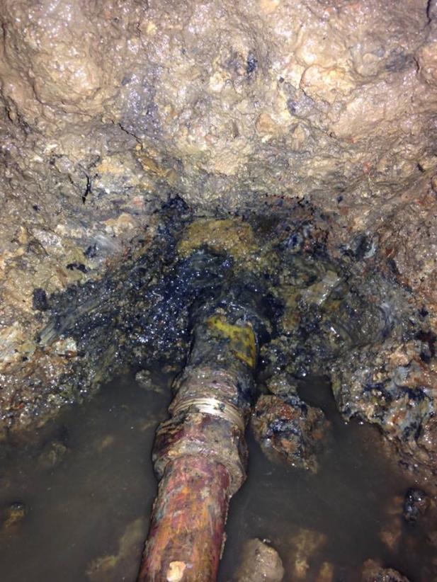

It's a piece of yellow MDPE stuffed into a 28mm compression fitting, with epoxy resin squidged around it.
We need to dig further away from the joint so I can cut the pipe and put a proper union in. Shocked. It was peeing out gas.
1009987_10151869065736744_1828153221_n.jpg1016569_10151869066356744_1653303618_n.jpgThe bubbles in picture one are with the compressor attached, not bubbles from the pump. It looked like a jacuzzi.
Must have been leaking a while. When we removed the dodgy joint I found a 28mm compression coupling stuffed into the 32mm mdpe gas pipe. Then some epoxy resin had been smushed around it. What a cowboy.
