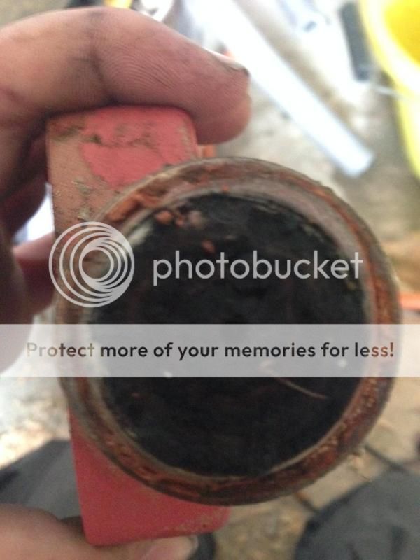

Checked the gauze on return today which was clear, boiler is still not working correctly on CH, or HW now either!
on CH from cold, boiler fires up, goes onto full burner but then immediately drops down to a low flame, the temp dial on the front panel shoots up to 80 within seconds and flow pipe is red hot, literally within 10 seconds
With demand on HW boiler fires up and stays on full burner for bout 1min - boiler temp shoots up to 80 then boiler shuts down - the HW outlets are just luke warm through out this process with the odd surge of hot water.
on both HW & CH they repeat this process a few times then fault out on high limit stat..
do you think I could have a blockage in primary Heat ex or diverter valve?
