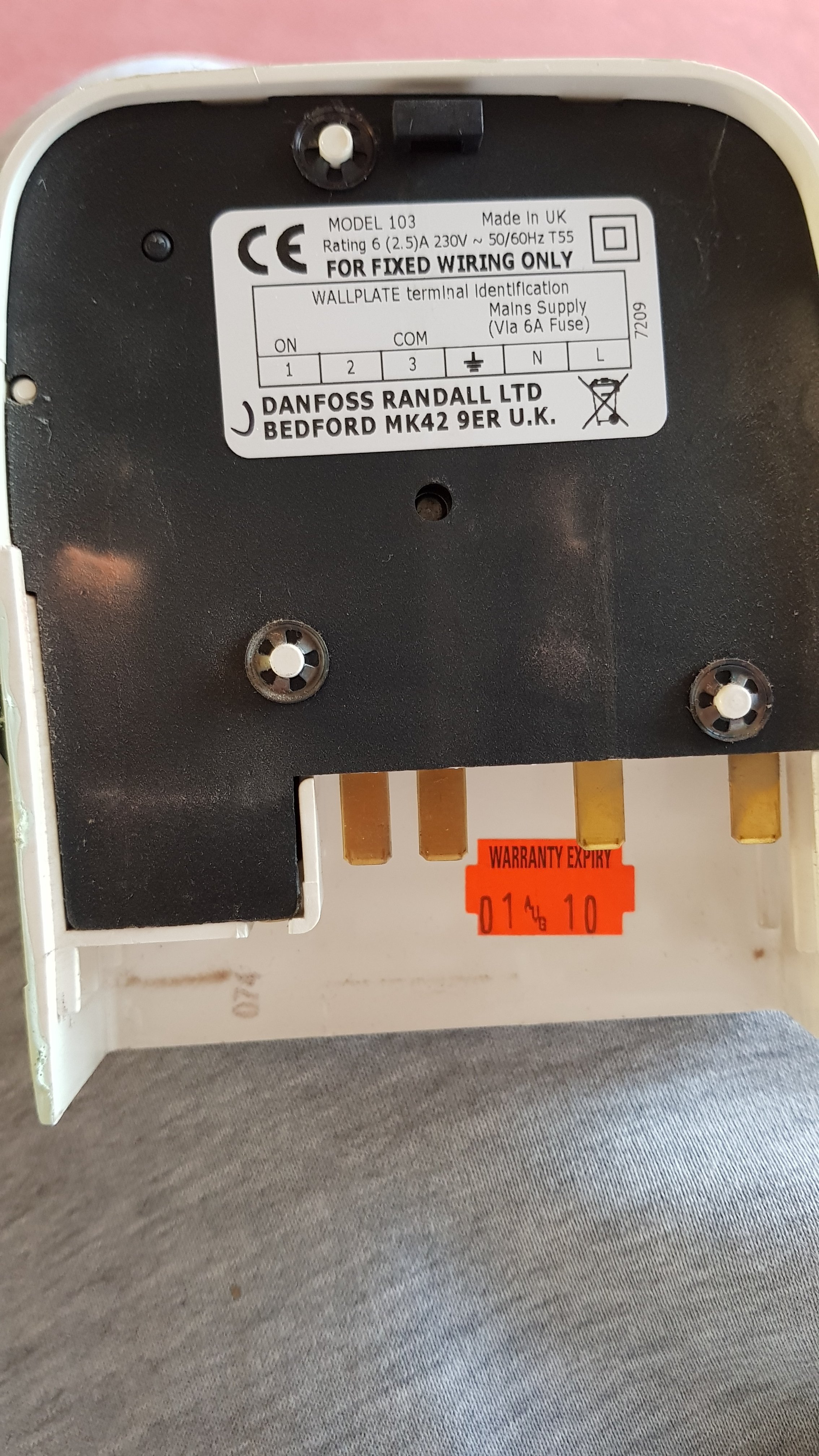

I really good do with some help in wiring a TR1 2 wire thermostat to my trusty old Danfoss 103 heating timer.

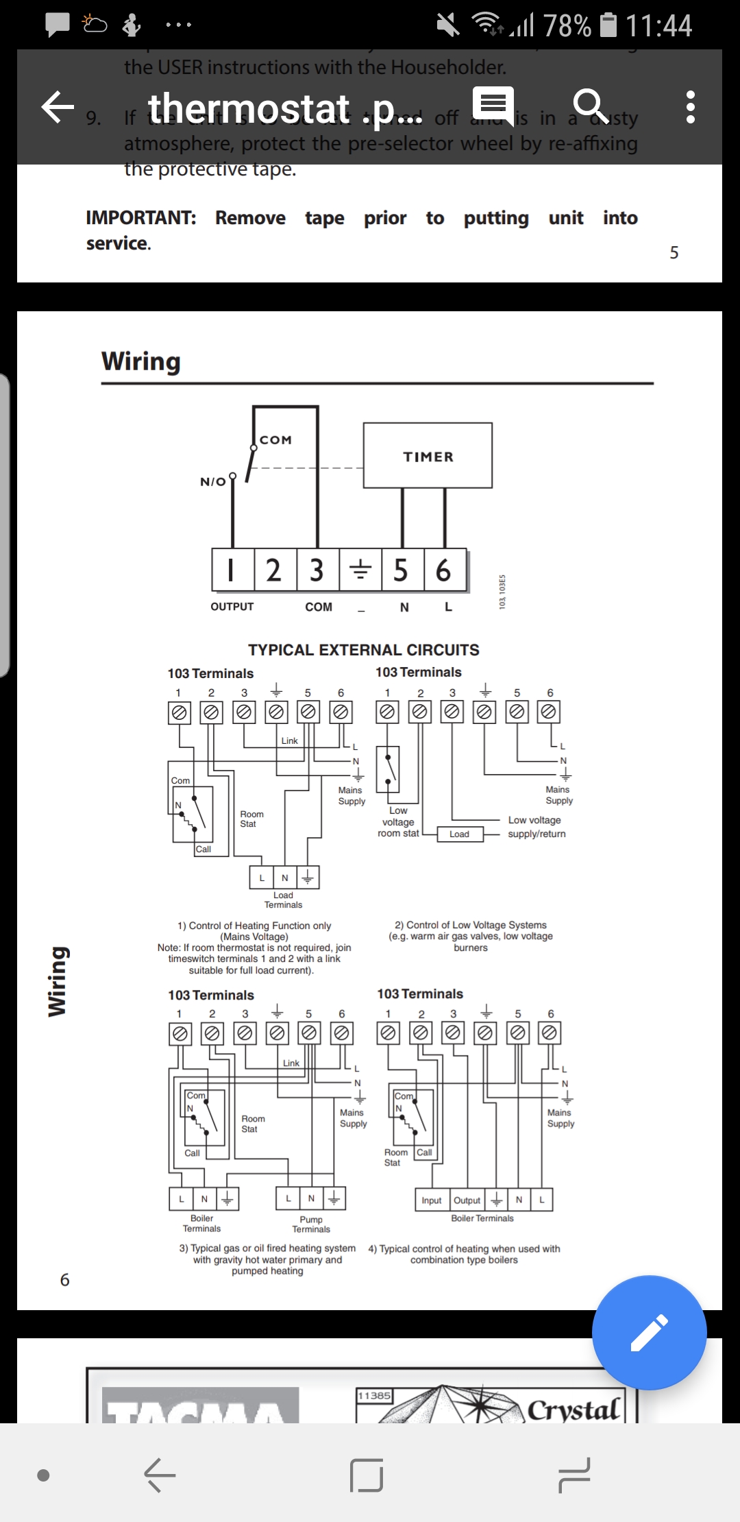

All I need to know is which connections from the timer to the thermostat do I need to wire together? So I can use both the timer and the thermostat together. I thought this would be a simple 5 minute job as I have done before with electrical jobs but the wiring in the back of the timer doesn't seem to match with any of the wiring diagrams.

In short
n from the timer to the stat
N to 2 stat
From timer disconnect white wire in 1
Timer 1 to stat 1
White wire to 3 stat
Earth to earth
Hope this helps if your unsure of anything best leave it to a pro
Eg left of 2 on the stat test middle of 3 and 5 on the timer
