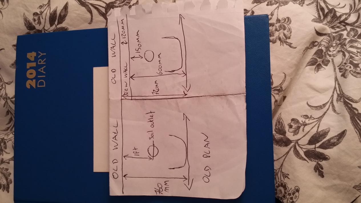

The waste outlet is 1ft away from the back wall. Is there any chance? I will build a box 150mm deep for the concealed cistern so need a toilet that has the pan connection quite far back. I believe I have managed to do it once by swan necking a flexi but not sure if it's just an imagination.
I am not wanting to dig out the floor to alter and connect on to the clay.
