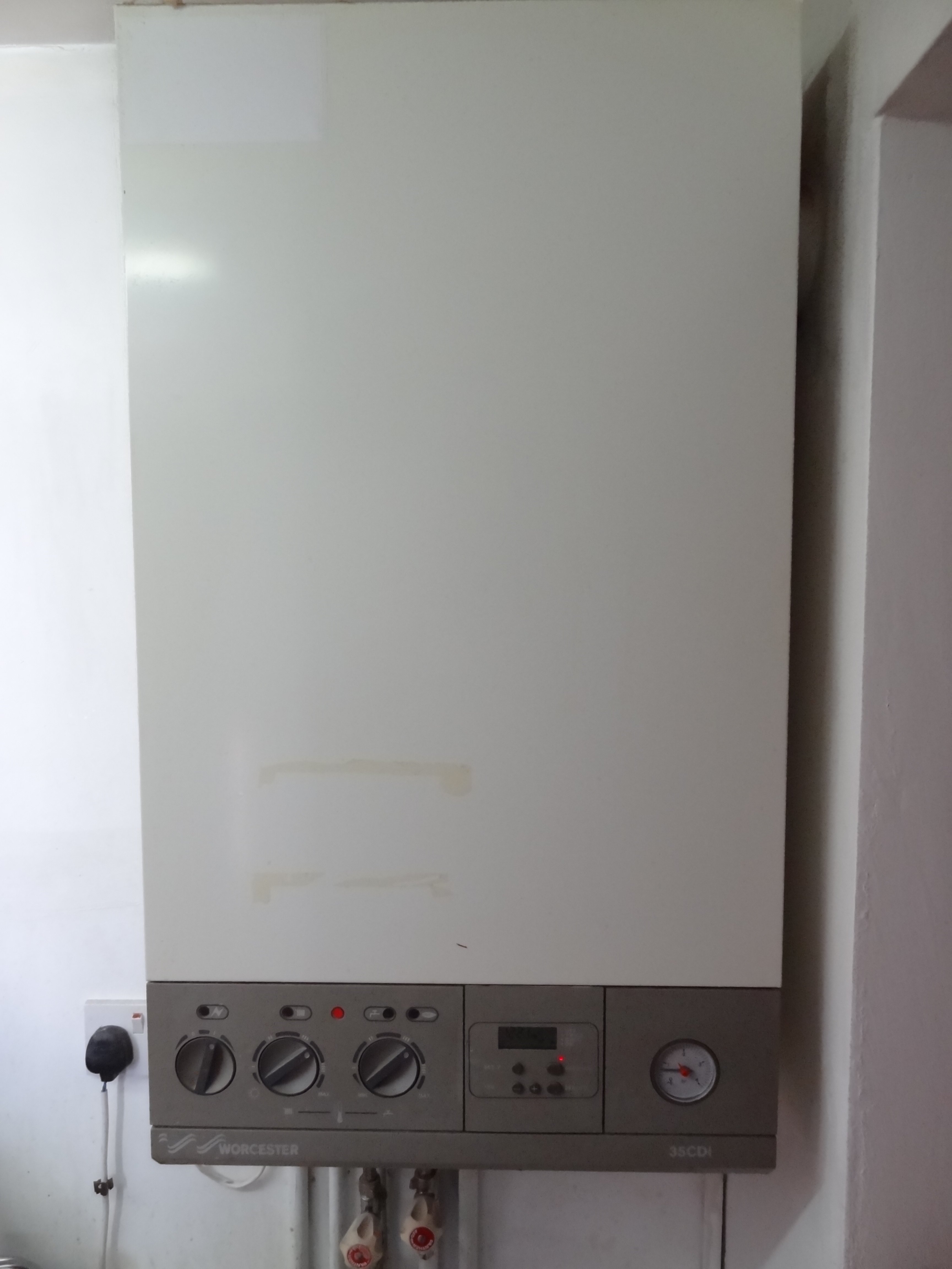

Hi All,
We may need to replace our boiler - the OLDER version Worcester Bosch 35Cdi (see images attached)
  1. Our home is a 1920's Semi
  2. 5 Bedrooms
  3. 2 Bathrooms
  4. 5 x Large (1800mm) Double Panel Radiators
  5. 1 x Large (1800mm) Single Panel Radiator
  6. 3 x Medium (1400mm) Double Panel Radiators
  7. 2 x Short Height Double Panel 1400mm Radiators
  8. 3 x Bathroom Towel Radiators
We had a WB Engineer come round to try & fix the boiler but said parts were no longer available & recommended that we upgrade to the 42Cdi - he said this model will allow use to run as many hot water devices as we wish without one area losing out over another.
After he left, the boiler started leaking again so another WB Engineer came round & he was strongly recommending the 29Cdi Classic (insisted that we choose the Classic version).
Both are highly trained WB Professionals who know their stuff but I am a bit confused as to which one to believe since they both recommended two very different models so am wondering if anyone here can really help me out on which from the WB range is really best for our home?
I was surprised that the 2nd Engineer strongly recommended a much smaller capacity model than the one we currently have as from what little I know, is that one has to either maintain the size you have to ensure good performance or go for as bigger/next model up to allow fro extra headroom so the boiler does not have to work as hard? I may be totally wrong on this as I am a novice hence coming here for advice.
The 1st Engineer may have recommended the 42CDi as he believed that would service the size of our home best & the 2nd one might have recommended the 29Cdi instead as it has been over 15 years since we have had our current boiler & advances in boiler technology in this time might mean that these days a smaller capacity boiler may well be able to do the same job as a bigger one from yester-year - I do not know but I do believe Engineers were being sincere with their advice.
Please can anyone recommend ANY Combi Boiler from the WB Range that would best suit our needs? I do not know how boiler size & capacity affects things like energy use & how it affects bills - I do not want a small boiler that takes longer to do things & hence uses more energy meaning more running & energy costs but am worried that the same might then also apply to getting a much bigger one - i.e. - it uses more energy than actually needed, hence higher costs etc?
Flow rate is important since we have two bathrooms - my kitchen tap delivers about 17L/min & the 29Cdi delivers about 11L/min & the 42Cdi 16L/min if that has any bearing?
Finally, I read somewhere that if one has two bathrooms and/or a bigger property, instead of a Combi Boiler, one should also consider a System Boiler? I have no idea what the latter is & not being technical, get somewhat bemused by all this so can anyone explain what they are & if they might be a better option for us?
Would really welcome & be exceptionally grateful for any help/advice on which WB Boiler is best for our home!
Many Kind Thanks,
Bazzy.

Hi All,
  2. 5 Bedrooms
  3. 2 Bathrooms
Many Kind Thanks,
Bazzy.
View attachment 35828 View attachment 35829
