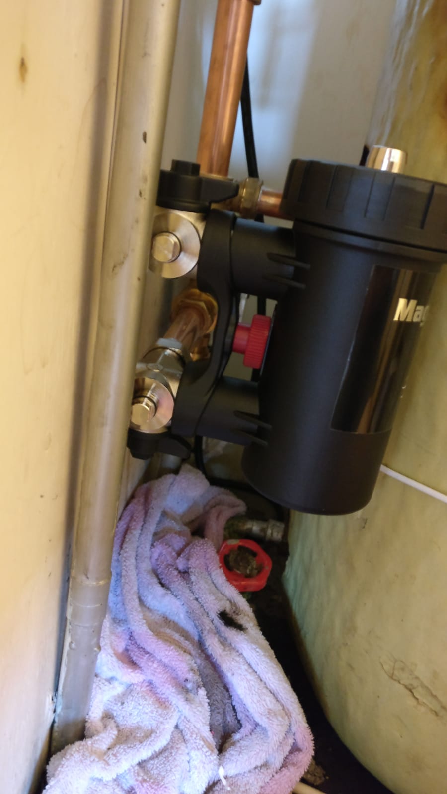

This is when i also added a Magiclean filter to the system, on the pipe between outlet of the pump and diverter valve. I bought 2m of pipe and ended up with 1.3m left, only used around 30cm but there was a lot of trial and error with fitting due to very tight space. This thing is working a treat, up to now it has cleaned a good amount (nothing compared to what i manually flushed out, it would have taken months of cleaning for the filter to do the same job if at all)

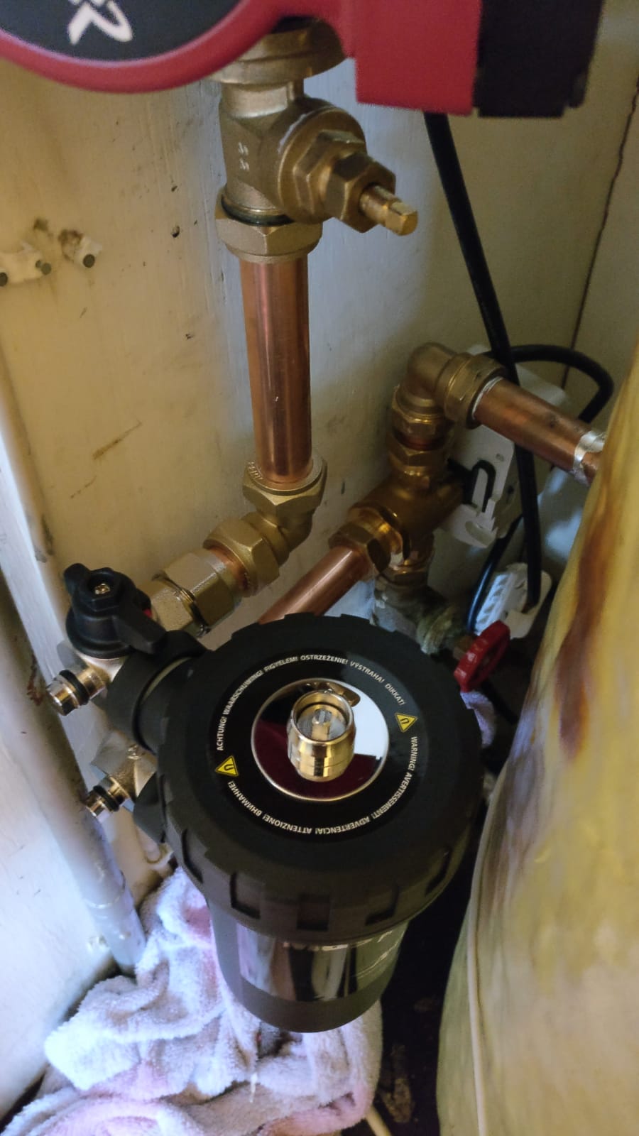

Unfortunatly any further back or to the side and everything is covered by the pump and filter or cylinder.
No that's better. From your first image it only looked like there was two pipes coming from below, when there is 3. Cylinder return is correct, have you tried closing the gate valve on the cylinder, (The red one on the 15mm pipe) when turning off all the rads upstairs. There's a chance the MV isn't closing on HW or sneaking round the HW circuit when you're trying to force the heat downstairs.
Also bogrodders advice of installing an auto air vent would help vent any air from the coil.

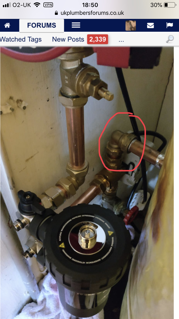

So if you start from the front working to the back with the pipes along the wall you've got,
1) Return to boiler (The tee is the cylinder return)
2) Flow from boiler
3) Return from rads (22mm coming up from floor elbowing across)
4) Flow to rads (The one with the red arrow pointing down)

Ahh makes perfect sense, i assumed the return from the rads would be under the floor somewhere, spot on thanks :)
