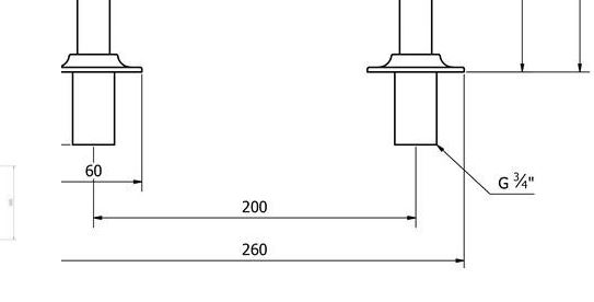

Do you mean these sort of things Elod Traditional Bath Shower Mixer Tap | Furniture123

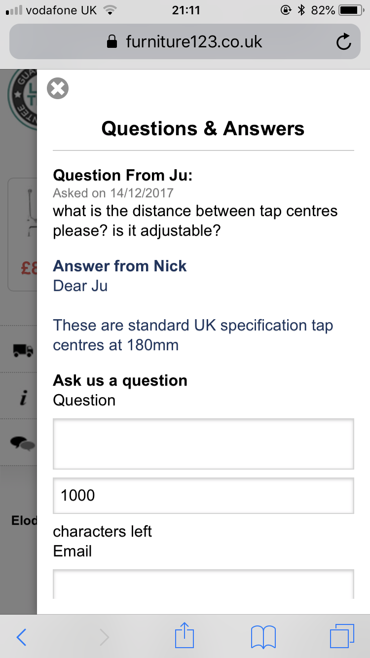

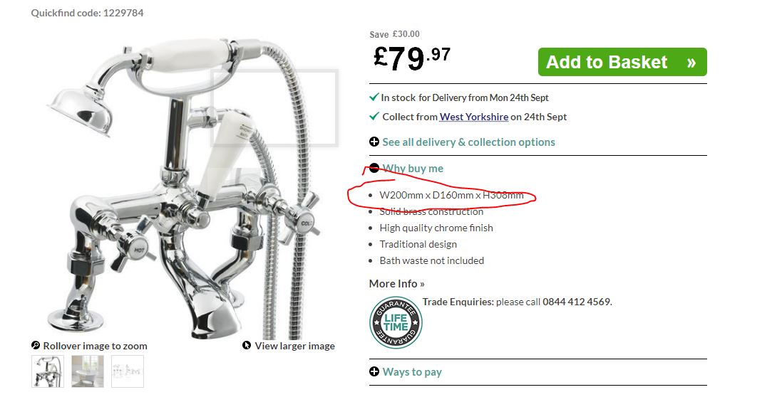

It says 200mm in the dimension picture? they also look like they can rotate?
Yeah that kind of put me off but I may risk it as that is just a reply when the main description says 200mm and the image looks like it has riser that will rotate to the 190mm I am after.

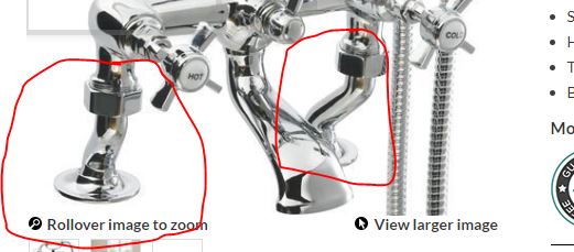

Those are slightly different than the usual 2 part leg bath mixers I was thinking of, but that might still do the job.
The offset legs will swivel 5 mm each side I guess.
