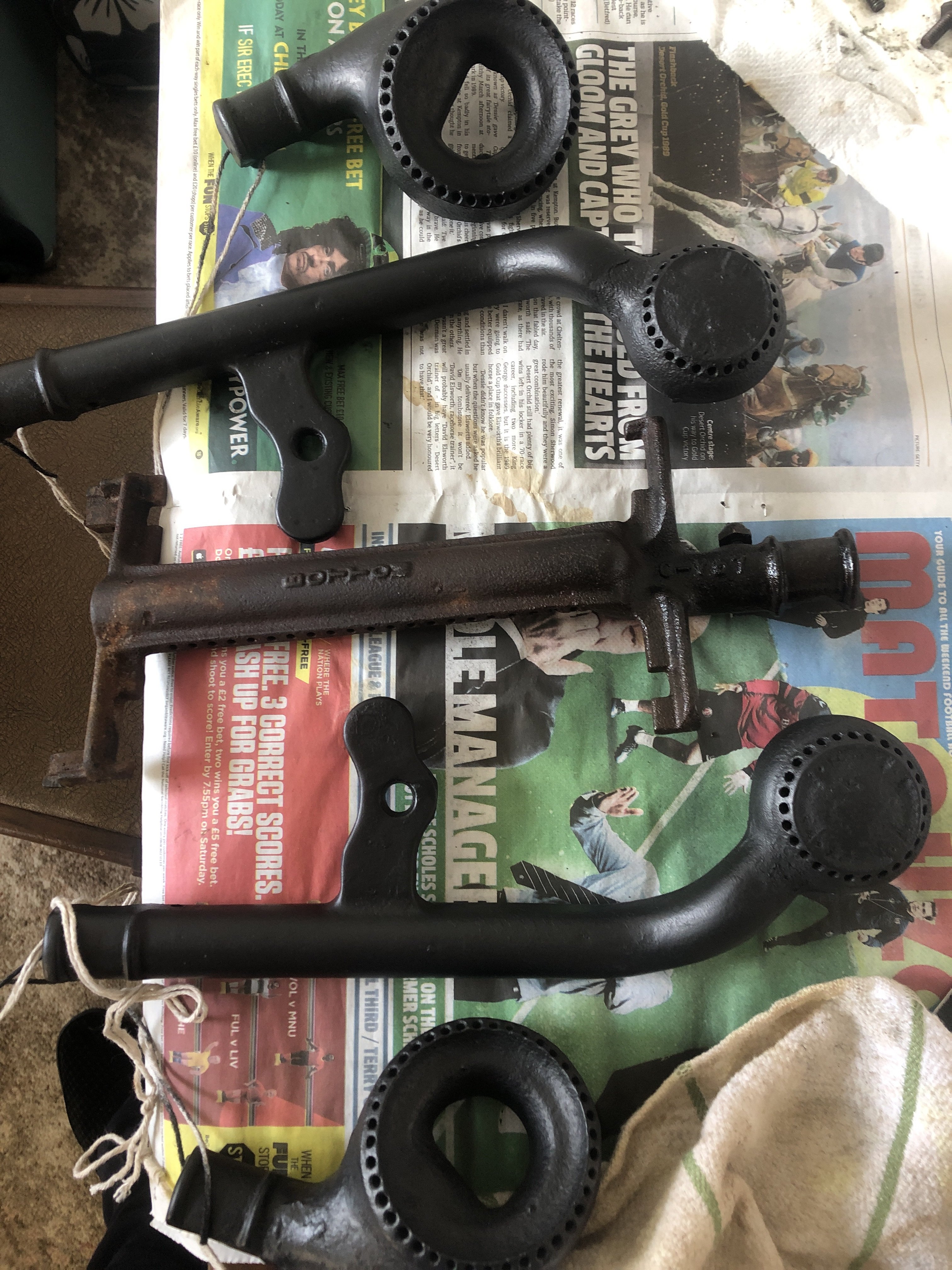

I have noticed while restoring it, that there seems to be something missing and I cannot put my finger on it and I was wondering if anyone here might have some idea? I have attached a photo of the cooker in question and the problem I have, there are 4 burners and 1 toaster which has the same problem so I am missing 5 of them (whatever “them” are), I would be grateful to hear from anyone who may be able to help or assist me.

Don’t know if this helps but looks like injectors going into the steel inserts in the pictures but missing the burner heads and crowns, on the actual hob, which should sit on top of them to spread the heat evenly.

Thank you for your reply, I have just taken a photograph of the burners for the hob, but something looks like it is missing between the burners and the injectors. I have also taken a photo of the underside of one of the burners so you can get a feel for them using these photos and the others previously posted.

Here are some more photos of the cooker, I have taken some more photos of what I think the problem area is, as I am new to this, is there supposed to be that gap between the injector and the burners/heads or is there something missing?

The gap is supposed to be there, it is designed to allow the correct amount of air into the mixing tube to maintain the correct gas/air ratio to allow the gas to burn effeiciently, clean and safe. The threaded dome nut you see in the left side of the mixing tube just upstream from the injector is for the GSR to regulate the air flow to maintain a good flame picture emitting from the burner.

Thank you kindly, the photograph of the middle burner is the toaster burner and the gas holes are in the side of the piece rather than the top. Thank you for the reply, it seems that my worrying was for nothing, I was a little worried than something may have been missing but it all seems ok then? Thank you.

BTW, the technical term for the gap is “aeration port”.

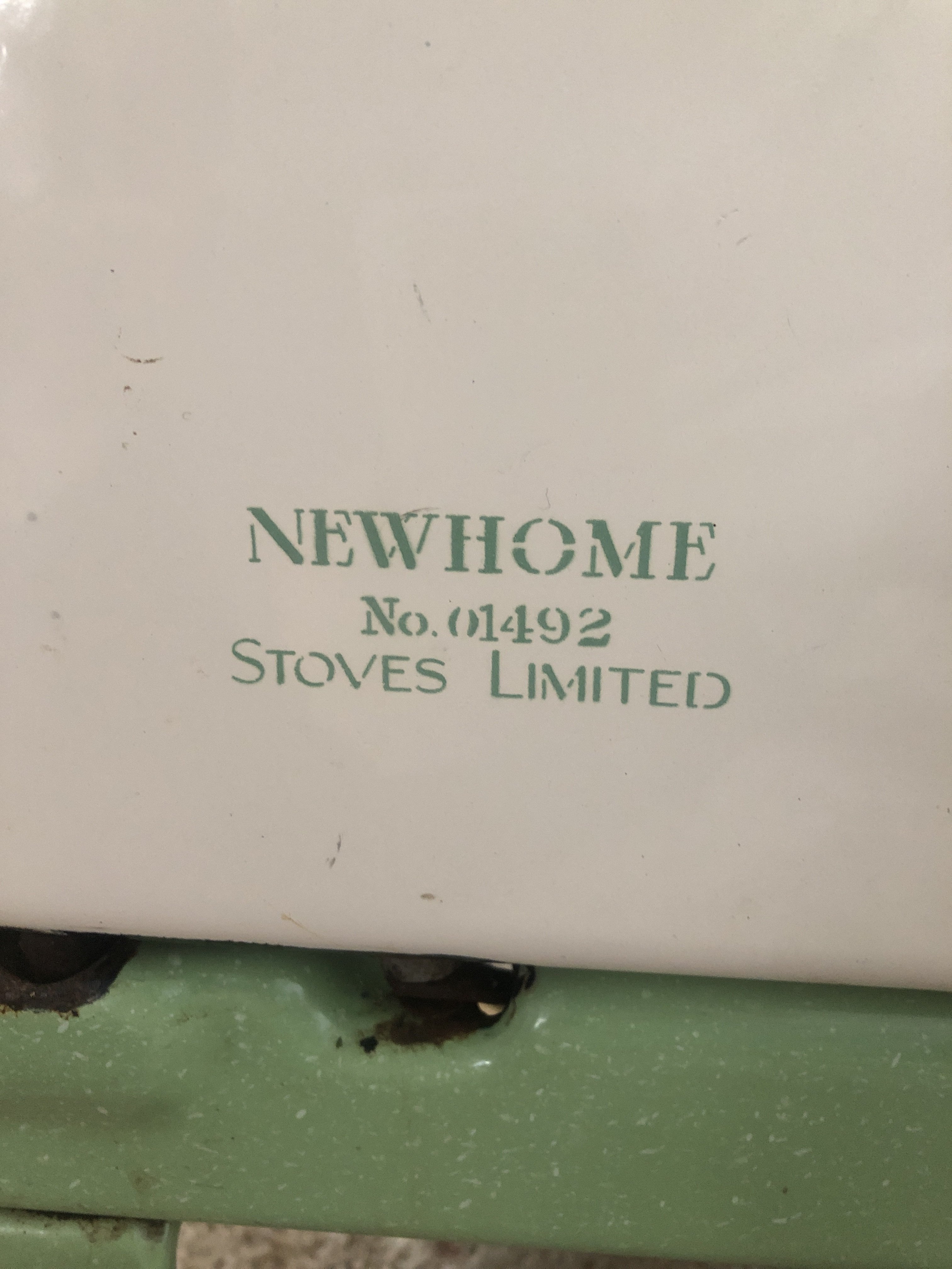

It is not New Home, but Newhome. I remember them as Valor Newhome, so did a bit of Googling. Have a look at this, I suspect you have not seen it:
Our Heritage - Stoves
EDIT: Having had a closer look at your image, it does say NEW HOME. This obviously pre dates the Stoves Era, and it may be that Stoves took over the company making Newhome, and used that as a model name. Stoves eventually were taken over ny Valor, bit in the 80's (?) became a autonomous company again.

Thank you, having another closer look my end you might be right about it being Newhome, here is a photo. I shall check out the link and look at the museum online to see if they are able to help in some way.

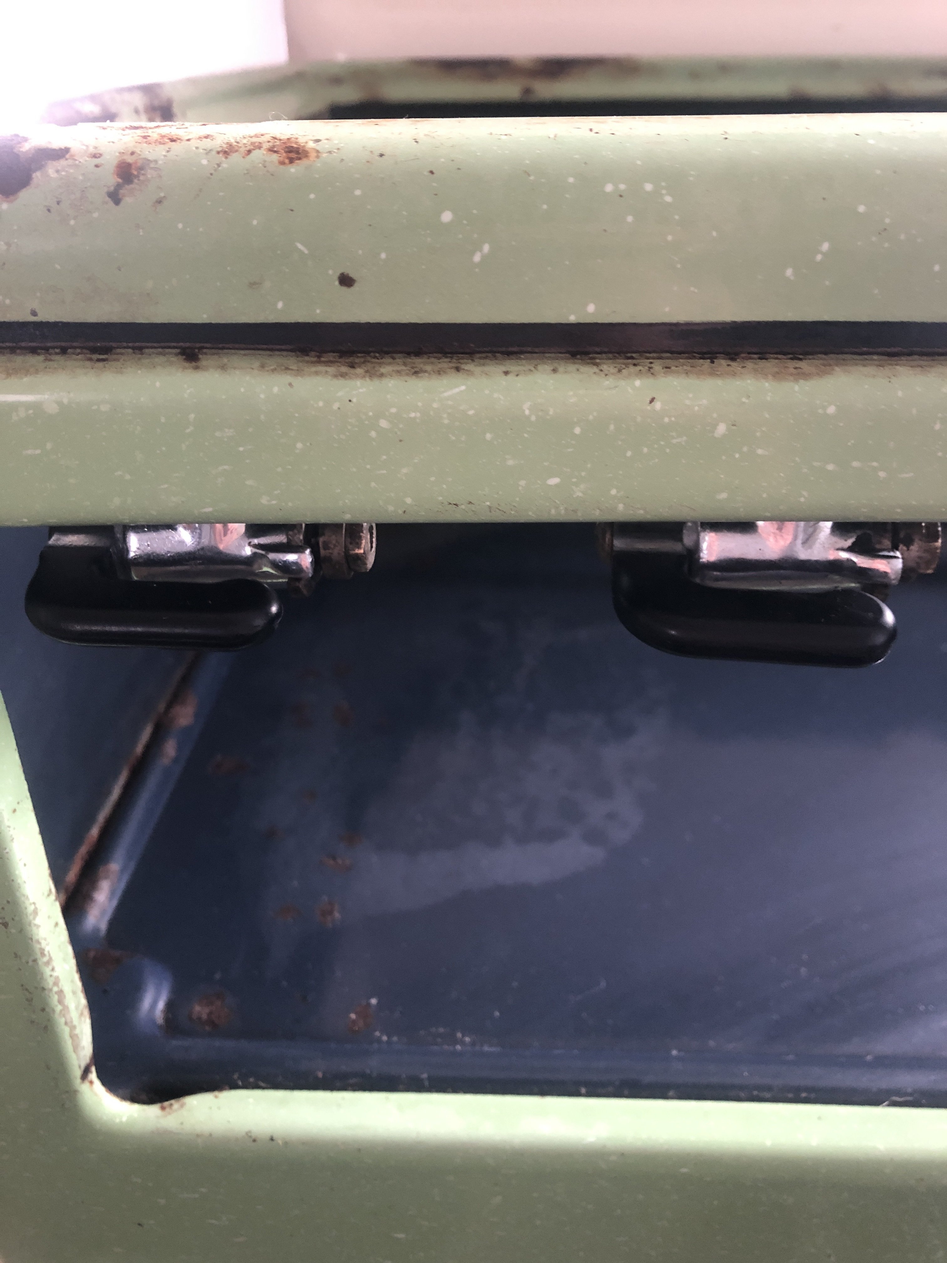

The reason I have been saying it is 1940’s-early 1950’s is because of the gas taps rather than knobs like on most modern cookers (photo attached)

from the look of the taps i would say most likeley 1940's possibley early 50's even as an apprentice i started in 1973 i was on special services at BGNW and every monday was C day where the new cookers were installed on changeover day. i can honestly say i have seen some old cookers but never one like that they tended to have bakelite handles. either white or black.

Ah. That is a better photo, and supports what I thought and said. And the manufacturer is Stoves, the model Newhome.
Will be interesting to hear what you eventually unearth.
