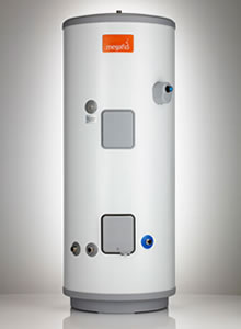

Look up unvented cylinder and system/heat only boiler. Unvented cylinder will allow mains pressure balanced hot & cold water at every outlet. Best solution for you all round if your mains flow and pressure are up to it. No loft tanks unless that's where you decide to site the cylinder
If we are talking of a tank in the attic then we got rid 22yrs ago or are there other options
cylinder
