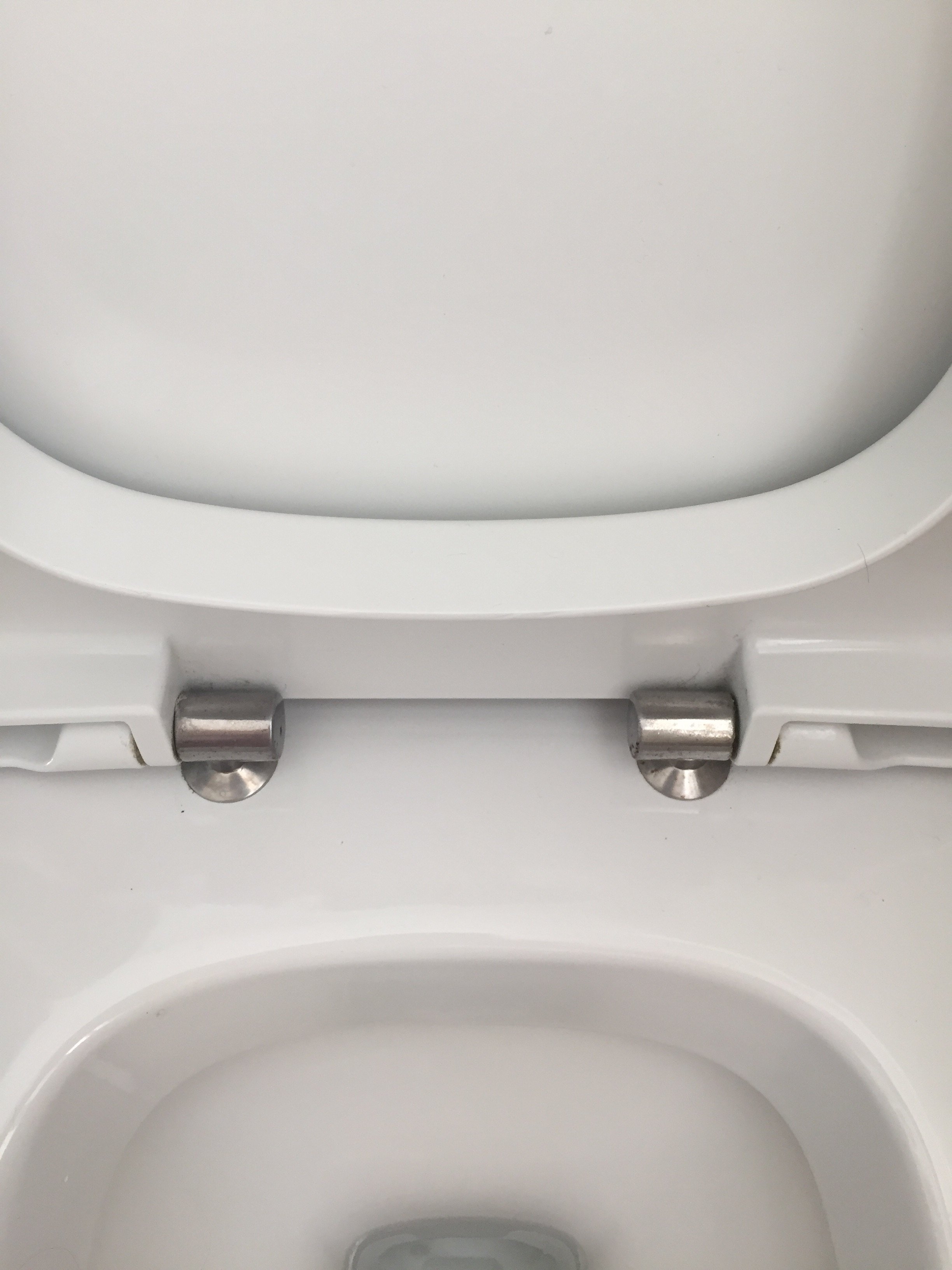

my soft close lid and seat are loose and no longer soft close. I cannot see a bolt or button to release them...
There is no hole for an Allen key or any kind of release mechanism. It’s a wall hung toilet.
Underneath the seat there are no bolts/screws visible.
Help!

Try the grey ends on the each side of the chrome hinges, they are buttons or covers that allow the seat to be lifted clear.
either it justs lifts up of the bottom pegs it is secured o'rings on the bottom fixings or the chrome covers slide off thats my best guess
Thanks for your reply. I have tried pulling it up/off but doesn’t budge - I can try pulling harder...The chrome bits are part of the hinge ie they don’t slide off to the side.
That is a weld line so no it won’t slide apart.

Result! Got it off with a stronger pull - many thanks! Looks like a nut has come off the back of the right hand hinge fixing. Does it use some kind of plastic expanding nut to hold it on? I could see a white plastic thing has dropped inside the loo base that looked like a plastic nut with a flared edge but can’t get to it.

These are the fittings - one attached, one off - what do I need on the back of the detached one to re-attach? Thanks again for your help!
You'll have to take the toilet out to get the fixing that fell in Or order a new fixing kit

Hi - it’s loose and not soft closing. There was nothing to tighten up without removing the seat - no nuts or Allen key holes. It needs a new fixing or well nut and that should sort the looseness. I can live without the soft close for now, but thanks for your reply.
Half way down the fixing bolt is a little square slot. Your seat would have been supplied with a small thin spanner to slot into this. All that you needed to was tighten it up from there.
