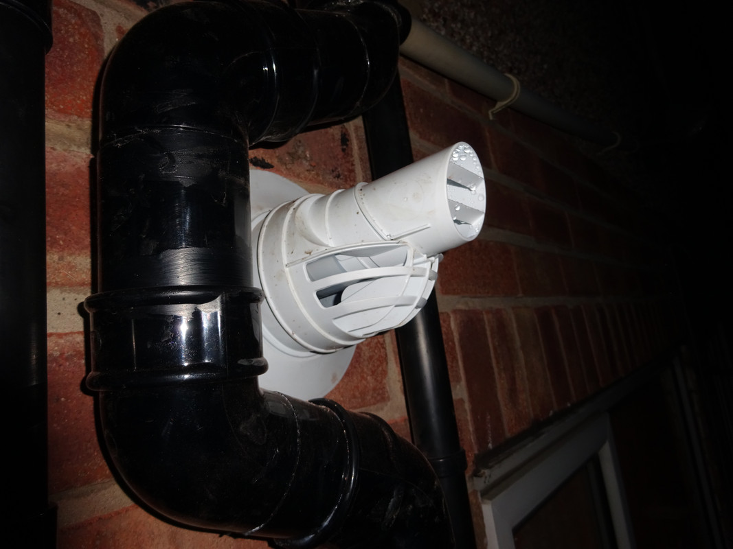

I've just had a new Vaillant boiler installed yesterday to replace a 30+ year old Glowworm boiler and I'm wondering if anyone could comment on the placement of the flue.
Did he make you aware before hand that the boiler should be moved ideally?
The old boiler had one of those square steel flues which came out under the car port which had a hole cut around it.
The old boiler needed a part replacing which another gas safe worker botched, so we got another who came to assess. He said we would either need to cut a larger hole in the carport for the flue because it was less than 300mm, or get a new boiler and have the flue come out the other wall and with a plume kit if it was too close to the window opening.
We chose the latter because we didn't want to have to chop up the carport for such an old boiler that was probably on it's last legs anyway.
It isn’t right but currently you do not have a plume kit attached.
Most likely, that’s the best/ only place it can terminate.
But the fall pipe and waste need moving to 150mm and it can be done a lot neater than that.

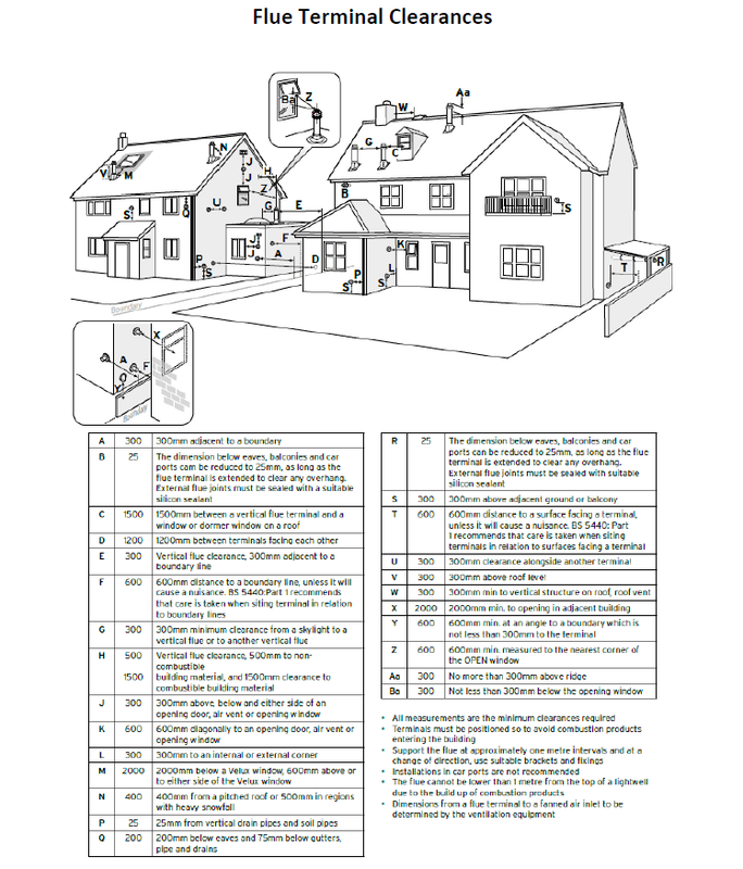

To be fair Vaillant have two diagrams. Ones which come with the book and then another one they have from somewhere! If you ring technical they will give you the diagram attached - had the same issue with a vertical flue and a CF on a roof (Distance apart). Book diagram doesn't show distances from everything. Rung technical and they quoted same diagram. Apparently you can download it off the Vaillant website in some section.
Even if the 75mm gap is correct, the flue is still too close to the pipework directly above.
I've emailed back Vaillant with the picture of the flue and will see what they say.
Thanks everyone for your contributions. I'll report back with my findings.
I have received another email from Vaillant with the following email.

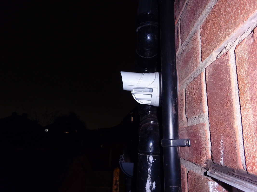

Here is a closer image of the flue. (Forgive the poor lighting, I just got back from work)

From the look of your flue he has altered all the pipes to facilitate the fitting of the flue there looks like he has gone to a lot of messing about to make sure he could get flue in a safe place, just ask him to alter the pipes again to make the install conform to regs,
Yes alter the rain water at the top, it will look a lot better that way as well.
Get the plumber to do it for you, he should have priced it in and it’s his job to fit to manufactures instructions.
You still won’t get the required clearance but it will look a lot neater
There are some right rough gits out there anything to get a boiler on the wall.
Get the origion plume kit fitted. I’m sure clearances are reduced to 25mm then.
