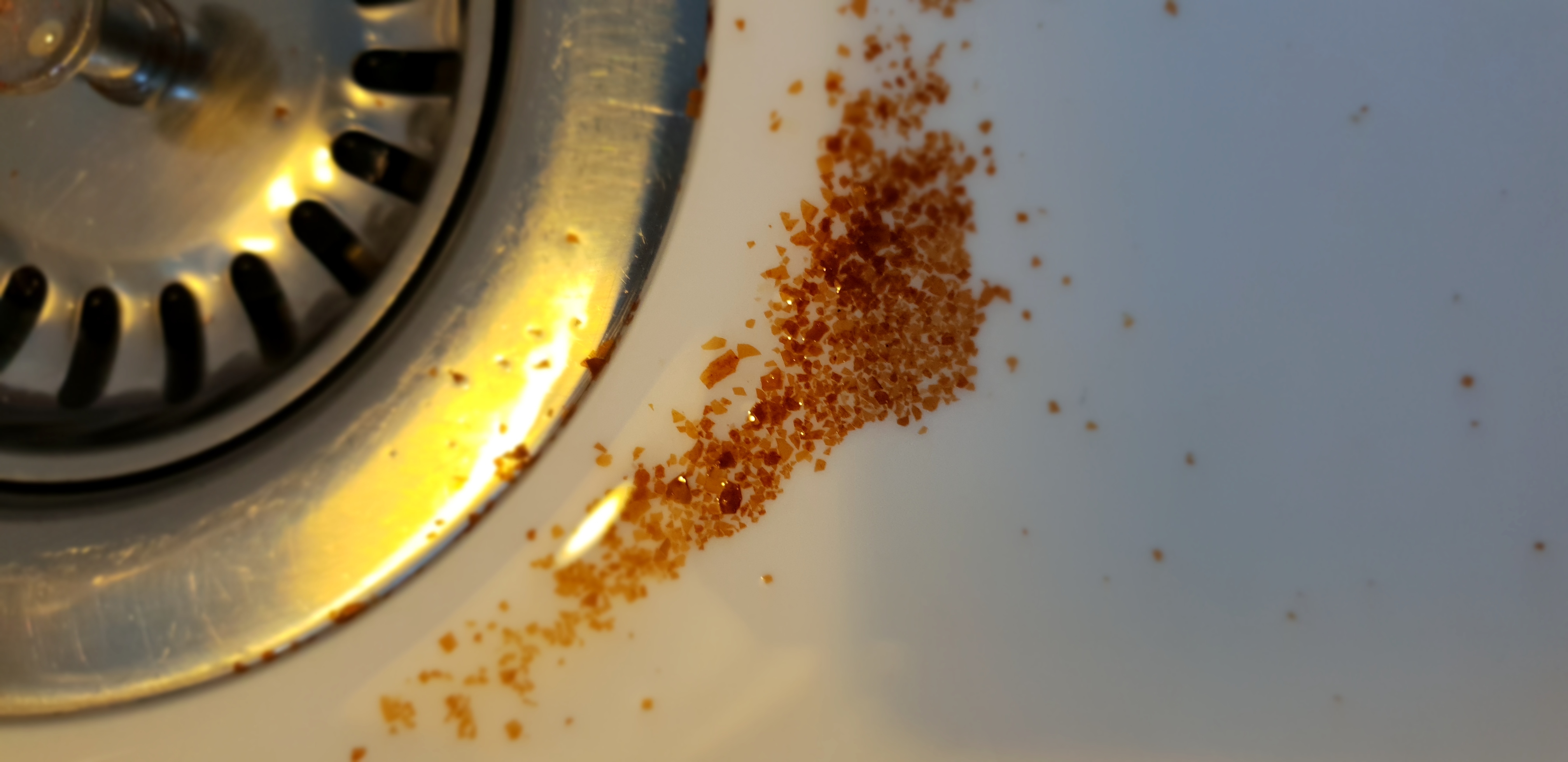

I know these boilers don't have a good reputation but it's been reliable.
I have a hot water contamination that only ever appears on the hot tap noticing it in all the hot water outlets (collecting in mixer tap filters).
On a soft water feed.
The flakes are non conductive and didn't desolve in limescale remover.
It's flakey and brown/orange.
I can electrically isolate the boiler and run the hot tap and no contamination occurs so hot temp related maybe ?
Boiler has been in 4 years and recently serviced running like a new boiler.
Asked a few heating engineers and shown the flakes and none has identified or seen it before.
The boiler is under guarantee but I have lost the commissioning sheet and they have told me that if the fault isn't the boiler I will be charged £300.
Before I take the risk of being charged £300 wondering if anyone can help or has any idea ?
Picture attached

I'm wondering whether they are pieces of plastic rather than mineral. The picture makes the crystals look as though a thin flat sheet of the material has broken up. Is this what they look like in real life?
Well only ever see them on the hot tap.
When I switch the boiler off they don't appear from the hot tap.
That picture is maybe a few weeks build up from the kitchen tap (trapped by the filter).
I've had theories it's a coating off maybe a pipe or like a plastic washer stuck, but then it only appears from the hot tap when boiler is switched on.
UPDATE.
Put some of the contamination in sulphamic acid and 2-3 minutes it was fizzying and fully dissolved.
So it's limescale.
Very annoying really as I'm with Northumberland water and it says on a soft water supply.
I've done a test and it's 140ppm which is slightly hard.

The colour still isn't really how I expect limescale to look.
Feb or Jan rob ?
The colour itself wasn't odd imo, you can get quite dark brown limescale, it was the translucence which was unusual for limescale, but I suppose depending on how and on what it forms can affect this.

I have had our 1st board meeting of 2019. I showed your picture of the debris and its explaination to the designer of the Modena ....he catergorically rules out anything from his boiler and stated contamination in the hot water supply pipe. Hope this helps
