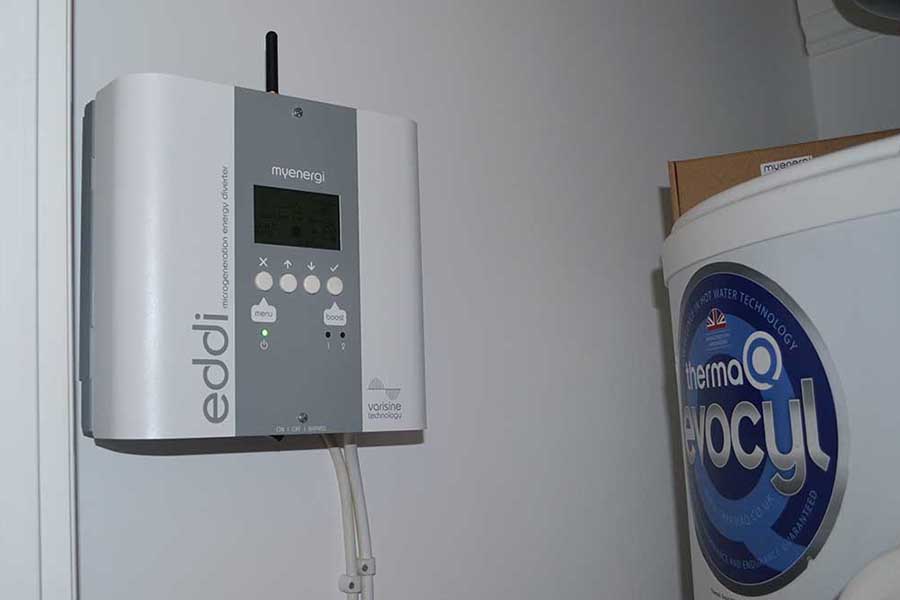

The other option would be thermodynamics to heat the hot water and PV to back it up and produce electricity to run the system it can have battery backup? or feed back into the grid for payback plenty of info on YouTube. Kop
