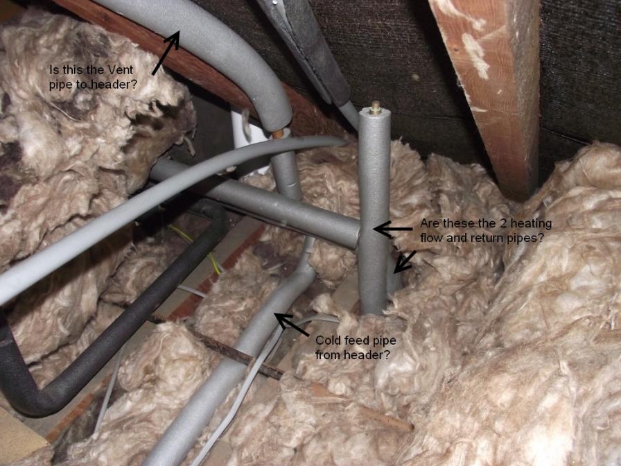

here are pics of the pipe work in the loft, if you need any more pics let me know as I have tried to get the best pics I can.
it appears there is some kind of automatic bleed valve I guess standing up, however this appears to be on the return pipe and not the feed pipe.
there are 2 pipes Tee'd off the hot pipe, one goes up and one goes down, they are Tee'd off next to each other, the one that goes down goes to the bottom of the header tank, and the one that goes up goes to the top of the header tank (i think thats how I remember it, I should have tanke a pad and pen and drawn the lay out with notes if I am honest... ill go back up later)
See if I have fathomed these out correctly Pipes.jpg Hopefully you can make out the labelling I've wrote.:)
If there's a separate feed and vent, which sounds like thats what you're describing, it could be possible to fit an air separator on the heating flow and combine the feed and vent pipes to overcome any possibility of your issue being 'air'. Take this as just a suggestion though as without first hand knowledge I wouldn't commit to it being a cure! Combining the feed and vent will certainly alleviate the possibility of air being drawn in or 'surging' occurring :)
yep that looks to be right, with the return having some kind of filler / bleed fitted? (the tops screwed on tight, I moved it with some pliers but it started to weep a drop so I chickedned out and did it back up)
If the pipes are as I'v perceived then the vent and feed are decently placed and the vent should dicipate any air before getting close to the pump! However as said before, a combined f&v would eliminate any 'drawing in' issues!
IF your cold feed is blocked then you could have air drawn down the vent! I'll emphasise IF!
Seeing the layout in the loft though I'd be back down stairs wondering WTF!!!! lol
The feed is working as when I added the fernox to the system I bailed out header then opened a bleed valve to dran some more out and the level was dropping,
