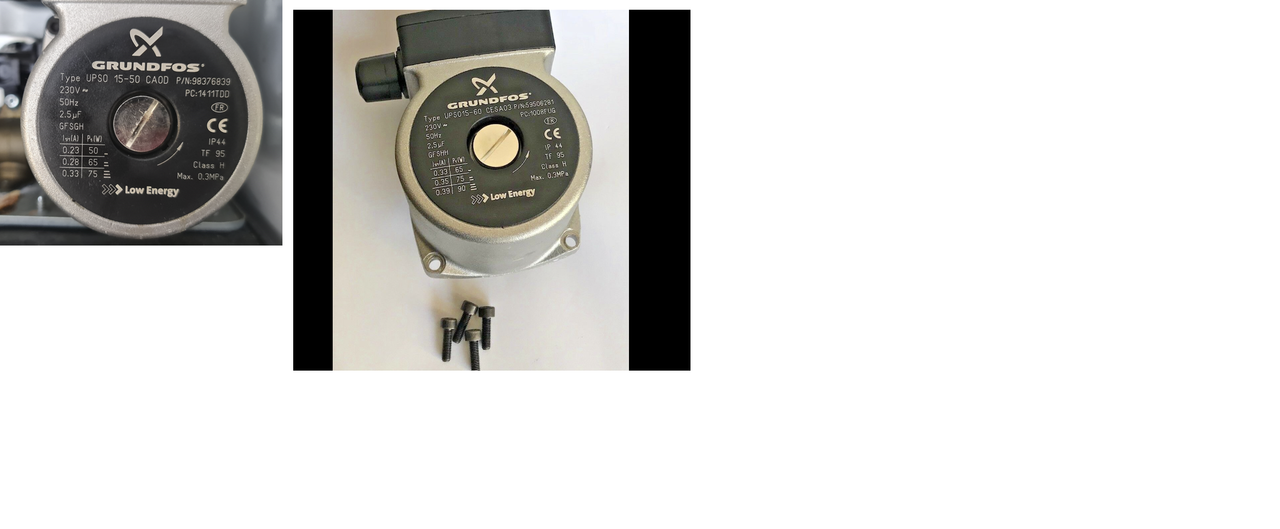

Guys so plumber said pump needs replacement, I found one from ebay it says compatible
My pump
Grundfos UPS0 15-50 PN 98376839
Ebay
Groundfos
UPS0 15-60 PN 59506281
Power and all specs are the same
I have other vendors confirmed even bosch one would work. What you think, price from ebay is very good
I don't think buying cheap 'compatible' boiler parts from eBay is a good idea. Only genuine manufacturer-approved parts should be used inside a boiler IMO.
Well there is not stock anymore for specific boiler model I have and this one was confirmed by boilerparts.co.uk
"Only genuine manufacturer-approved" aren't they from the same manufacturer?
What’s the boiler ?
Ouch cheap boilers are always expensive on parts, if pump failure has been diagnosed then it needs replacing I'm afraid , truthfully it should be carried out by a GSI the casing forms part of the room sealing from products of combustion,
Once the pump is replaced refilled and vented the whole boiler and it's safety devices need testing and a flue gas analysis done 👍. Kop
