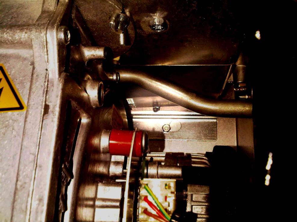

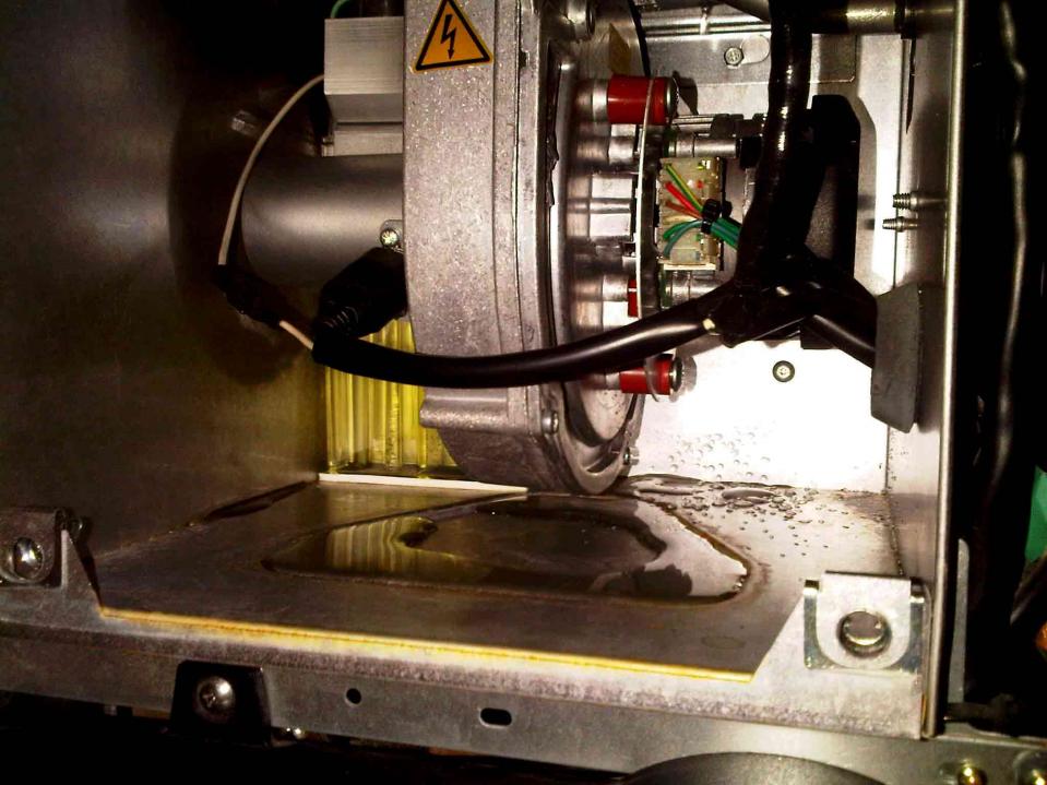

I have a Baxi 133 HE Plus, it is leaking from the rear of the combustion chamber, behind the fan. Dripping to the bottom plate and then dripping to the front of the panel, where all controls are (Advanced Control PCB). I've had to resort to having a permanent cloth on the bottom plate to absord the water before it drips on the control panel.
The leak occurs when the heating is on AND the hot water is running. At times, it just leaks with the heating on. When heating is off, there is no leak. When hot water is running (without heating on) there is no leak.
Can anyone please help, I had a plumber (CORGI reg) check this and he too was confused and could not provide me with any resolution. I had to pay the full hour rate, without any fix or ideas of what can be done. Expensive.
First image illustrates the puddle of water, and second image the drip from above. Hope these images provide better understanding.

Hi, I forgot that you could add images, attached a couple and it illustrates the same description as written, hope this helps to provide better understanding. you may be able to see the splashes from above, and the drip in the 2nd image.
have your engineer check the sump seal and flue seal, is it possible water is getting down the air intake of the flue or condensate water is getting into the air intake.
View attachment 1523View attachment 1524
that conden bottles full,no fly by wire by the look of it,blocked or frozen pipework ,is this a new problem come about with the change in whether ?

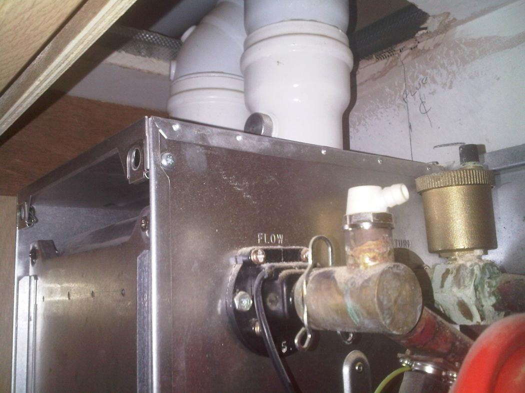

One last note, the boiler has 2 flues situated at the top of the boiler, please can you confirm if the boiler suggested is compatible with this sort of fitting (2 flues).
Boiler images with the flues (x2);
